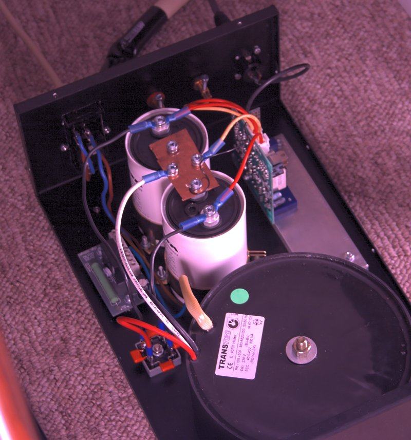

Hi.
After having a pair of UcD400AD laying around for months I finally managed to find time to assemble one monoblock. I completed the first one because I wanted to hear it of course -- now I just need to find a day to build the other one 🙂
Having only one channel so far I can't/won't comment on the sound quality yet, but the channel I have so far has abolutely no audible noise or other things that should not be there.
Components:
LC Audio soft start module
TransTEC 800VA 40-0-40 V potted transformer
Regular 35A rectifier bridge with 4 100nF/250V soldered to it
RIFA 22000uF/100V beer-can sized caps 🙂
UcD400AD module
By the way: How the f... do I solder the wires from the UcD module to the speaker terminals. No matter how long I heat them the solder wont bond. (That's why you see two ugly screws holding wires in the speaker-terminals)
Photo attached. Sorry for the weird purple lighting. The photos are shot in the evening and only lit by two 7W energy saving bulbs that seem to emit a weird light when cold.

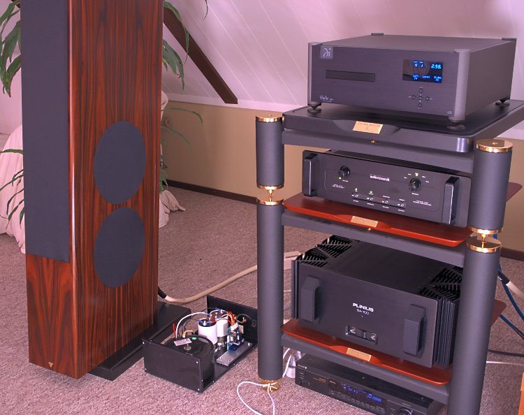

Context
Another photo of the lonely monoblock. This time showing the hardware it is connected to (dont worry, I tested the amp first with an old cheap bookshelf speaker 🙂.
Still the image quality problem: I fiddled with the white balance adjustment etc. but the sick purple light just wont to away completely. Besides that the photo seems nice and sharp.
By the way: Isn't there an LED on the UcD400 module? I dont see anything lighting up, and still it plays like it is supposed to.
Damn I'm looking forward to having completed the other channel also 🙂
Given the flexibility of monoblocks, what is preferrable: Close-to-speaker placement with short speakerwires and longer (balanced) interconnect or longer speakerwires and short interconnect?
