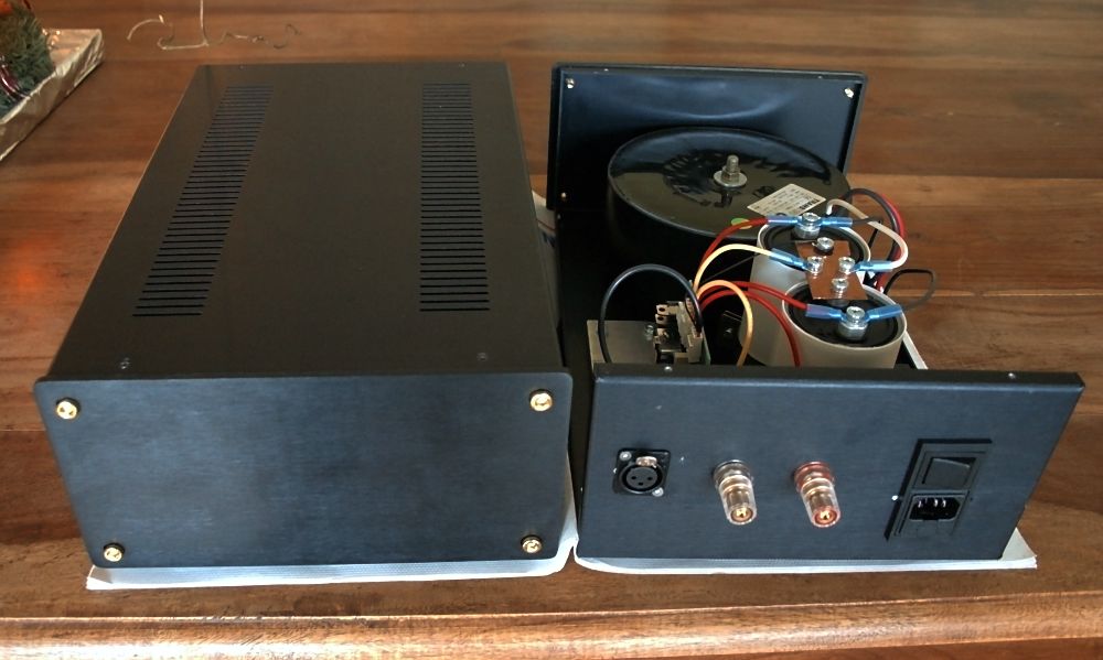

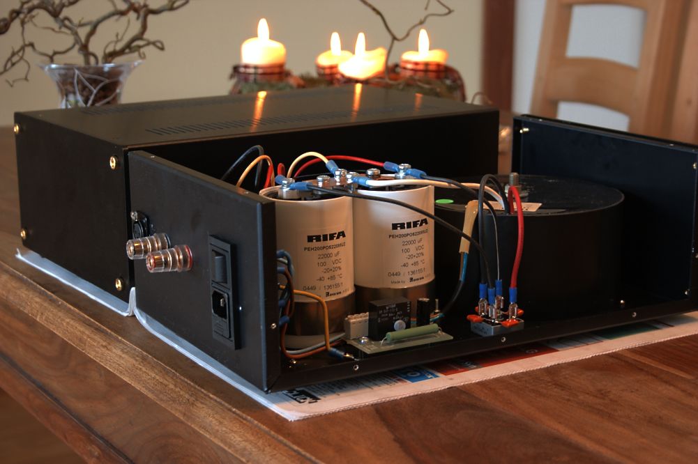

Hi again. I just made it before New Year's Eve so they could get a good break-in that night ;-)
This is my first electronics DIY project, so any kind of constructive criticism is welcome.
The cases are from http://www.thlaudio.com/ and even though Taiwan is far away it was a trouble-free pleasure to deal with them.
About the sound: It difficult for me to evaluate in absolute terms, but at first the UcDs seemed very tizzy in the upper end with the treble sort of detached from the rest of the soundscape -- at least compared to my Plinius SA-100. That signature fortunately went away after leaving the UcDs playing for a couple of hours.
Now, after playing for a couple of days, the sound it good, very straight-forward with clear mids and firm bass -- and the top end is now integrating with the rest as it is supposed to. The top end is maybe not quite as smooth and easy on the ears compared to the Plinius running in class A mode, but then again, the Plinius has a dark/warm signature to it where the UcDs come across as more neutral. When playing loud it is easy to hear that the UcDs are more powerful. I think I prefer the mids of the UcDs over the slightly recessed mids of the Plinius. With the UcD, voices (both in music and in movies) are easier to understand than with the other amp.

Plinius SA100? Guess you be saving a lot on your energy bill 😉
(I have a SA50)
Nice looking amp btw.
(I have a SA50)
