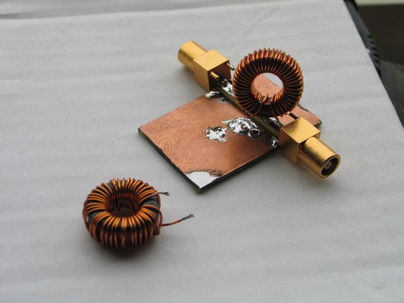

So I took out the coils of my recently defunt AMP3, and had measured
one intact, then disassembled, re-wind using the same piece of wire,
but with Bertus's method, that is, 5 steps forward, one back etc.
Here are the coils, one is on the test fixture:

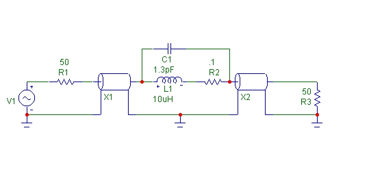

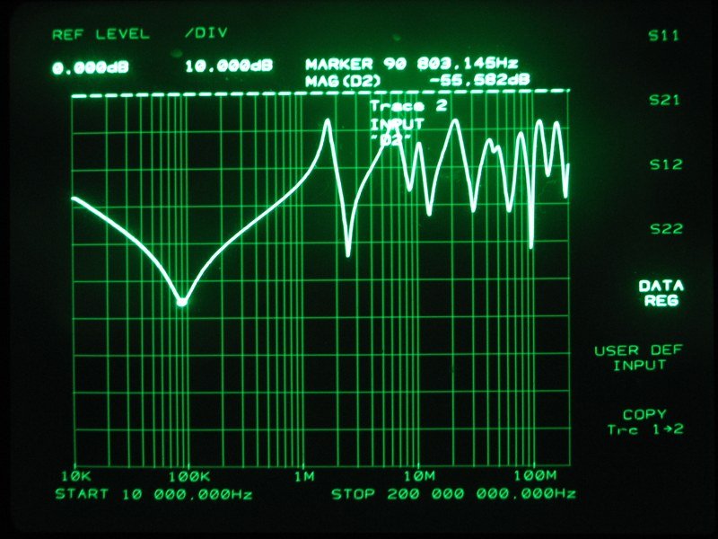

The test setup is like in the pic: the analyzer port1 sweeps the fixture from 100kHz to 200MHz, the coax line is interrupted in the fixture, and the coil is inserted. S21 is measured, that is, on port2 we are looking for the signal transmitted across the coil. As the coil's inductance rise with frequency, there will be an ever increasing attenuation on the output's 50 ohm termination. The parallel parasitic capacitance of the coil will form a resonant tank.
One pic is better than thousand words:

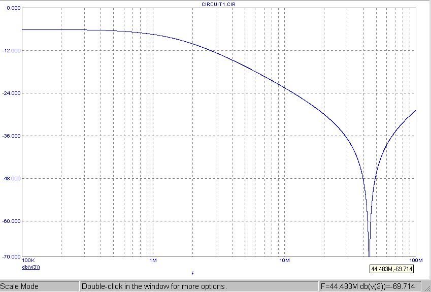

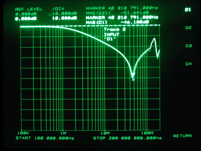

And here it is the measured curve:
The difference is the multiple reasonances with respect to reality. Though the first part coincides well.
The surprise for me was the not so great difference. Even, I would say it's a small difference only... The highlighted curve is the original coil,
the second curve is the "bank winded" one, a la Bertus.
The original resonance point was ~ 45 MHz, with the new coil it had shifted up to 48 MHz. In the sim I get the same shift while going from 1.3 pF to 1.1pF..
