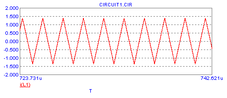

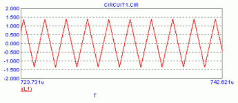

It is not difficult to calculate pp amplitude but you can put it more quickly in PSpice and simulate it.
Attached the result of the current through a 11 uH inductor at 60V_pp at 500 kHz. It is about 2.8 A_pp. It will halve at 1 Mhz and double at 250 kHz.
Btw the Micrometals Txx-2 cores have a mu_r of 10. That is pretty low (10 times the mu_r of air) and already suitable for RF up to 40 MHz according to Micrometals. That is quite different than the calculation Thomas did with the 160 mu_r cores.

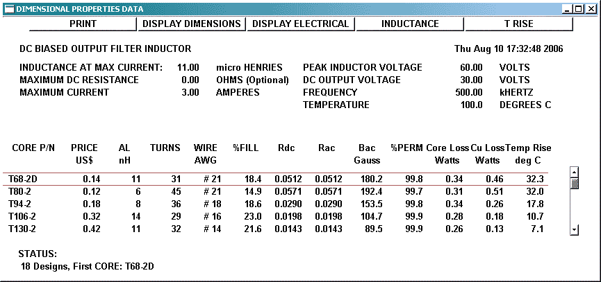

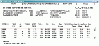

Micrometals has also design software for their cores. Attached the results for Txx-2 cores designed for a single layer winding. The total core losses differ not much for the different core diameters. Although AC inductance lowers for bigger cores, this is counteracted by the larger core volume regarding core losses.
Unfortunately it does not calculate copper AC resistance at the frequency of interest ??? So copper losses due to AC ripple current is not accurate, if they were taken into account at all.

Pjotr said:Micrometals has also design software for their cores. Attached the results for Txx-2 cores designed for a single layer winding. The total core losses differ not much for the different core diameters. Although AC inductance lowers for bigger cores, this is counteracted by the larger core volume regarding core losses.

So I want to try Molypermalloy cores. Micrometal's SW gets no results selecting this material while Magnetics' one has many. The problem is that in their data input are required fields I don't understand:
10A and 1000khz are taken from Tripath's datasheet, while 1.818 ripple current from Micrometals software. With this values Micrometal's SW gets the right cores used by Tripath in their EV boards.
What values for the other fields?

Hi Thomas,
Current density means the number of amps per unit area of copper wire. This defines the heating of the copper at DC (or low frequencies where skin-effect in negligible), it depends on the cooling by air flow. For 50/60Hz transformers it is between 2.5 and 5 A/mm2 for HF toroids as used in this application you can safely take between 10 and 20 A/mm2 ( --> 1000 - 2000 A/cm2). It sets the wire diameter at the specified DC current and allowed temperature rise.
The No Load L is the inductance at 0 A DC. At higher DC current the value of L lowers somewhat and the “No Load L” and the “Full Load L” set the boundaries you will tolerate, The effect of inductance variation due to DC current is lowest with the cores with lowest mu_r because the mu_r goes more to that of air. For high frequencies in the MHz range you will need anyway low mu_r, 160 is much to high. But play around with it and see what the core losses do.
“Temperature rise” is the rise temperature you will tolerate and will select the smallest core that can be used for that temp rise.
