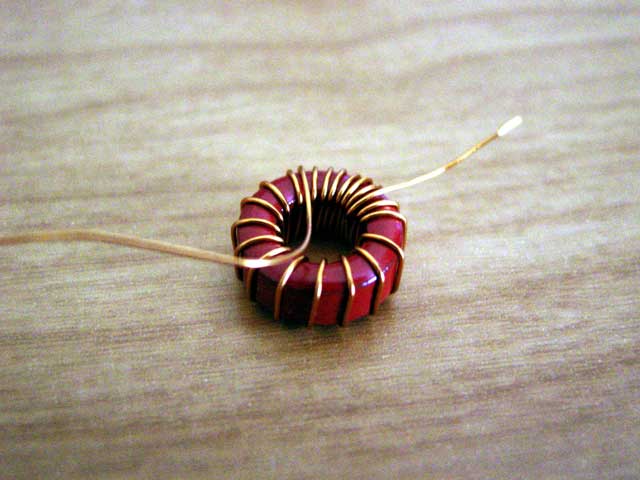

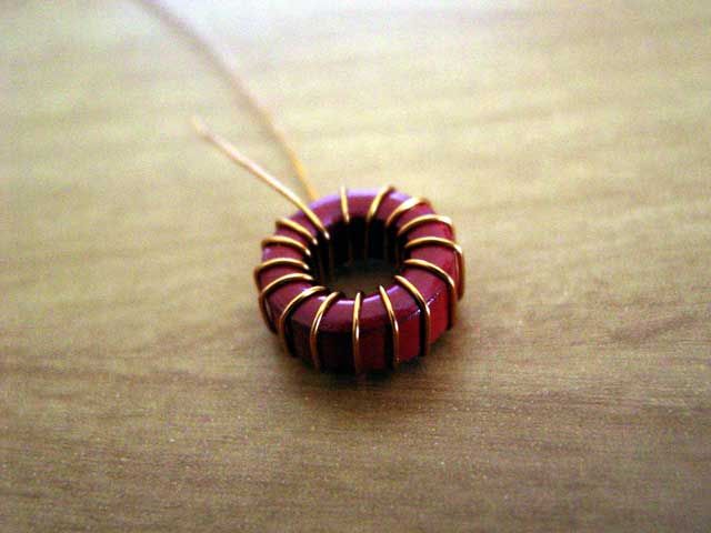

Ok, here's how to use the mobius winding technique.
Wind the wire the whole way around the core keeping the turns spaced apart by at least a wire width. Spacing will also depend on what final inductance value you're trying to achieve. Tighter spacing for higher inductance.
It's easy to make tight winds with 0.5mm wire 🙂 Just takes a little more brute force with 1mm wire.

Hi Bert,
what do you think about moebius banking technique? Is it worth trying?
I have 2 pair of T106-2 bare toroids left, these are used in 41hz AMP2 using Tripath TK2350 chip with 29 turns of 1mm wire to get 11uH.
As bigger toroids and ticker wire seem to get better sonic results i would try these on AMP5: one couple with evenly distributed windings, the other with your technique.
There would be no difference if it were only a matter of dimensions.
Is it correct to wind "on top of" the turns # 5, 10, 15, 20, 25?

Coil winding for reduced capacitance
Sorry guys but I can't let this go. A single layer winding will be like having a very small cap between each winding. Since they all appear to be in series the actual overall value is very small. Now take the case where you space the windings out and put a second layer between the first round of wires. In this case the capacitance is connected from the input to ½ way down the core now multiply this times the number of turns and you will see probably several times increased effective capacitance. An impedance sweep vrs. frequency would show a much lower frequency point of the part going capacitive. Granted the number of effective capacitors has been cut in ½ but each sees way more signal voltage increasing its effect dramatically. Let’s say there were 20 turns total. This means each capacitor in a straight wound unit would see 1/20th of the signal now do the double wind trick and each cap sees ½ the total signal or 10 times more. So even though there are ½ the total number of effective caps they each are 10 times as effective. So the effective capacitance is 5 times as much in this example.

Thank you for clearing that up Roger. You'll actually have the same number of parasitic caps with either method of winding and the amount of parasitic capacitance between adjacent windings will largely be the same as well (because the geometry between windings is basically the same if theyre evenly spaced). However, as you stated the parasitic capacitances of the mobius wound toroid will store a lot more energy due to the higher voltage across the parasitic capacitances (U = 0.5*C*V^2).
For a normally wound core with 8 turns, you'd have 8 total parasitic caps (7 adjacent windings and 1 start/end winding). The energy stored in the parasitic capacitance of each adjacent winding would be U = 0.5*C*(V/7)^2 = 0.01*C*V^2
Assuming the start/end windings are similarly spaced the stored energy in that parasitic capacitance would just be U = 0.5*C*V^2
For a mobius wound core with 8 turns, you'd still have 8 total parasitic caps (7 adjacent windings and 1 start/end winding) but the voltage differential between the adjacent windings is higher. The energy stored in the parasitic capacitance of each adjacent winding is a little more complicated. Three of the parasitic capacitances would would have U = 0.5*C*((3/7)V)^2 = 0.1*C*V^2, four of them would have U = 0.5*C*((4/7)V)^2 = 0.16*C*V^2, and the start/end winding would still have U = 0.5*C*V^2
From this you can easily see how more stored energy the same amount of capacitance will have with the mobius winding technique. Looks like I'll still be sticking with the normal winding technique!

Inductor winding stuff.
Brian,
Thanks for putting some numbers to it. I knew that my second drawing shows only ½ the caps but they are actually twice the value (active on both sides of the wires) so it works out the same.
There is also the fact that the formed resonate circuits will have a much lower frequency in the second example as the caps are larger and the enclosed inductance is far larger. This might be the most important part, defining at what frequency the inductor becomes capacitively reactive and starts lowering in impedance. This could be greatly different between the 2 examples and could potentially cause an EMI problem at the higher frequencies by giving the noise a clearer path out.

"It's easy to make tight winds with 0.5mm wire Just takes a little more brute force with 1mm wire."
As a point of interest, you might like to know that doubling the diameter increases the bending stiffness 8X.

What I am missing in this discussion is the value of the Q of the inductor. A lower Q means more losses! To raise Q and make it less dependant of frequency you'll need winding techniques that minimises proximity effect, that is minimizing direct magnetic inter winding coupling.
The mobius winding technique is one of them but what I remember from college is that this technique consist of placing one or two turns along the whole width of the coil and going back and forth the width of the coil each next turn: Like the way self supporting HF coils are wound, giving the coil a “braided” appearance. A step further to improve Q is the way honeycomb coils are wound. But I see no way to accomplish this on a toroide ferrite former.
Still the best way to wound optimum toriode coils is to use a large enough toroide to wound one single layer with evenly spaced turns along the full circumference and with some airspace between each turn. And to raise Q further you will need litze wire too.
I did wound power filter chokes with high ripple current on MPP cores. The difference in generated heat at 100 kHz between 25 x 0.2 mm litze and plain 1 mm round wire was dramatic.
