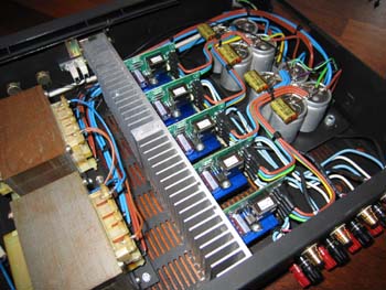

My UcD180
Here's my story.
I needed a more powerfull amplifier for my 5.1 setup.
I decided to go for a test with the Hypex UcD180 after reading the Q&A on this web site (pheev, what a threat). I started with 2 ch. STD modules.
This test lasted about a week - then I had the verdict, I was going for the 5 channels. Meanwhile I wanted an "understatement", something cool. I found a worn out NAD 2100 and took it apart. That enclosure would give me the wanted look and WAF.
Attached's the finished amp. The one EI core supplies the FL+FR amps, the other the rest. I'm using full (dual) rectification for maximum stiffness. The FL+FR are using the AD version, the rest the STD version. I haven't implemented DC protection - I like the simplicity in the design. I decided to believe in Hypex electronics - and won't blame JP if one of my modules fails. It's what I consider as a calculated risk.
My conclusion?
It's amazing. No less. It's alive and kicking. It's playing music - and that’s all to my.
For you who are considering - go for it!
Thanks to JP for beeing there on the mail.
/AVR300

Nice piece of worK!
Couldn't have said it better myself!
Roger
Yves Smolders said:@AVR300,
Nice piece of work!
Now twist the power cables 😀
Roger

Smart layout.

It looks as if each section has two capacitors for each rail. You might want to try sticking a 0.2 ohm 20 watt (or thereabouts) resistor between the capacitor closest to the rectifier and the cap closest to the amplifiers. It's a cute trick the Pass amp people have been doing for a while, and it reduces supply ripple by quite a bit. The ripple spectrum is nicer, too.
Francois.

Wow, very neat!
I twisted myself the PS wires that I forgot to twist when I plit my 4ch amp in two. I would lie if I declare a big improvement.
I saw recently a pick of a new amp from Krell with notorious lack of this implementation.

Twisting is usefull when you have a dense cable tree where there are more different channel wires next to each other. In a separate system, monoblocs, I also doubt there will be any sonic improvement.
Doubt there may be, however, the time to twist your PS cables is shorter than the time needed to log on to diyAudio.com and do a single post.
If a possible good tweak is this cheap,why *not* do it?
I won't be putting stones on my amp though 😀

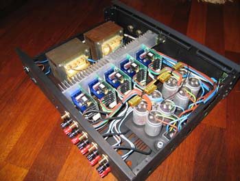

Just attached another picture of the amp. "New Acoustic Dimension powered by UcD" - hmmm
/AVR300
