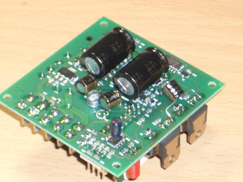

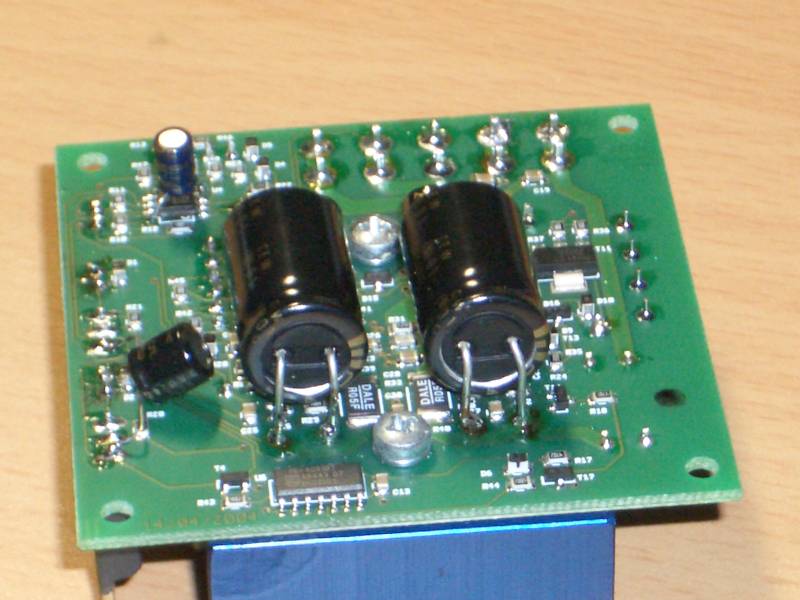

Hi Jan-Peter, Bruno and others,
I have revision one, I already saw that there are no decoupling caps after the regulators (well transistors like emitter followers with a zener defining the base voltage).
I have modified two of my UCD modules. Besides replacing and adding BG caps at different positions I also put decoupling after those regulators. I have put one 22uF 50V BG cap between the + rail and the - rail after the regulator, so not 2 caps to GND but one cap between the + and - rail. Besides that, I have added a 0.1uF BG-NX cap directly over pin 4 and 8 of the NE5532 opamp for decoupling close to the opamp. So I`m not decoupling to GND but between + and - rail. I think that should be OK and I think I read somewhere that that way of decoupling prevents GND noise to be transferred to the rails which could be beneficial? So I have done that mod but no listening yet.
I have also replaced the 22uF caps that are parrallel to the zener diodes with BG types. Replaced the 22uF coupling caps between NE5532 and UCD with 4.7uF BG-N types (this gives a cut-off frequency at 16Hz or so which is far lower than that of my speakers, so no problem). I did not remove the 22uF caps that are power supply decooupling caps close to the switching transistors. I wanted to replace them with 22uF BG caps, but there is not enough space. So I added 22uF BG caps in parallel on the underside of the PCB. I was also thinking of replacing the 470uF caps with 100uF BG caps (about the same size), but instead, I just added 100uF BG caps by mounting those also on the underside of the PCB.
See the attached picture for what I have done to the underside of the PCB.
If you have any comments/advice, please let me know.
I`ll add another picture in a seperate post
Depends on the application
In single-ended (ground-referenced) circuits this can be a good thing, although it reduces the phase margin of the op amp.
In the UcD pre gain stage, ground is not used as a signal reference so the advantage of decoupling only across +/- is gone. The disadvantage (phase margin) remains, however.

Hi Bruno,
Based on this statement in your above post:
You can parallel a ceramic and an elcap if the ESR of the elcap is greater than sqrt(Lcircuit/Cceramic). BG caps have lowish ESR so this requirement is unlikely to be met.
It seems like a bad idea to use BG caps in parallel with the 22uF normal elcaps that also have ceramic chip caps in parallel with them on the underside of the PCB. Is that true? If so, I`d better remove the BG caps at that point.
I had slight worries about the BG caps after the regulators (regulator stability) what do you think about that? Should I get rid off that 22uF cap and leave the 0.1uF that I placed directly over the opamp?
Best regards
Gertjan

Hi Bruno,
Thanks for the advice. I may reconsider this act and place a 22uF after the regulator between + rail and GND and - rail and GND. Using the GND connection that is also used by the zener. Then for the 0.1uF cap directly over the opamp. I don`t see any GND pin/pad in the direct neighborhood of the opamp so that is another reason why I placed that cap directly over pin 4 and 8.
Any advice appreciated.
Best regards
Gertjan
Well in any case if you want to place BGs at the position where the 22uF caps are in the power stage you would do good to remove the original caps first. If you're into placing components on the bottom side, the ideal place to have the "damper cap" is straight across the 100nF caps.
As for the op amp, make your life easy and have only two 22uF elcaps to ground.
