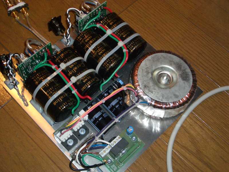

Finally I had a decent test setup for my UcD180 finished (see attachment for a low-res and heavily compressed picture). And tonight I compared the above 3 amps. The power-amp stage of the Accuphase, the Tripath based Marantz and the UcD180 amps. They played on my B&W CDM9NT which is not my prefered system (I prefer my active 3-way), but it is the only way I can compare these 3 amps.
All amps were driven by the DEQX PDC unit without any speaker correction etc. So CD/SACD signal went into the PDC and I used the PDC as a pre-amp. I had all 3 amps switched on and I had 3 pairs of almost identical speaker cables. The Tripath and the UcD had the same cables (ortofon) and the same length (3 meters). The Accuphase also had ortofon cables, similar type but a bit cheaper, so the the cable may play a small role here. Then the UcD180 was hooked up via XLR using a 2m goertz micropurl silver (self assembled). The Marantz and the Accuphase were hooked up via RCA cables (good quality) of about 1m.
The ranking in order of sound quality was: 1. UcD180; 2. Tripath; and 3. Accuphase. The Tripath sounded better than the Accuphase, I knew that already since I had the Tripath (Marantz) already more than a year. However, the UcD180 sounded much better than the Tripath. Comparing these 3 amps, the Tripath seems marginally better than the Accuphase (but clearly noticable) and the UcD180 is a large step ahead of both others. It is really amazing. The UcD180 is very transparant, acoustical music sounded as it did never before. Female vocals are very good. Acoustic guitar is amazing. It is the transparancy, the air, the imaging that directly grabs you. You immediately know you have something special when you hear this amp. Bruno and Jan-Peter, congratulations with this very good amp.
As you can see in the picture. I use a quite solid power supply with 6x10.000uF in total for 2 channels. I`m using a 250W transformer. I don`t know how important those 4 ELNA caps are. they were expensive so they`d better sound good. I don`t know how it would sound without them. The UcD180 modules that I have in this setup are unmodified and not burned in. They sound great from the beginning. I started modifying another pair of UcD180 (using BG caps etc). This will sure take a couple of days too. I`ll compare the modded ones with the unmodded UcD180 as well.
Also I don`t know how big the difference in the cables are. The difference between the Tripath and the UcD180 is only in the interconnect cables (speaker cables exactly the same, even bought at the same time). The Tripath used RCA 1m while the UcD180 used 2m micropurl silver XLR. I need to assemble a couple more micropurl cables anyway for the active 3-way, so then I can feed the Tripath via the same XLR cables and see what happens then. I`ll sure do that. May take a couple of days.
Bottomline: these amps are very good, I was surprised to hear this much music and this much difference on my passive CDM9NTs.

ghemink,
That's an absolutely brilliant and interesting report! Got me thinking maybe I should try more DIY!
Is it possible for me to get a copy of your power supply schematics so I can try to build a similar power supply for a home audio stereo version of the UcD180? BTW is 250W transformer that you use sifficient for the UcD 180? I thought two UcD 180's would consume more power than 250W? Thanks.

Hi Audionutter,
The power supply that I used is the predator power supply that I bought at lcaudio. The soft delay circuit next to the transformer is also from LCaudio. What I added is the 4 big ELNA Cerafine caps, 10.000uF 63V. I`m suspecting that these caps play a role in the good sound that I`m getting. The reason I use only a 250W transformer is because these amps are meant for use with a tweeter and two midranges drivers so I figures that a 250W amp is more than enough to blow up the tweeter and midranges at the same time🙂. Besides that, those power supply caps hold a lot of reserve power. Those two UcD180`s can of course consume more than 250W together, however, who is running a continuos sine wave to run both of them at 180W (4ohm). I guess with a normal music signal that stays below clipping level, this 250W transformer should be more than enough. Please add a bigger one if you feel that is needed.
Best regards
Gertjan
