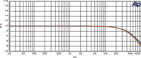

Guys,
Hereby the graph of the UcD180 in 4,8 and no load;
Frequency response is a 1st order low-pass characteristic with a corner frequency of 50kHz and is independent of load.
Jan-Peter
www.hypex.nl
