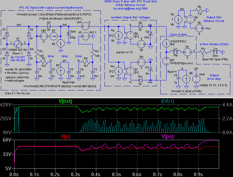

So today I've been playing with an LTspice simulation of a 180 W UcD style class d amplifier with a power factor corrected power supply (with and without voltage balancing on the outputs). 🙂 The pfc front end has been set up with a voltage loop crossover frequency of 17 Hz (with a second pole at 16 Hz), a 16 Hz double pole low pass filter on the rectified ac feedforward squared divisor signal, and a 10 Hz double pole low pass filter on the output current feedforward multiplier signal. Override operating limits are 4 amps on the input current and 400 volts on the output voltage. AC input range for proper operation is 80 to 264 volts and nominal dc output is 375 volts. A 330uF capacitor is used for primary energy storage.
The pfc front end is followed by a simple dc to dc step-down supply for the isolated rail voltages. Its step-down ratio is 0.12, yielding a nominal 45 volts or so for the class d rails. A 10,000uF capacitor is hung on each rail so that total output energy storage is just slightly less than that on the 330uF boost capacitor. The rail voltages are balanced by an auxiliary circuit that can easily be disconnected by setting its series resistance to a high value.
The output load is my guess at an equivalent RLC network for a nominal 4 ohm woofer with a 34 Hz box resonance. For the test run shown, the amp is overdriven with a 15 Hz clipped sinewave burst. Without active balancing the positive rail voltage gets pumped up to a whopping 59 volts at the end of the burst.
An interesting note about the voltage balancing circuit: by designing it with a certain controlled level of impedance, it can avoid having to handle the large reactive currents required to keep the two output capacitors in lock step, yet still nicely squelch the pumping effect. (I intend to cover my ideas on balancing circuits in another post.)
I could post the simulation files here as a zip upon request, or they will probably show up shortly in the files sections of the LTspice or audioexperiment Yahoo Groups.
