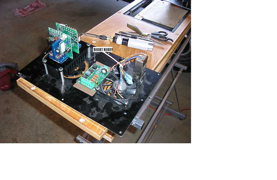

Re: OK, here-goes....................
That is the Marchand XM-1 crossover boards... Very good board. I'm doing some projects with them myself.
I'm using some old XM-1 boards that I have been running in a home unit for over 15 years. Hows that for reliability!.
PS if that is a steel plate you could have skipped the massive heatsink and connected the UcD180 straight on the plate.
cadaverdog said:Steel washers used as standoffs; they tend to cause short circuits.
DUH!!
Yeah..............
I guess I "overengineered" that one.
The modules are internal to the speakers, so the idea is to let in air at the bottom of the plate (via the slots)- and right across the heatsink. The fan draws the air in through said slots.
I have since removed the fan- and simply covered the hole with a grate. After playing the amps for 8 hours straight at full volume, the plates never got a single degree above ambient temp.
