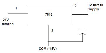

Can I use the -30V obtained by rectifying +/- 21 V as +15V referred to -45V (COM) for the gate drive?
If yes, across which voltages should I put the filter capacitor for this -30V?
Across 0V & -30V or across -45V & -30V?
Thanks.

I hate spoon feeding
You need:
32-0-32 for power
15-0-15 for preamp and you need to regulate it also using 15V regulators
0-15 for IR2110, this also need to be regulated and referenced to -Ve power rail.

You need:
32-0-32 for power
