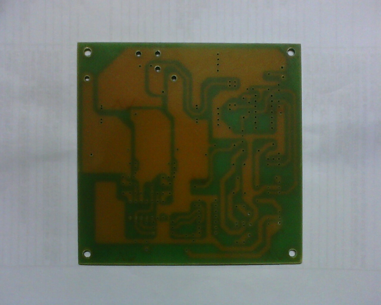

My PCB has been fabricated and has arrived. Pls see picture. Also, I have bought some parts (ICs etc) .That is all as of now.
Will post everything as soon as I finish building.

why oh why didn't you use the the other layer of the board for a ground plane ?
the difference would have been incredible.

It is a single-sided TH board. I shall be trying SMD sometime later. I will be having a completely metallic cabinet which will be grounded and the board screwed to it without much gap.
So is it going to be that bad?Doesnt the metallic cabinet (only few mm from the board), act like a good ground plane?
Hopefully it is not going to be that bad...
but for the next project take this in consideration also.

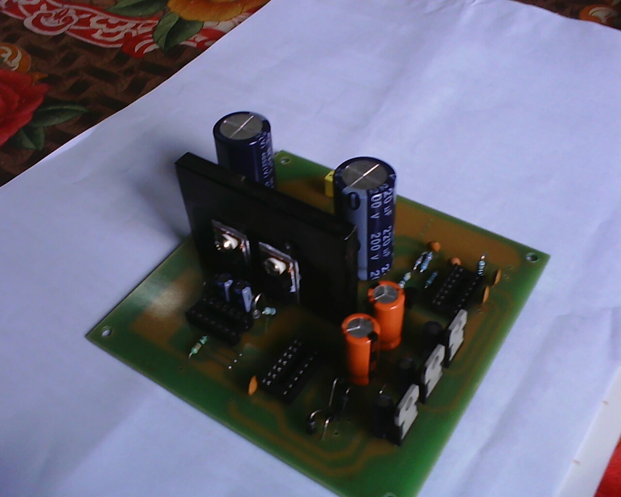

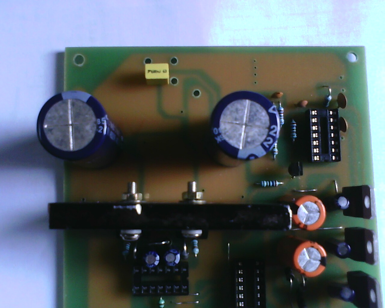

Hi Friends,
I have completed building my amplifier (but for the choke).
Please see the pictures.
I ve a capacitor that says 105K........Is it 1uF ? rating is 250V (got it from the front end of an smps)
Can I put it across +/- rails like the x capacitor in an EMI filter?
