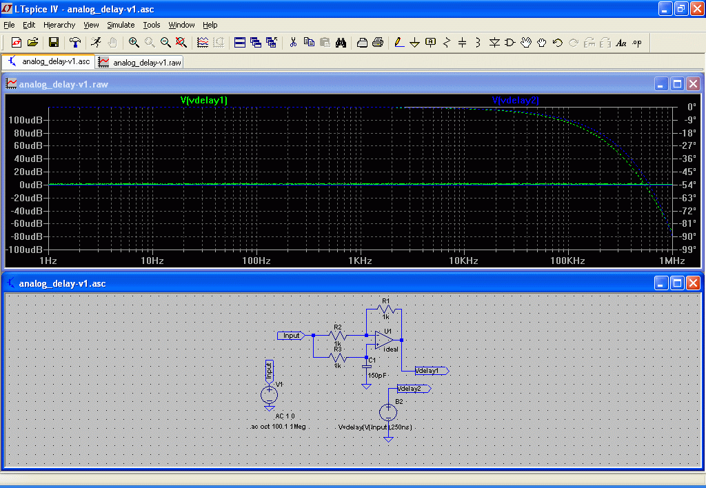

Thanks for the delay circuit. From simulation, your delay is close to a 700ns one.

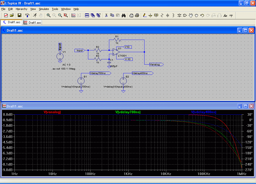

gogo, change 265pf to 200pf or near.
Does this type of modelling (allpass filter) of comparators etc. work well ? Interesting.
If it does then its simply time delay = d/domega [phase (radians)] 🙂

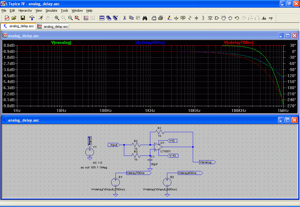

Here it is.
Cheers
ok so its 30pf
ok and 400ns at what freq?

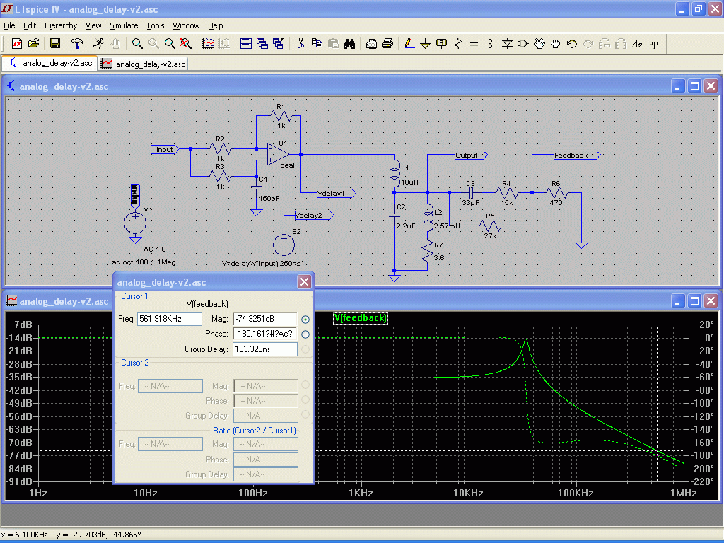

But when i cascade this delay ckt (c=30pf) with LC filter and phase lead n/w, the 180 deg trip-point is above 2 MHz.
But with c=200pf, its 578kHz.....any idea????
let me remind you that i was using an ideal opamp!!!!!!!!🙂
So dont you think that this allpass circuit maybe used to precisely adjust the switching frequency of the UCD ?

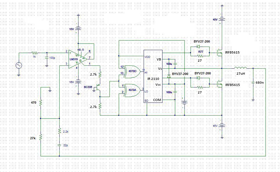

Ok so approx delay of LM319+BC546+IR2110+IRF530= 200-300ns maybe 250 ns.
switching freq = 250 kHz.
So what delay ckt for 250ns?
This is pretty close up to 1MHz.
Thank you gogo!!!!!!!!! 🙂

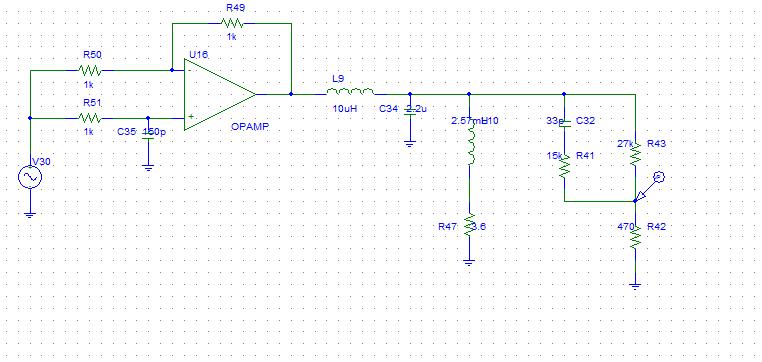

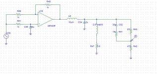

Have a look at my delay model for 250ns and 250kHz.
Will it work?
Will it work?
Will it work?

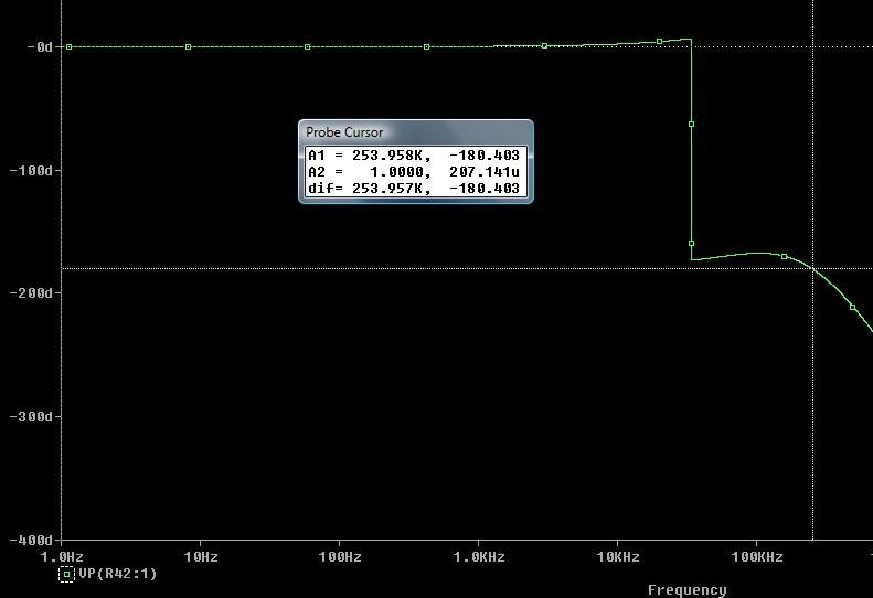

My sim using your model showed oscillation at 560KHz instead.
But here its 250 kHz where the 180 degree trip occurs......why ????
Read the marker named A1

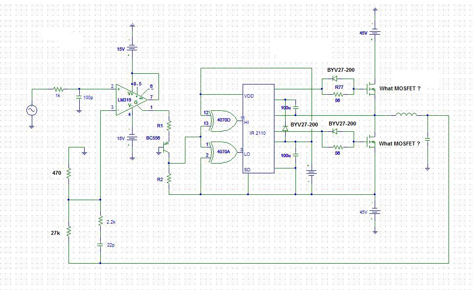

Also, can I use 100V mosfets with +/-45V??? Suggestions please!!
Attached please see my sim output.
For rail voltage, I would have much larger margin when considering mains voltage fluctuation, overshoot and undershoot during switching. Layout is very crucial. You do need a scope. Experiment with lower voltage first and watch the switching wave form.
This thread http://www.diyaudio.com/forums/class-d/116590-ucd-like-topology-amp-14.html#post1823469 post 133 have an example of good layout. I actually built some variants of it with good result.
Edit: You may need a multi-hundred MHz scope for the ringing freq. approach 100MHz with good PCB layout.
Help with MOSFET selection for +/- 45V.
Can i use irf250N?
Will IR2110 be able to drive IRF250N fast enough (at 250kHz)?
Can i use irf250N?
Can i use irf250N?
Check this thread http://www.diyaudio.com/forums/clas...-how-they-try-impose-us-directfet-thrash.html

My schematic and PCB layout attached.
