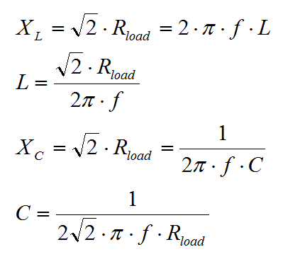

The original 30uH, 1,5uF is for 4 Ohm load, for 1 Ohm load the recalculated filter values are 7,5uH and 7,5uF (for 30kHz corner freq, a good compromise). So it is normal that for that load you need lower inductance value.
Change the switching frequency from 360kHz to about 250kHz. Then you can get out more power.
Attached you will find formulas for butterworth filter calculation.
