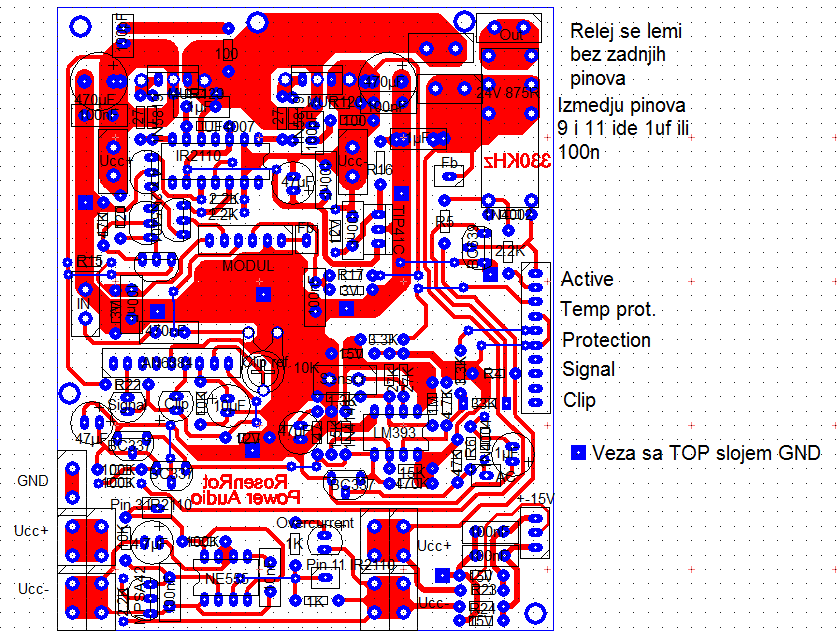

Current layout..not much modified since i got no real feedback(except 1 answer).
I wanted to avoid a long feedback wire that will act as an antenna/inductor(some designs on this forum even have it crossing the switching bus).I can not understand how that could be better since more switching noise will be injected in comparator input...:scratch1:
Jumper wires for protection section and long wires for comparator supply are not o concern in my opinion since i have lots of local bypasing and filtering resistors.

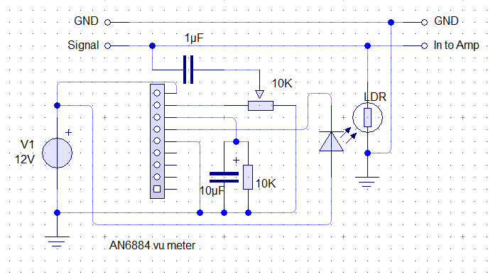

What do you think about this simple limiter that I create?
It use AN6884 vu metar, LDR07 photoresistor and +12V supplay.
Two leds in paralel. One (high lightnes) for LDR and one for front panel of chasis named on example "Limit".
With 10K trimpot on input of AN6884 we can adjust limit level.
Leds are on 5th position of VU meter for easy adjustment.

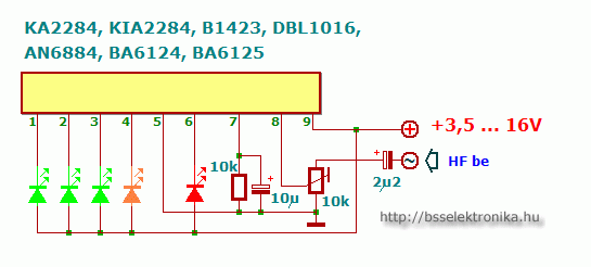

In previous post is schematic and conection diagram. Everything is very simple. And AN6884 conectors are in SIL conection (reactangle is first pin)
Here is schematic of AN6884. There is no need for datasheet because AN6884 is trivial vu meter like LM3914 and LM3915 but with only 5 leds
Trimpot on input is for adjust sensitivity

With my new pcb (double side) noise is almost gone. I still have a noise but very small. I can only hear it when my ear is on twiter. One meter from speaker I cant hear enything. I dont know how but amp start to oscilate when I turn on power supplay every time. I didnt do enything about it.
-Res.freq. is 250KHz, output stage is with 20uH 1uF and IRFB4227 +-80V (2x2KW transformers)
-On aproximetly 250W 4ohms load I don have big distorsion (0.05%). On 1,5KW in full bridge 4 ohm load I didnt measure distorsion but for my ear is clear and good sounding, very powerfull
Honestly, I think that enyone can't hear distorsion with 1KW power with 2x18" subwoofers and 4x15" full range 🙂)))
That's why I dont care a lot for distorsion on big powers. For me more inportant is distorsion on low powers (20-150W) when I play music with frineds or home parties.
Heat is low, I adjust 45-50 deegres C temperature for start temp protection but even on full power in full bridge 4 ohms (2 ohms per chanel) temp protection never starts, bigger problem is distroyed 18" subwoofer Martin Wisman Ref18. I conect two of them in paralel in full bridge and one didnt survive. I think 1.5KW is to high for them 🙂)))))))
I forgot to tel you. I have Volume pot 4.7K, then low noise buffer wit gain 2.5x then amplifier. Input cap to gnd is 4.7n and mids and highs are great.

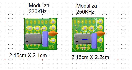

My new pcb has input "modules". single line 6 pin conector. One modul is for 250KHz (old schematic) and one is for 330Khz (Lacy's schematic). I dont have two differents PCB, when I test amp or something else, I only change "modul".
Above NE555 are two 9W resistors for current sens.
-Personaly I dont have osciloskope but I measure distorison with trivial metods, two amps, headphones, resitors, signal generator. And result of 0.05% at 250W and 0.11% at full power is information from my friend who measured amp for me on equipment for that
