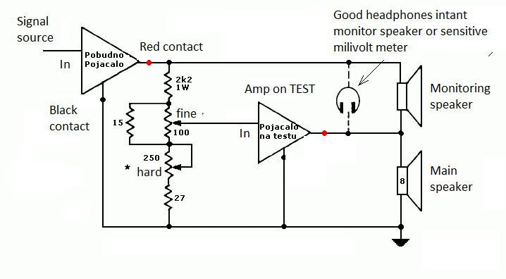

This is very good way to test your amp.
Use this schematic and try it..
Now I will send text and explonation from dr.Borivoje Jagodic, engineer from my contry.
*Sorry for bad english but this text is from google translate and copy-paste from dr. Boras web site 🙂.
"Testing distortions without special equipment"
(HAFLER differential test)
  • Audio THD tester.doc
Ok...but i need someone with good ears to make my distosion tests since i have no distortion analyser.
I can hear different levels of distorsions going from no load to 2, 4 and 8A load especially on frequencies<100hz.
If you have a good sound card, then you can use your computer as signal generator, and also distortion meter. You just need to divide amp output carefully, not to cause any harm!
Even if you have no good soundcard, it will be sure enough to determine the 0,1%, 1% and 10% point.
So far I can say that your unit is going in the wrong way, it has serious switching issues. I reccomend you to try an other ones unit, like dzony's. Me and he also had only minor noise problems, and no distortion problems.

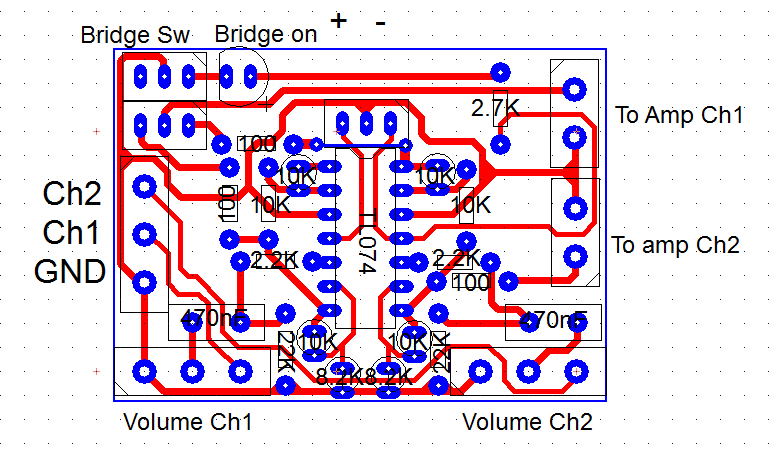

This is my input volume control, input buffer and bridge adapter in one
When Bridge sw is "on" led is on to and Ch1 is "negative" and Ch2 is Positive always.
When Bridge sw is "off" both chanels are "positive" and amp runing stereo
Buffer has gain 2.5x

I can hear my amplifier noise starting from 50 cm to the speaker in a quiet room...it is just like the noise generated from tda7294 with gain 30,but my class AB receiver has much lower noise on minimum volume..only hearable with ear glued to the tweeter and only at night,anyway my internal ear noises are louder so at 1 meter i can hear only them...
Also distorsions are not obvious..i can only detect them with test tones...the noises coming from reflex tubes and resonances in my room are much worse..i just have the craving in finding out how i can lower them...
Decreasing dead time reduces distorsions dramatiacly at <100 hz but 300-400mA idle current is to much for me..
Tl074 is very noisy..try something else...i am using lm833 but are much better opamps out there...
