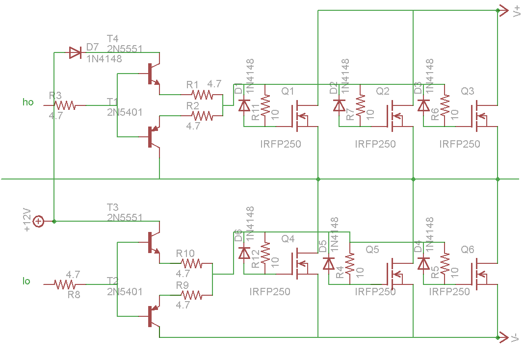

UCD 25 watts to 1200 watts using 2 mosfets
instead of using the tc4420 will this work using bi polar transistors? steve
How to level shift these power drivers as high side? Use ir2110, ir2113 or ir2010 again?
There are several ways of using them. It depends on your idea and need. For eg. a fast optocoupler or you can use them as a driver in UCD amp instead of discrete transistor driver etc. etc. Several ways of creating your own way to reach the aim just think and then experiment your idea. If you find the correct way it works if you did not find, you learned the wrong way that doesn't work!
Regards
Check FAN3228 and FAN3229 gate drivers from Fairchild. They feature differential schmitt-trigger logic inputs making discrete differential level shifters (like the one used internally in IR chips) very easy to implement (with just two high voltage transistors).
Furthermore, propagation delay of these drivers is around 20ns, and maximum idle supply current is around 1mA.
