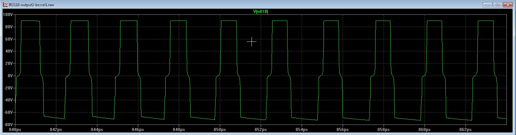

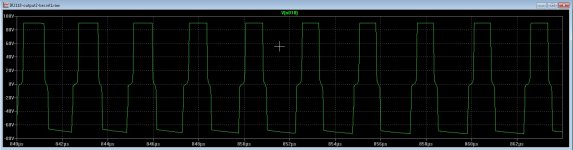

Ohh yes, do you now why the lower mosfet is nog complete switched on with the IR 2011 I think something to do with model from @analogman? I have not yet answer for that.
Also the square signal is not nice, you see to switch to rail in plus side but not on the lwer side, means mosfet is not complete switched on.

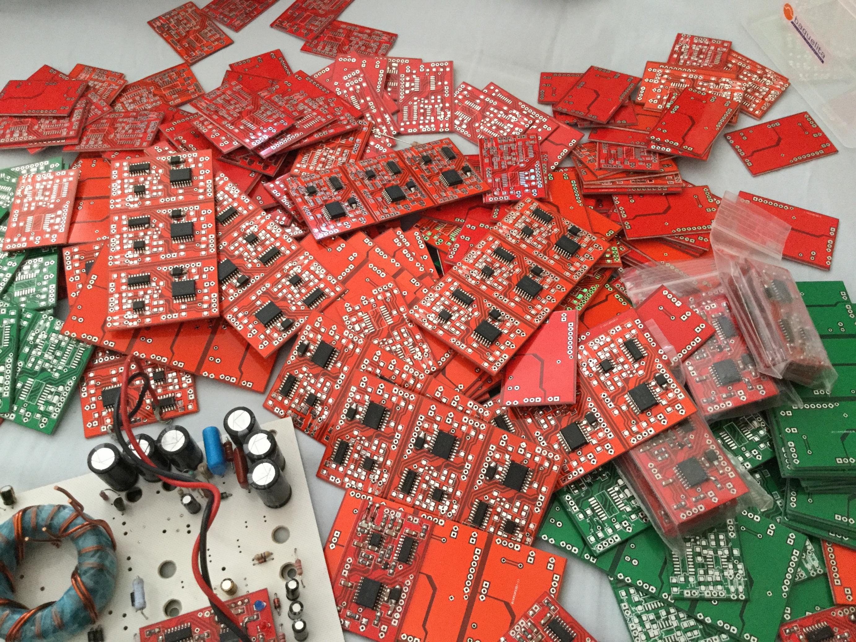

My modulator / demodulator, driver, 450KHZ, zero noise, instead of ir2110, use fan7392 with 4 output amps, two ground planes, referenced to gnd and, - B, MORE than 300 amplifiers in operation.
hi redmx, nice, clean compact control board. is your damp sigma or ucd. please post the schematic you are using. .

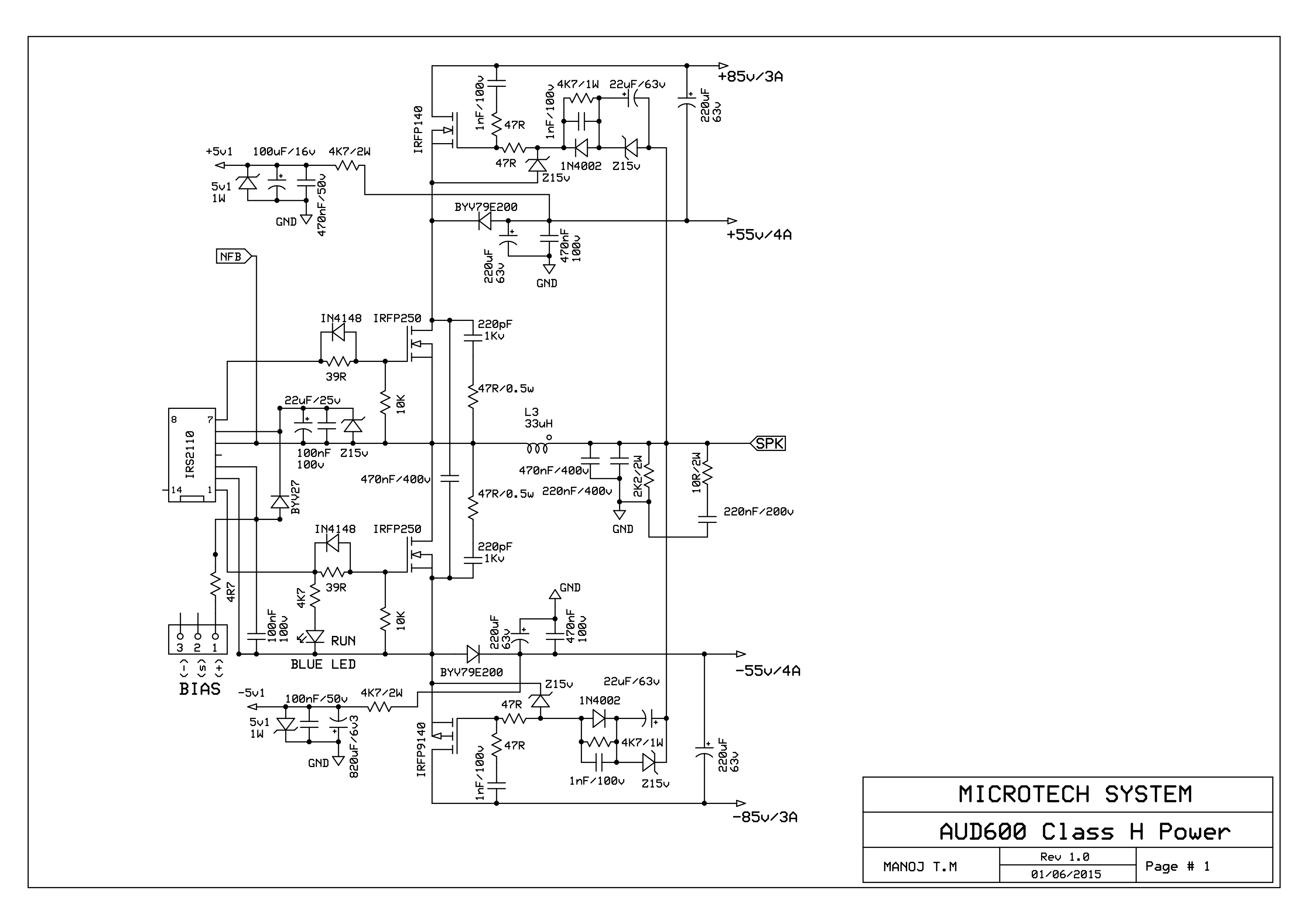

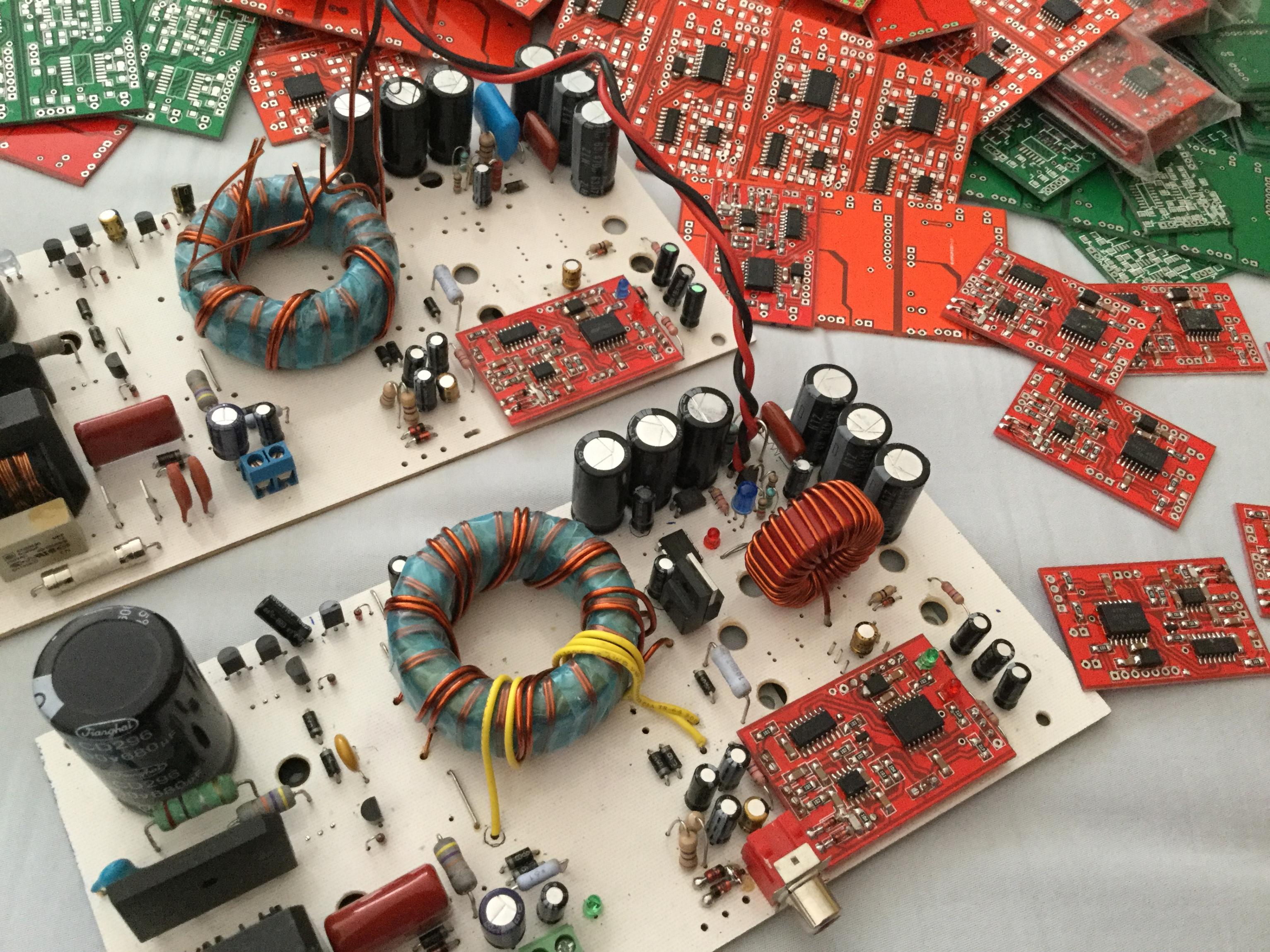

hi all still continuing with the 2step and 3step h pcb ab/h
the class d 200wt using n and p fets is very stable reliable and silent the only downfall is the voltage has to be up to +/-42vlts max which is abt 200wts in 4ohms .🙁 i wanted to add it to class h like manoj style with tlo72 2step and 3step please advice
1. i have mounted multiple d amps of 200wd in one casing without issues of noise and cross conduction.
2. less heat than ab amp
3. can handle lower impedance stably
4. d amp is price friendly

Hi Stewin,
Just asking, why do you need stepper for class D.
Stepper is usually used to avoid linear drop losses because of Vce of Vds voltage. In class D, Vds is almost zero.
From my point of view, I don't see any benefit. You can find easily 150V, 200V, 250V, 300V mosfet. If not enough power still you can go with easier way: fullbridge or BTL.
o.k thanks katrino for reply ,but what core to use for high voltage and also noise issues not forgetting stability issues??
Core use 2x MS157060. High volt is high amp means bigger core.
No issue on stability and noise.
BTW we all go for fullbridge.
90Vdc supply can have plenty power. Real power.
Yes..... In Indonesia, We all go for Fullbridge or BTL. 😀😀😀😀

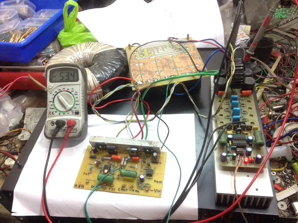

fullbridge pcbHello. I wanted your help to understand. I did the test of my class amp d. I measure the temperature of the heatsink. Psu + -70v output amplifier loaded by resistive dummy load. 8ohm 56 ° after one hour. 4 ohm 85 ° after half an hour and protection cuts. The test is done with hard rock music at clipping. is it normal. Now I do not have the speaker that support this power to test in real load. Do the speaker require less power. Help me please to understand if this temperature is normal. With 6 ohm after one hour 65 °

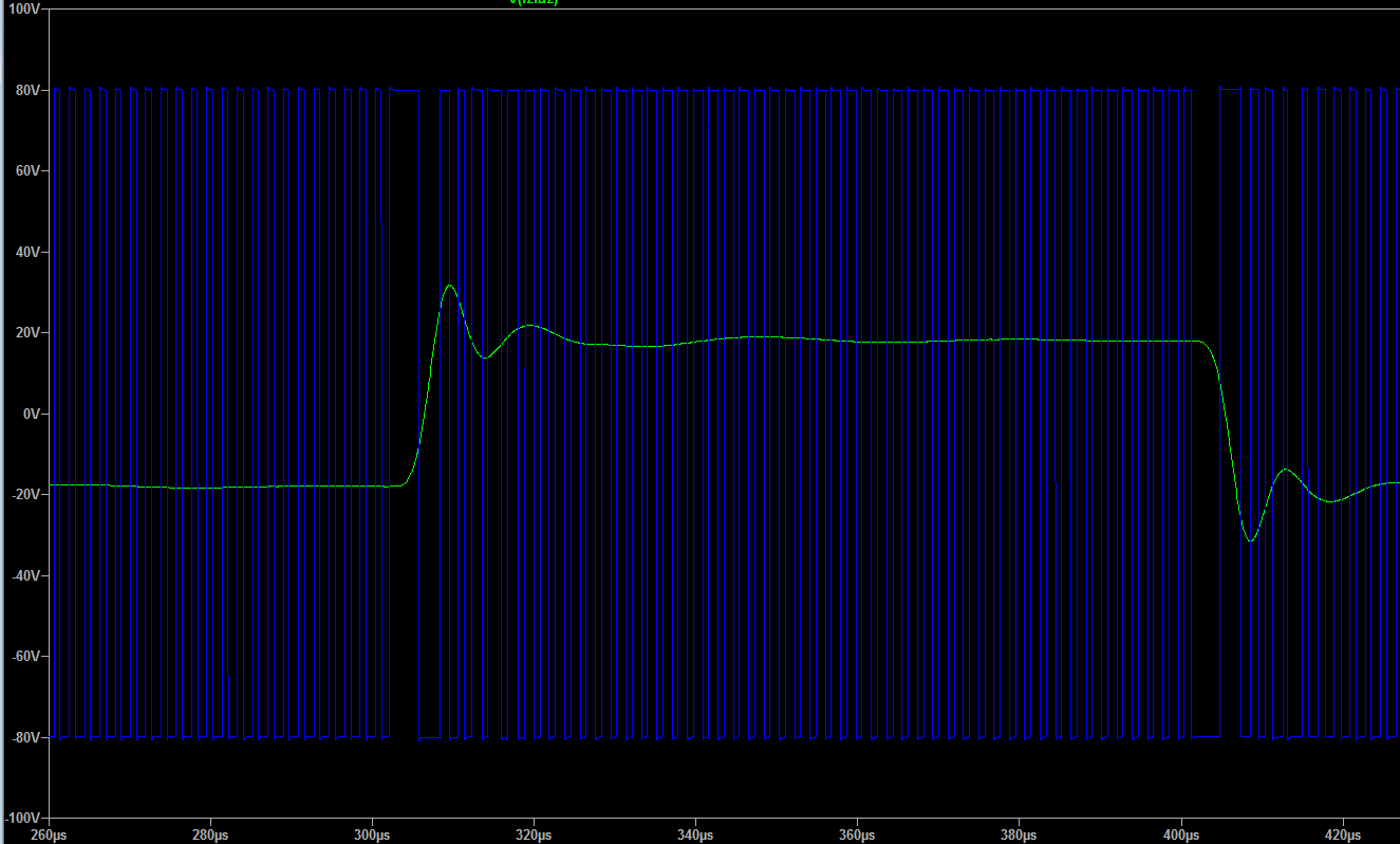

I just tried this feedback in general D class setup (generic) ideal switches and fixed deadtime..
Seems not stable,
square wave input, graph shows pwm section and output
