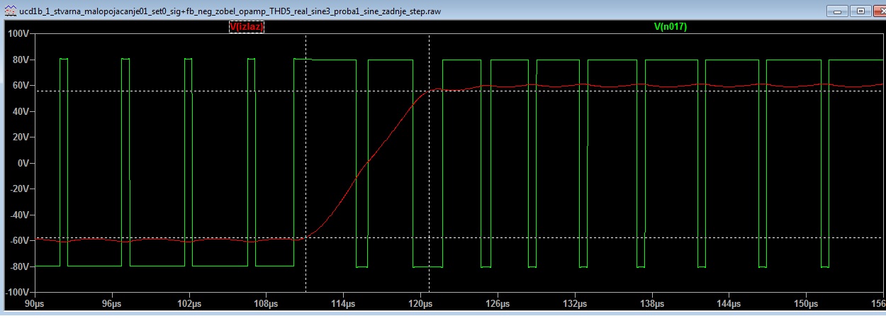

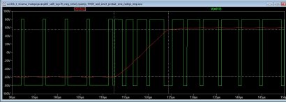

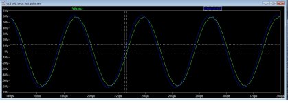

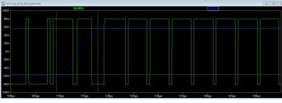

this waveform has some strange points
1. 0V points of input waveform,modulation waveform frequncy drop or stopping.
this circuit has phaseshift problem.without input voltage this amplifier not oscillate
and with small input voltage variation amplifier start and stop oscillation
This rather seems slew rate limitation. Output voltage simply can't change fast enough, due to the filter. This is normal. According to this waveform this amp can be very good. And if distortion is really this low, then it definitely worth trying and testing throughly.

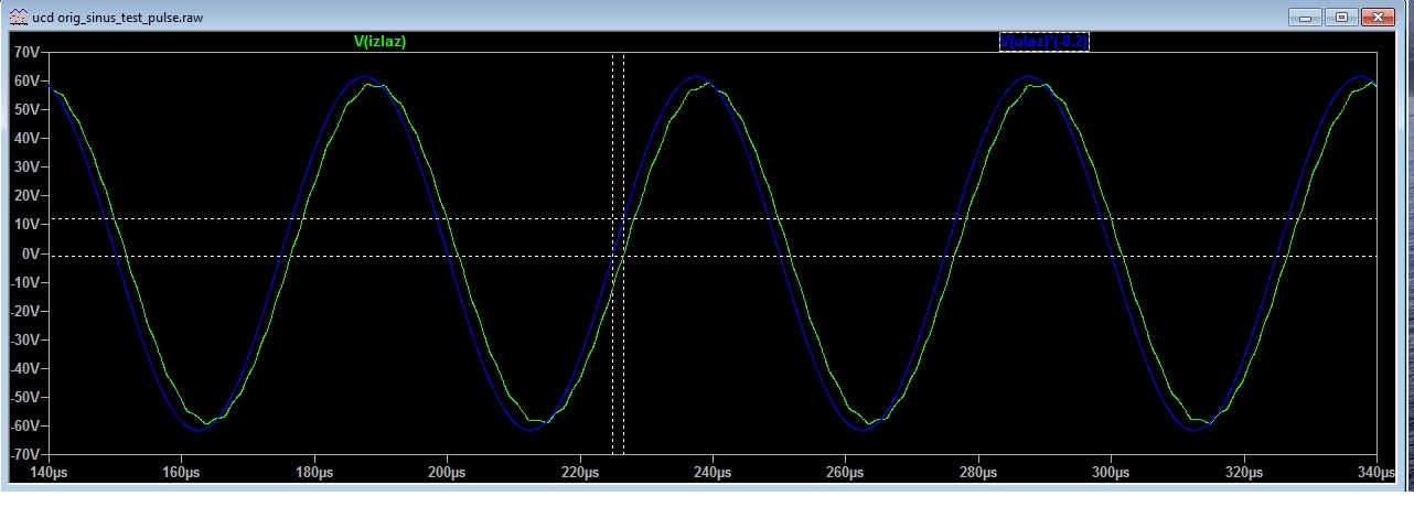

Phase shift at 20 khz is hmm 5-10 degree.

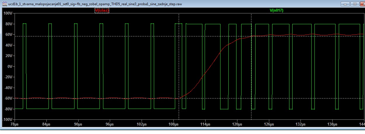

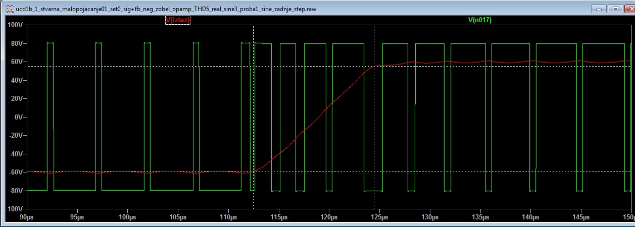

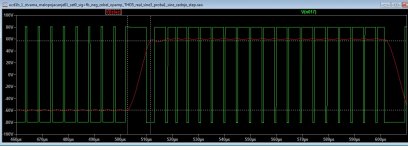

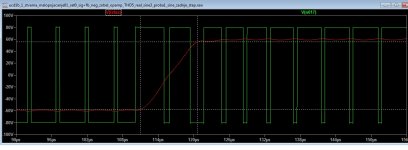

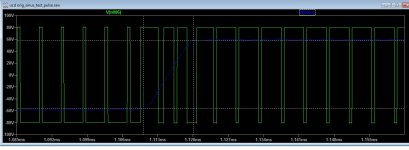

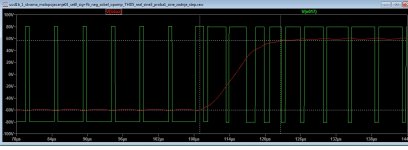

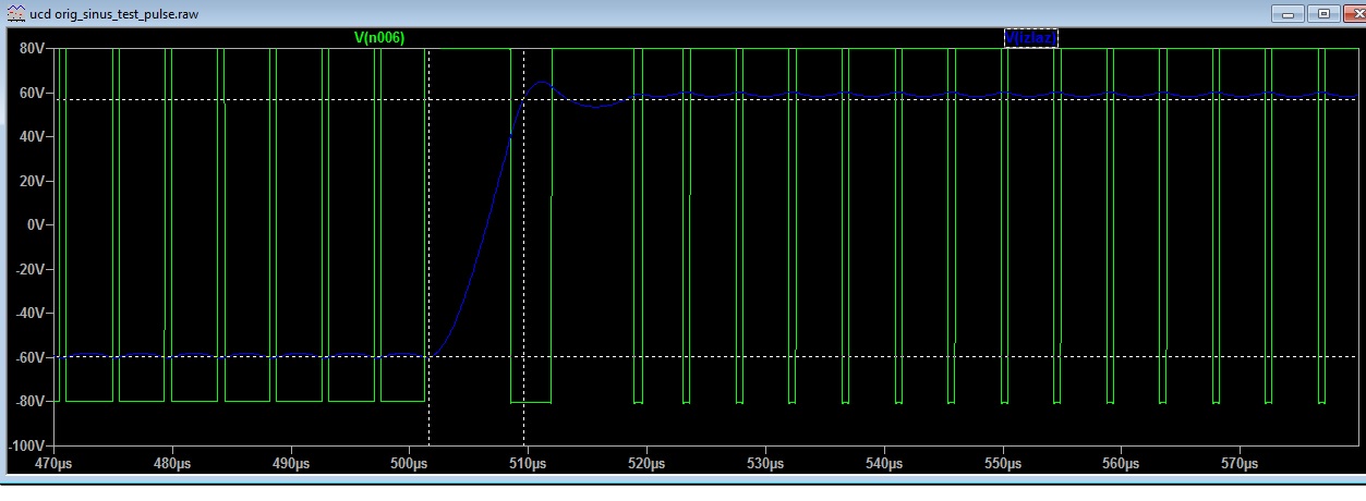

I agree and I just made some images to show:
First of all how to attach thumbs ?
Output is set to all images +/- 60V, supply +/- 80V
Input square rise fall time was increased until output becomes more stable. Slower the V/us at the output slower rise fall time at the input (I mena input square rise fall time was adjusted to compare oring ucd to enhanced ucd)
Input filter_enhnaced ucd is 1 k 2n2 low pass RC at the input of non inverting op amp
Original ucd without zobel network.
Enhanced ucd output filter paralel to 1uF main capacitor is RC zobel: 10 ohm 660 nF. Zobel pracitly make sifference only when output filter is not loaded. So when output filter is loaded with for example 1000 ohm this zobel makes it stil oscillated and it is kind of stable both for irignal and enchanced ucd

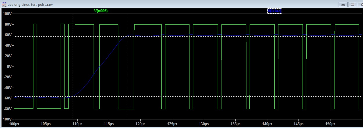

Orignal UCD_ 135kHz markers_ 14.5 V/ uS
Ucd Orig 117kHz markers, 13 V /uS
UCD orig, 11V/uS, this we can call minimum input rise fall that gives good output and stable

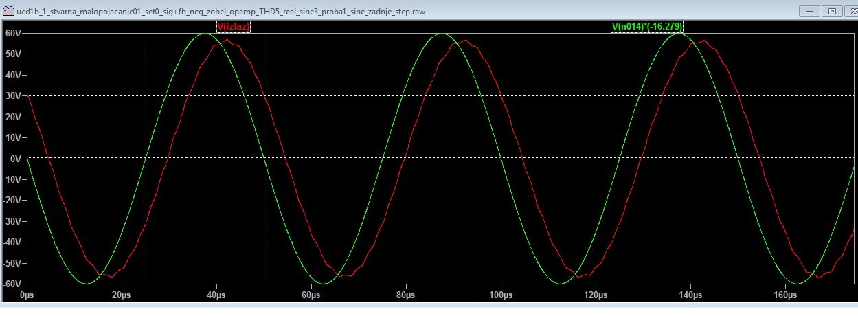

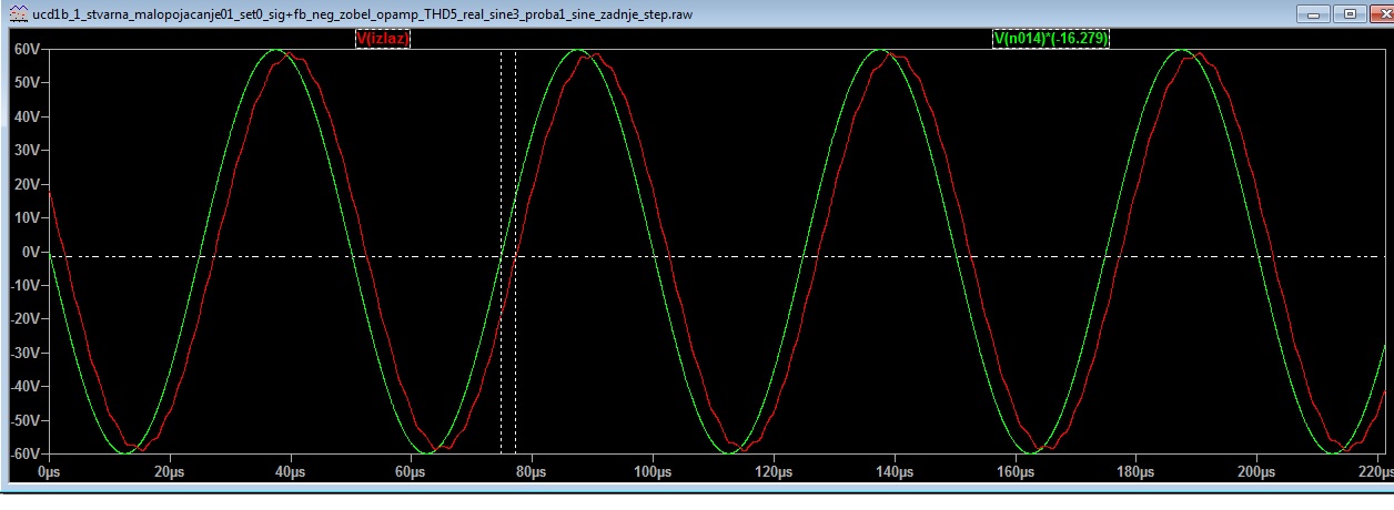

orig ucd_ This is phase delay at 20 khz 1.66 uS delay
Enhanced UCD with input filter 13 V/uS 112 khz markers
Enhanced UCD with input filter, 9V/uS, 73 kHz, input rise fall time increased to get stable output
Enhanced UCD with input filter phase, 20 khz, 4.45 uS delay
Unhanced UCD, no input filter, rise fall time input was adjusted to get stability, 12v/uS, this mean that it is only 1V/uS slower rise then original UCD !!! which is 13 uS
Enhanced UCD_ no input filter, rise fall at input adjusted to get stable output, 9.5 V/uS, compared to original UCD stable 11 V/uS
Enhanced UCD, no input filter 20 khz size phase delay, 2.39 uS

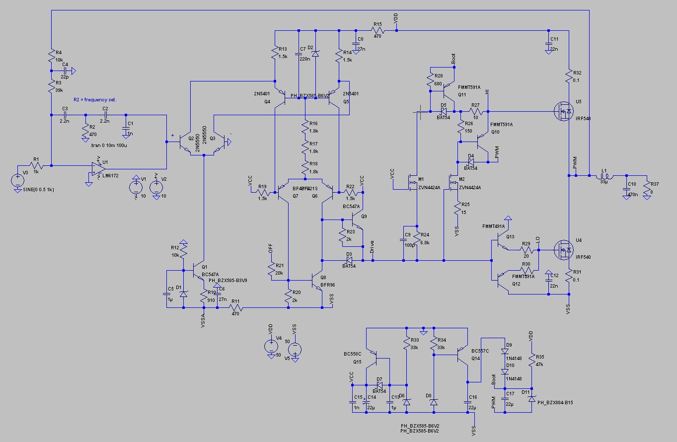

I just put this into spice http://www.diyaudio.com/forums/clas...cd-high-quality-power-amplifier-2x100w-4.html
(in page 1 is feedback network) and this seems SUPERIOR to all what I have seen so far !!. THD in my spice setup (the same setup) for all versions is 0,001 % compared to 0,1 % for original UCD, and compared to 0,01 % to this "enhanced ucd"
I have to check if here is thd frequency related.. But this circuit behaves differently then origianl UCD design.
all in all in this UCD+ THD is frequency dependent, 200 hz 0,0003%, 1000 Hz 0,002%, 19 khz 0,1% (more or less in spice), seems this integrator is "activ" in audio range, and at lower frequencies thd is lower.

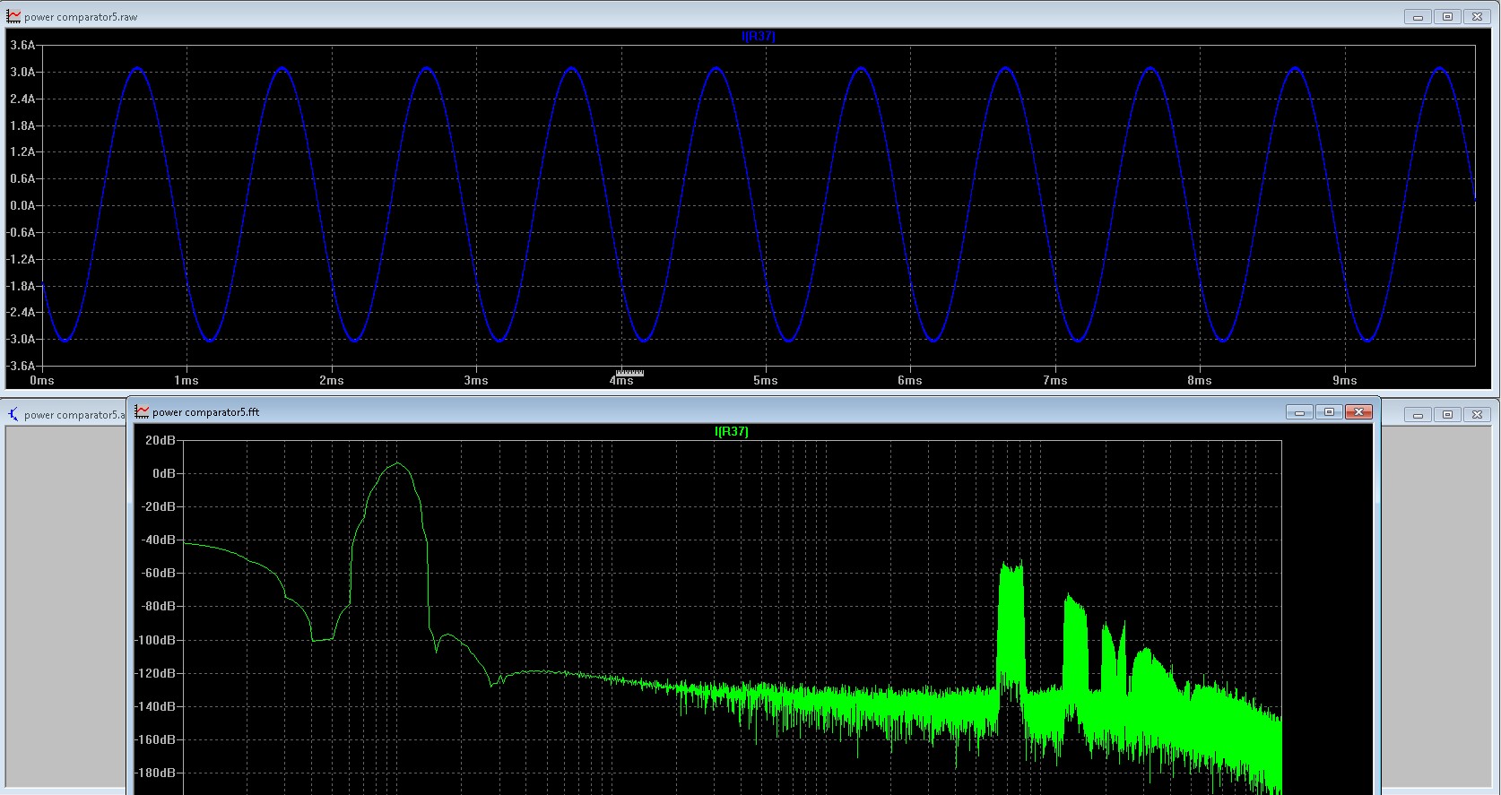

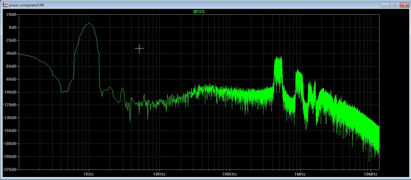

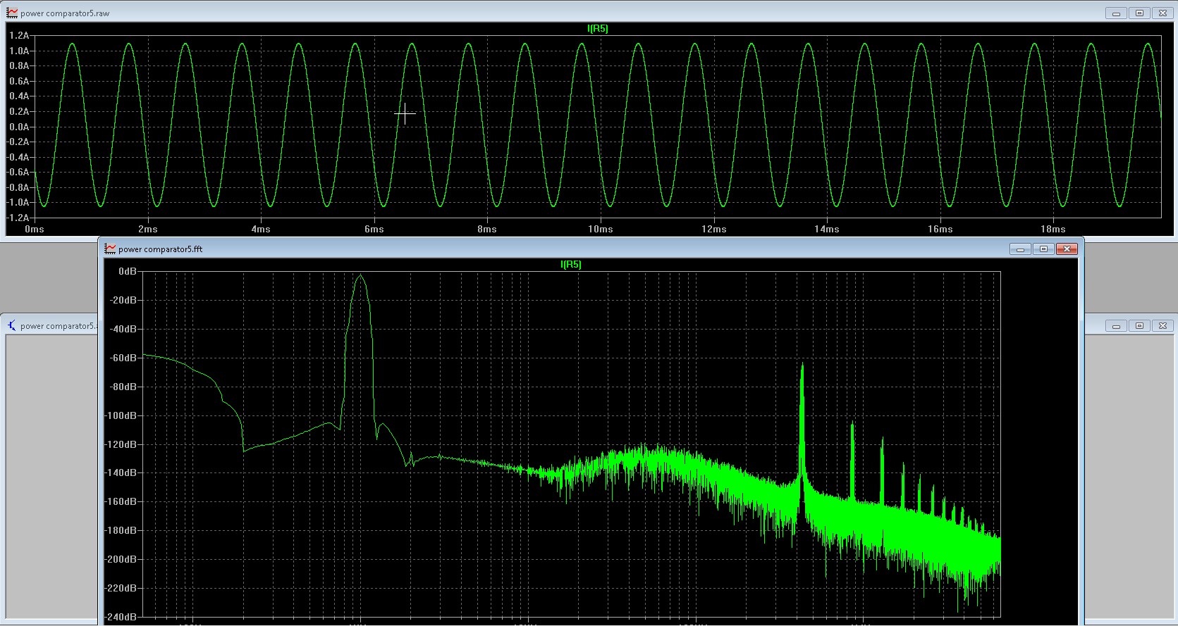

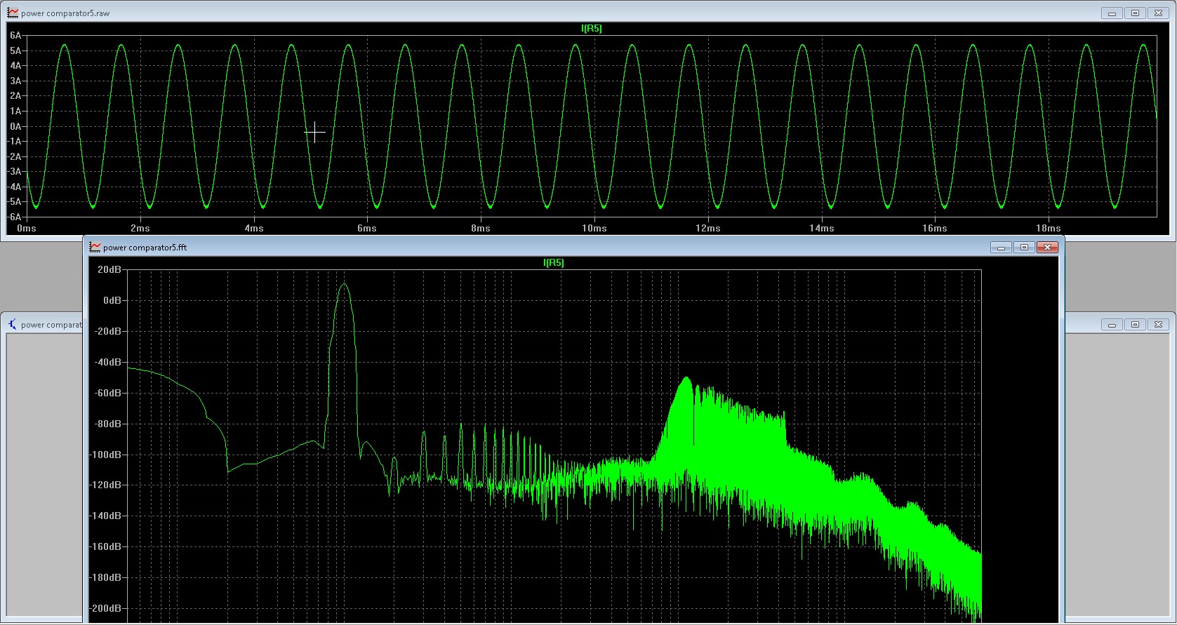

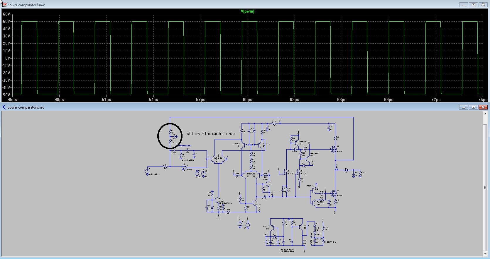

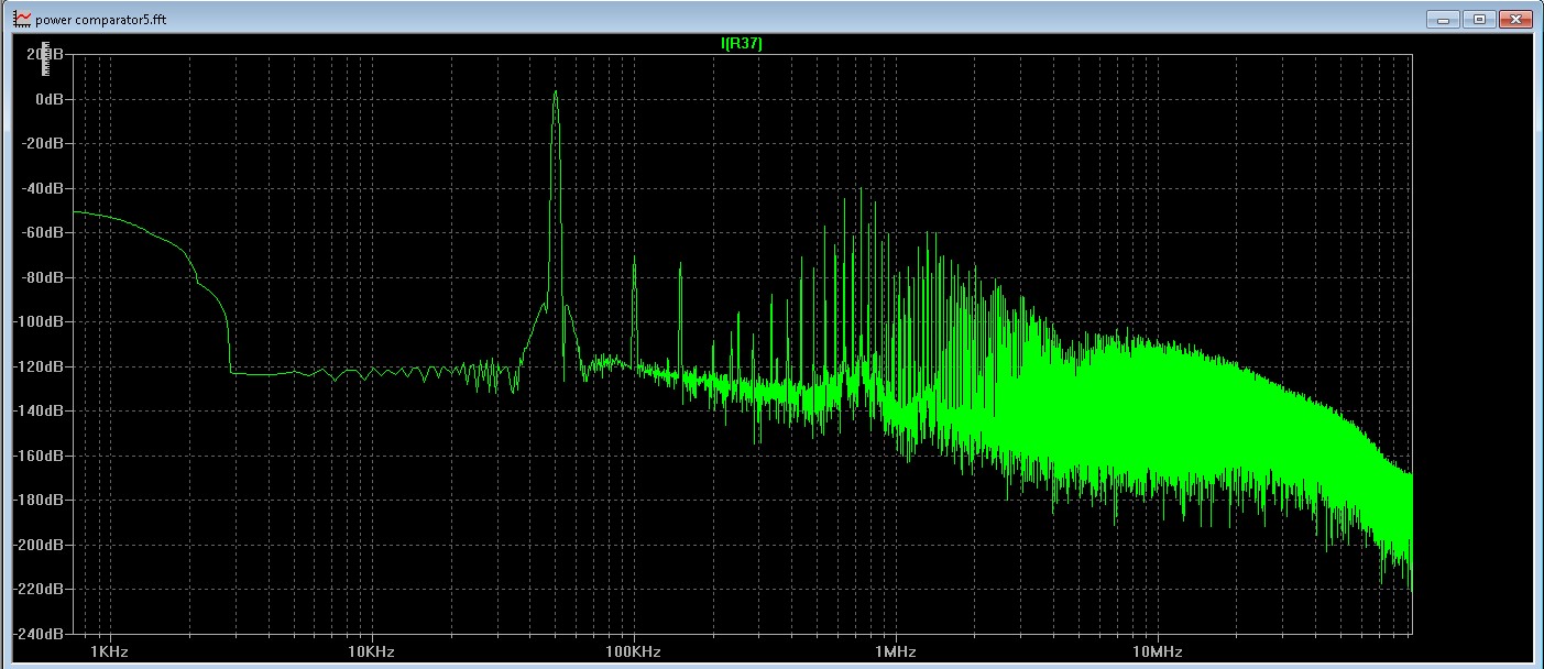

I did sim this one, a discrete version of a comparator who I did found on internet and adjust some things, with that I have done some tests with it, and I get quite low distortion in ltspice, so maybe make a pcb and build that soon.
Only to test the ac sweep with a D class switching amp how I do that in ltspice, it is already slow with simulating when using switching.
I have test 1 Khz, 50 Khz, and mid and high power measurement, all give low distortions whith extra poles in system, cam made hysteric also but not done..
regards
regards

@Grizlek I am had a idea not to do that, because I do hybrids without feedback, so I kept coil out, ask myself to use a 24 dB bessel lowpass who is fase lineair and introduce not much distortion.
But is the filter such a part that will go out of control easely? or get I as a anti feedback guy the tube like sound character that way, this is why I did, but has also try including that with post forward on output for get right osc freq.
See mine stuf as a other way, I did post because I did get such low distortion, and was a little proud, I do not now much yet about this technologie, I do know afcouse about smps switch stuff, but this is new.

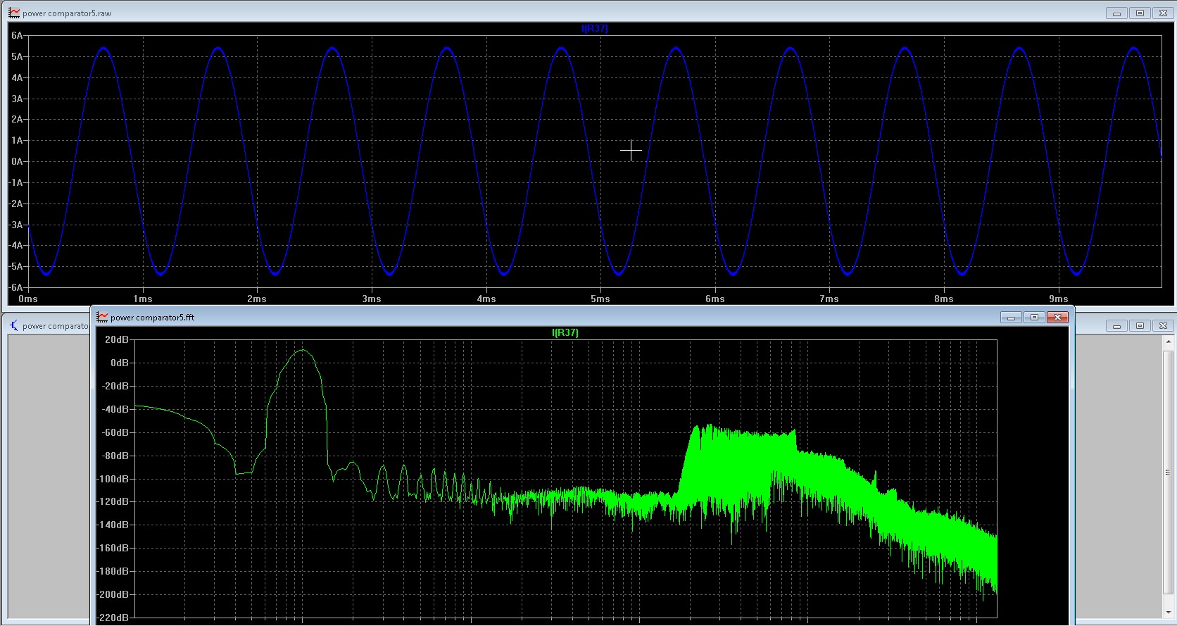

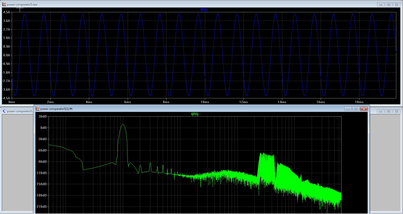

Yes it can with some extra resistors and caps, I have also try bessel 24dB filter coils, these are fase liniair, but setting the low pass -3dB point on right place I can try what happens, nice hobby to try this kind of stuff.
see here on picture with different power settings, it is on 450 Khz, but get very low when drive hard as expected see last photo where almost clipped.
For people who not see protection, it is not on schematic but it is there, a one shot type.
For the core there are many different types, so maybe there is one who work, but with a 24dB bessel lowpass we can stay on 400 Khz.
