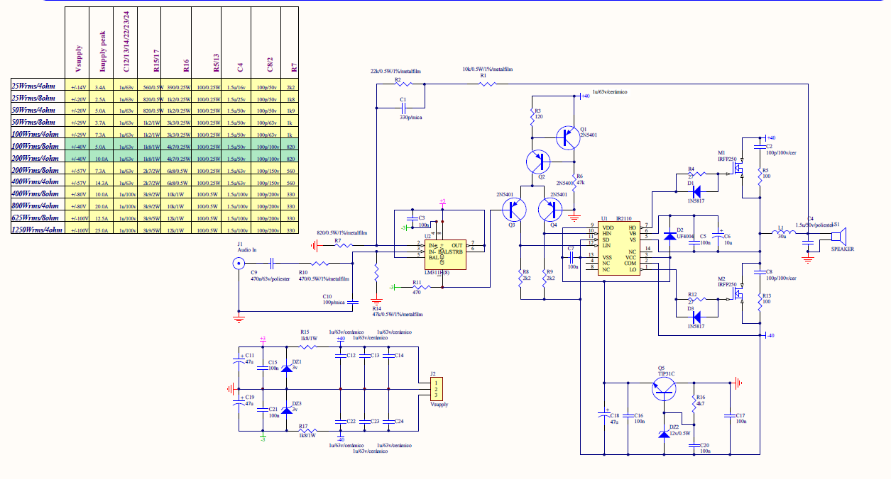

this one...

this one...
If you don't want too much power (1200W is too much), and you draw a good layout, and you use proper parts, and you never short the output, etc... then probably it will not fry your speaker. With some luck.
However it has a quite high DC offset. Risky.

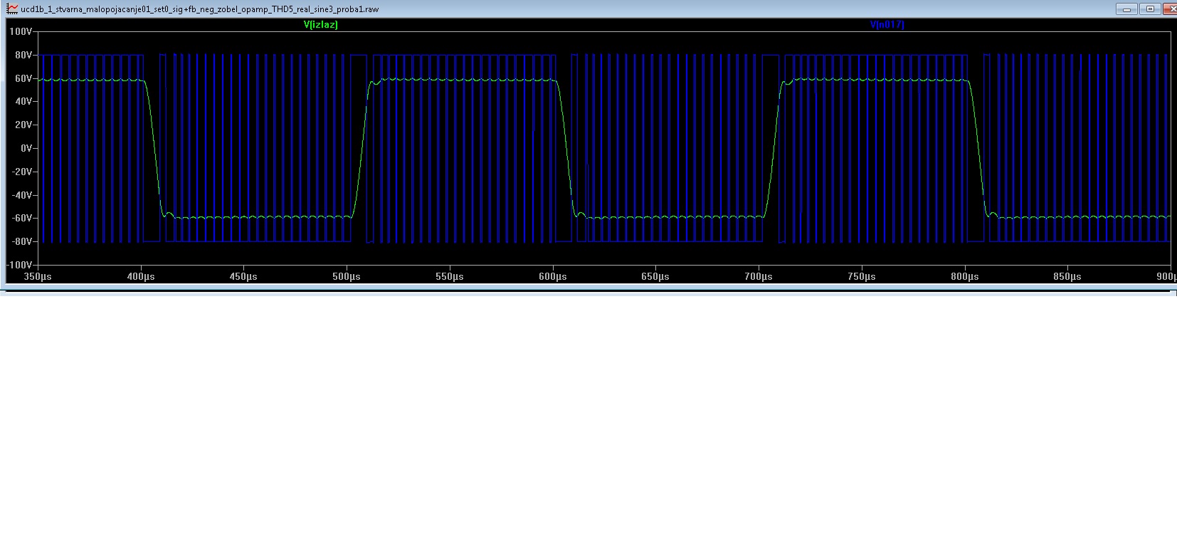

I started spice experimenting, both AC and transient analysis, and I managed to get this working and got about 57 dB loop between fsw vs audio range.
Phase is crossed first time ad 45 khz and second time at 500 khz
If phase is crossed at about 150 and 500 khz, then at amplitude of input signal which reduces pwm to 150 khz, amplifier starts to oscillate at 150 khz.
In this case it does not oscillate at 45 khz.
all is based on DTU file
https://www.hobbielektronika.hu/foru....php?id=253790
Thd is reduced about 5 times.

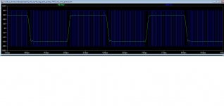

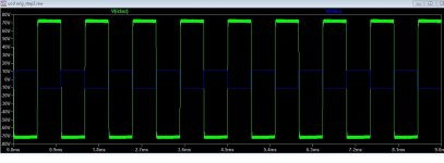

But, all nice in spice, but even in spice transient analysis, all those options where 180 degree phase is crossed, and where THD is reduced 10 times compared to the original UCD (basic), works fine until we do not put square signal at the imput. Rise time of square signal has to be slow , if rise the is anywhere near frequency of the first 180 degree crossing (about 40 khz) it will oscillate at 40 khz for some time.
Another option is to put at the imput of amplifier RC filter that blocks all above audio range 30 khz, question is, should amplifier really have fast transinets to make "bass" membrane as fast as possible hmm. Is that really necesarry ?

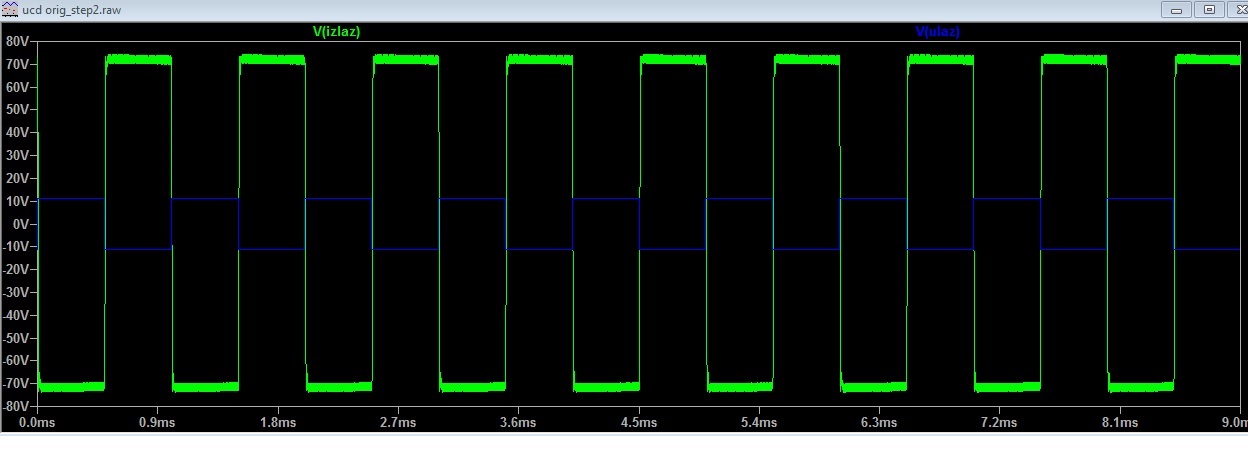

Classic UCD transient step 1us rise time, completely stable even without zobel netwrok :

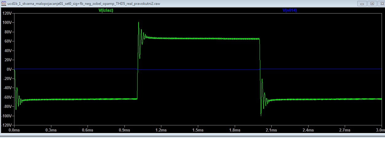

Enhanced ucd, step 1us tise time:

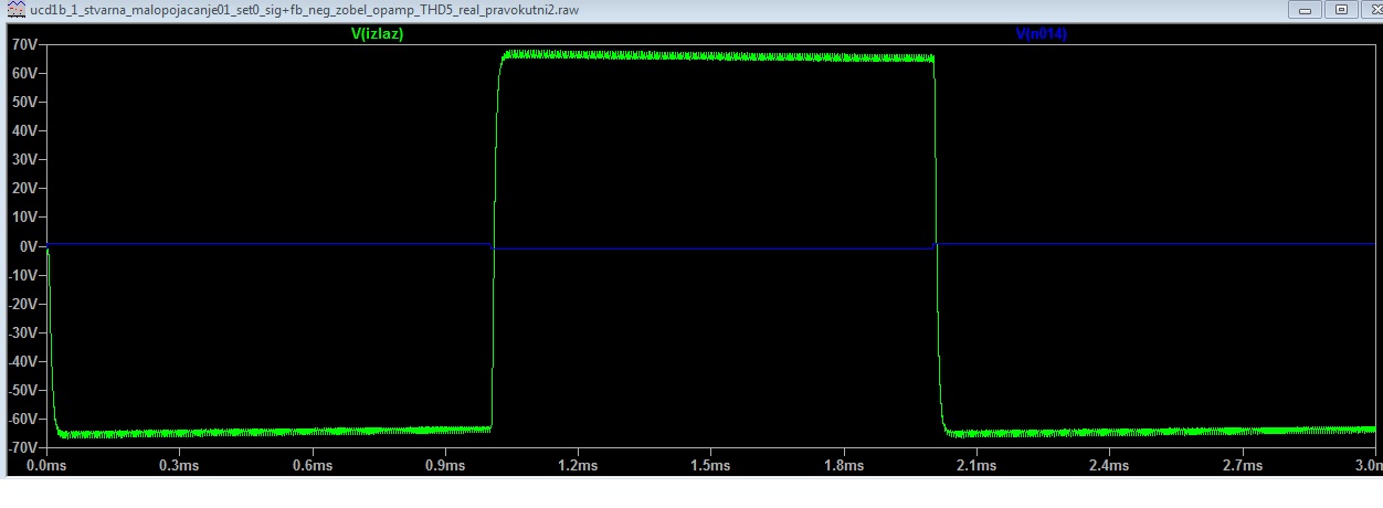

Enhanced ucd, step , but at the imput is RC filter at about 30 khz
So I wonder, for good amplifier, is step response, whose slope (rise and fall time) is faster then slope of sine of 20 khz, REALLY neccesarry.
If you can choose, what would you choose:
1) Classic UCD with about 0,1 % THD
This type of amplifier is very stable, and slew rate of output when input is square is very fast. According to my spice simulations, if we put step at the input of rise and fall time 1- 2uS (equals of sine at about 100 khz or above).
2) Enhanced UCD, adding extra poles and zeroes to the feedback:
We can reduce THD from 0,1 & to 0,004% (I managed to do this using this document above, in spice transient analysis), but now new problems arise, like mentioned in the previous post:
This can be repaired using RC filter and the input at about 25 khz.

Well I managed to get the "best" of two ways in spice, bandwidth vs thd: Input rc filter is now only 1k vs 2n2. And step input, output seems pretty stable.
Thd with 100nS dead time is 0,006-0,01% with Uout: peak = Vcc /2 : U out peak is 40V, Vcc is 80V.
Freq osc is about 520 khz
The same parameters for dead time and output voltage and ,very similar osc frequency (500 khz) for classic ucd, thd is about 0,1 %.
See attachment, better step response, input filter 3k /2n2.
this waveform has some strange points
1. 0V points of input waveform,modulation waveform frequncy drop or stopping.
this circuit has phaseshift problem.without input voltage this amplifier not oscillate
and with small input voltage variation amplifier start and stop oscillation
