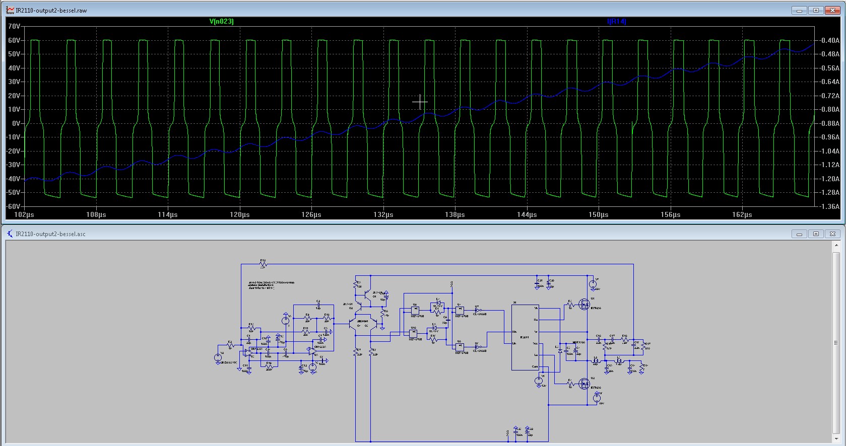

I have try some things with a discrete comparator and a IR2011 and lead lag and poles to get low distortions, however the IR2011 model for LTspice give a strange square wave and using dead time give more shoot through then without, strange.
I did put this here because here are some more tryouts and learning is always oke.

I did sim btl version, it give strange outcomes, need a 30 khz higher carrier on one side. better is indeed a full bridge, no need for sync.
Last picture you see the voltage is strange but the current looks oke with very low distortion, not yet dead time implemented tough.
