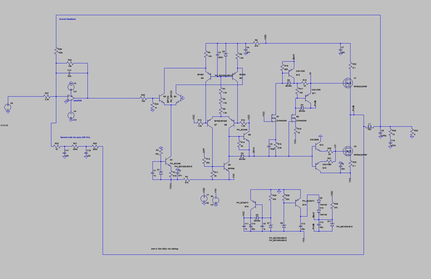

No I use a discrete power comparator for simplicity and to need only one supply,
I have this schematic who do stop when sound is off..

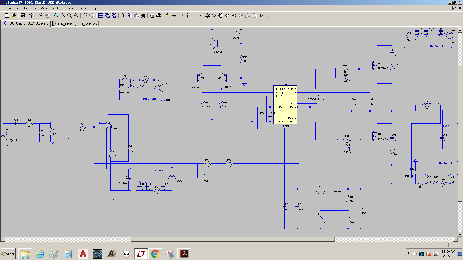

I would like to try the UCD with single supply and full bridge can anyone share the LTspice file for the IR2110 and the LM311 model?
I have many working projects , but they are mostly not UcD based . I don't like UcD - due to it's low loopgain it has heightened distortion , and if increase loopgain - it becomes unstable. I only use UcD for high (>1000W) power subamps, where THD is not the main criterion . And due to postfilter feedback can use less expensive output inductor, something like sendust ring cores....
Here is my old UcD bridge , cliplimiter on board.
UCD can get low HD when properly designed, multipole settings with low pass filters, ucd is self oscillating, best is design d amp who has without feedback already lwo HD, that is challencing but maybe a good step up for high end where there is not much yet.
Here she are.
wow thank you will post some sims soon.Here she are.

Hi there are no S and BAL pins on the 311 spicesHere she are.
Tried simulating but im getting error as there are no lib files for the IR2110
I did have the same, and I have the lib and sub, here she are, maybe you can find out, ltspice is sometimes difficult.
you can use .include IR21XX.lib but I did see I have a error with pins.
thanks dimonis for sharing .nice layout .please post schematic of the project.

can anybody please tell me whats wrong in the schematic?
Probably the input polarity of comparator. The polarity definition changes when you use the other output.
