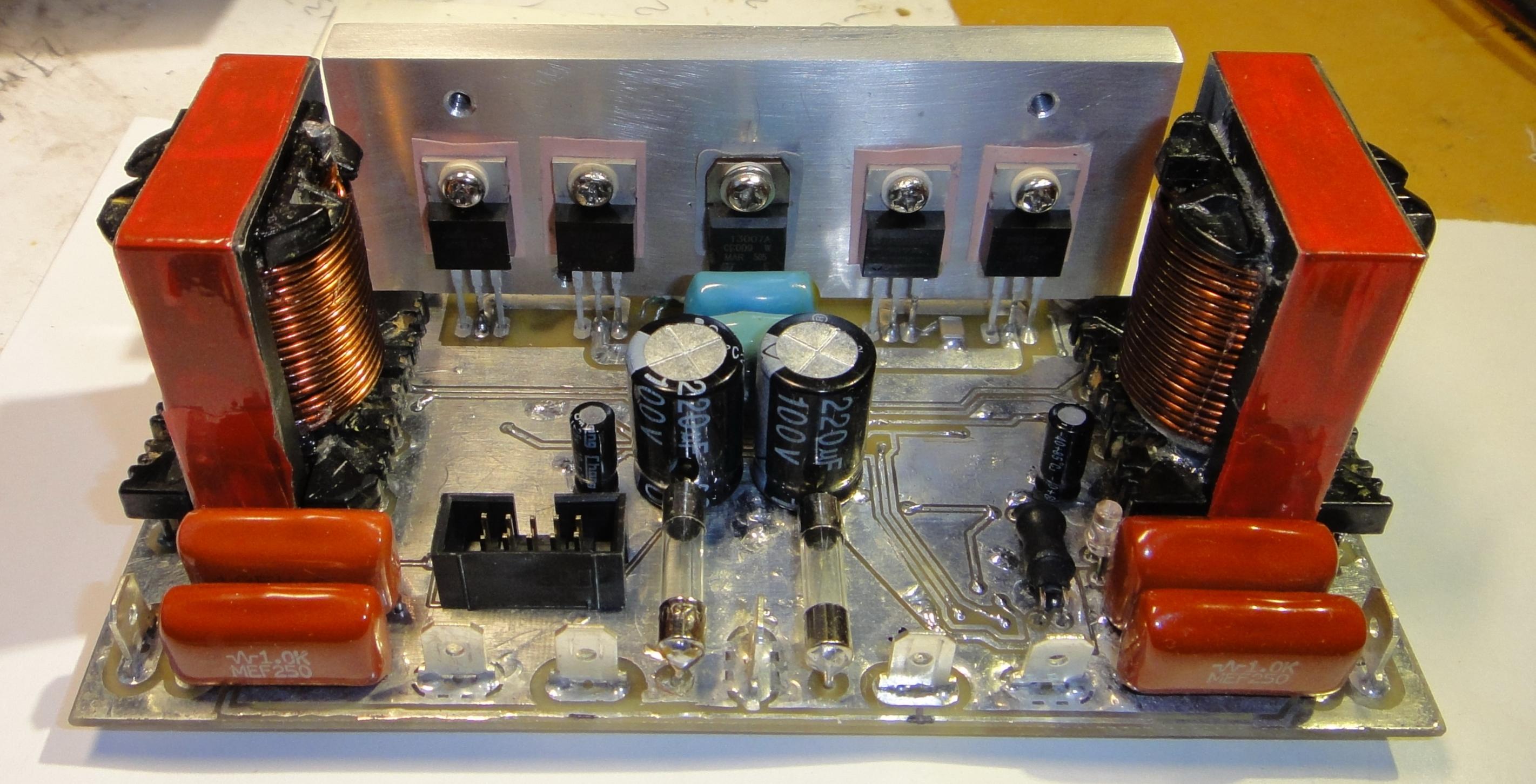

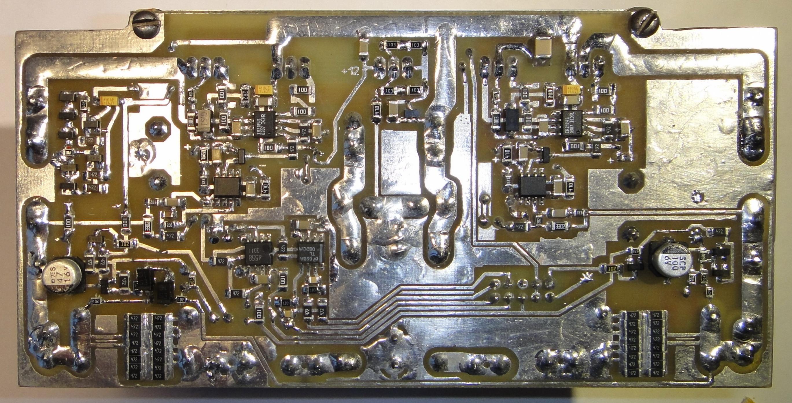

I have many working projects , but they are mostly not UcD based . I don't like UcD - due to it's low loopgain it has heightened distortion , and if increase loopgain - it becomes unstable. I only use UcD for high (>1000W) power subamps, where THD is not the main criterion . And due to postfilter feedback can use less expensive output inductor, something like sendust ring cores....
Here is my old UcD bridge , cliplimiter on board.

I have full discrete UcD fulbridge working already.
Aha... low loop gain UcD 😀
I can smell it 😀
