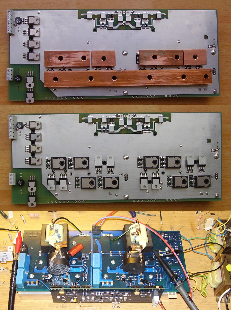

hi dimonis please share your working schematic of your approach on class d 😉

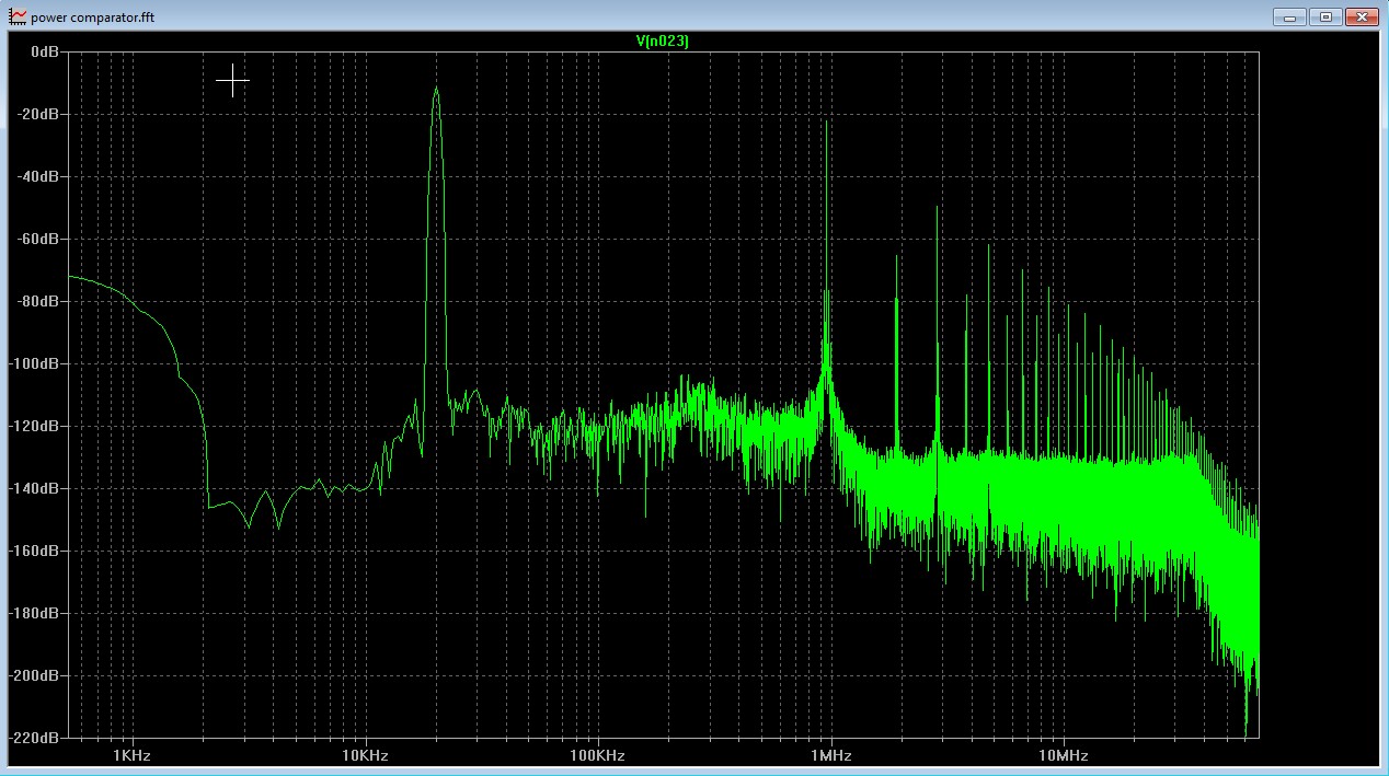

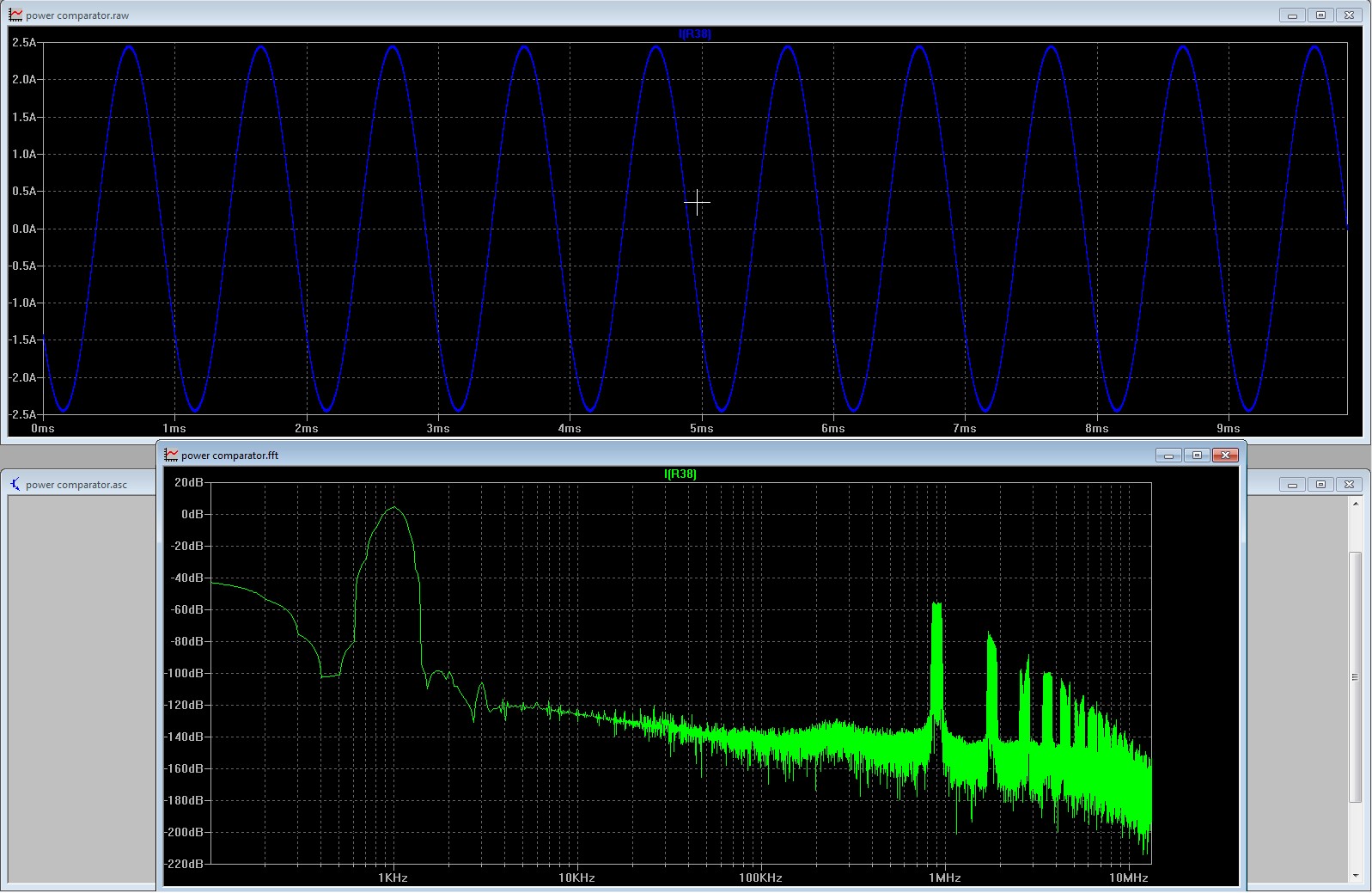

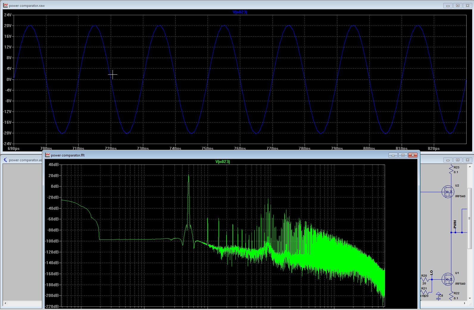

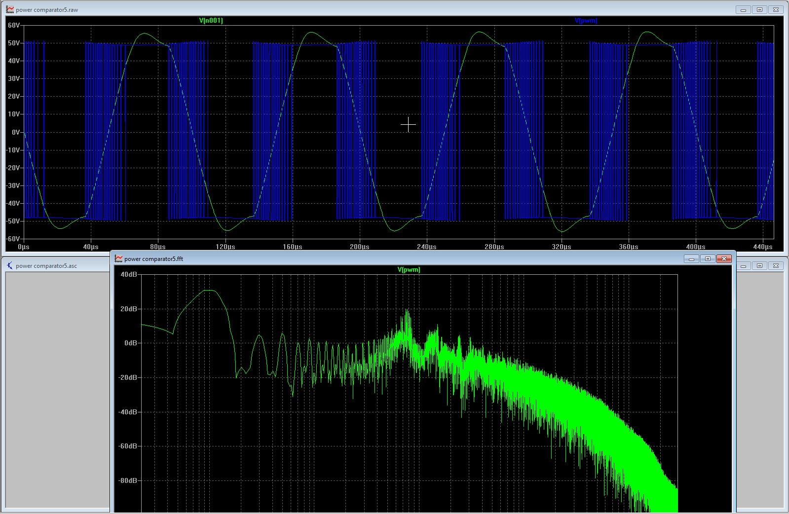

I did a cliptest with a faseshift type class D, it has low distortion in sim but in real live it needs to be build and tested.
clip was more then 100 Volts peak, and as you see the carrier stays stable quite good, maybe because of the multipole feedback network, who did ask a lot of tryout's..
Last picture,s is distortion with 40 volts peak output.
