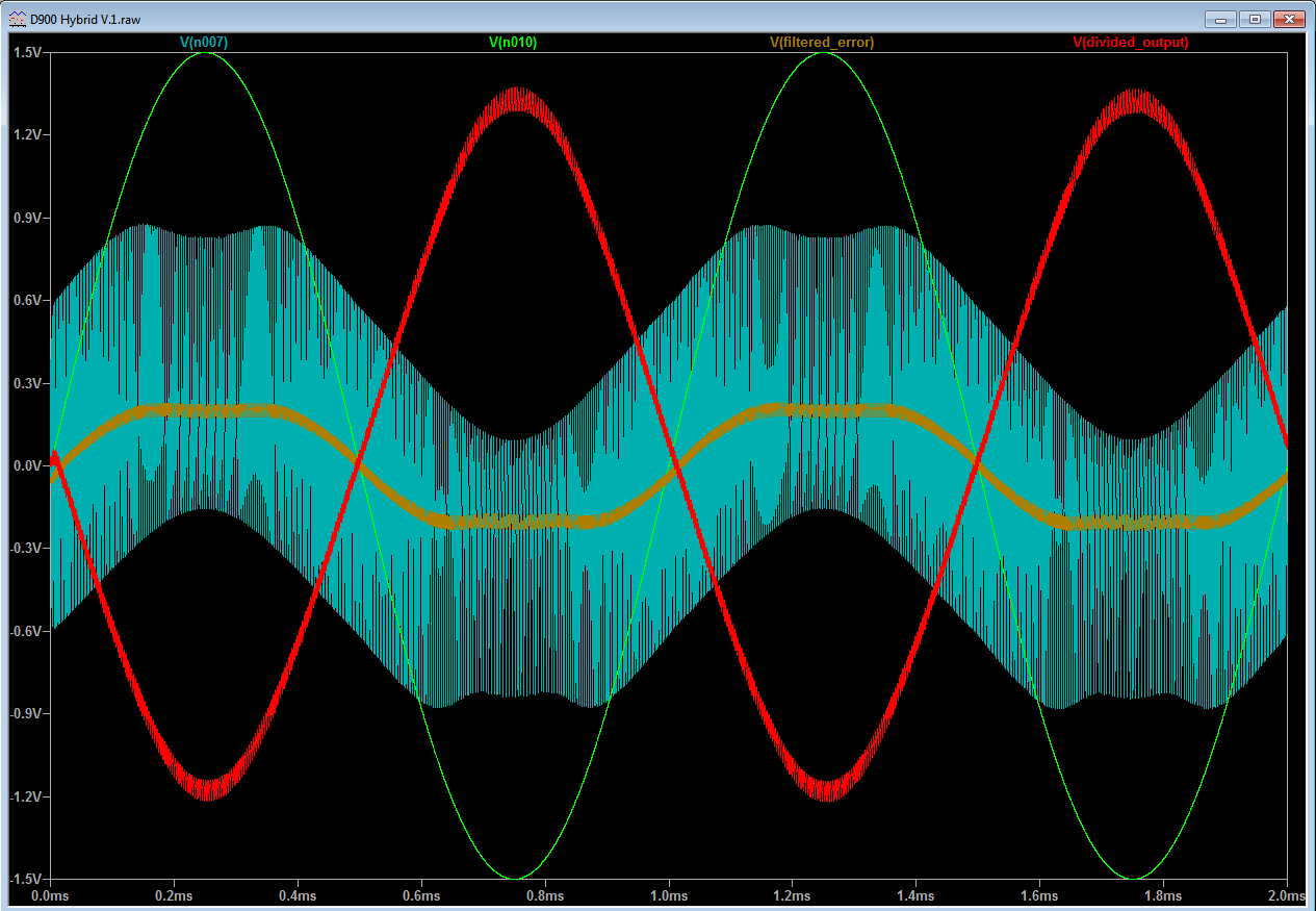

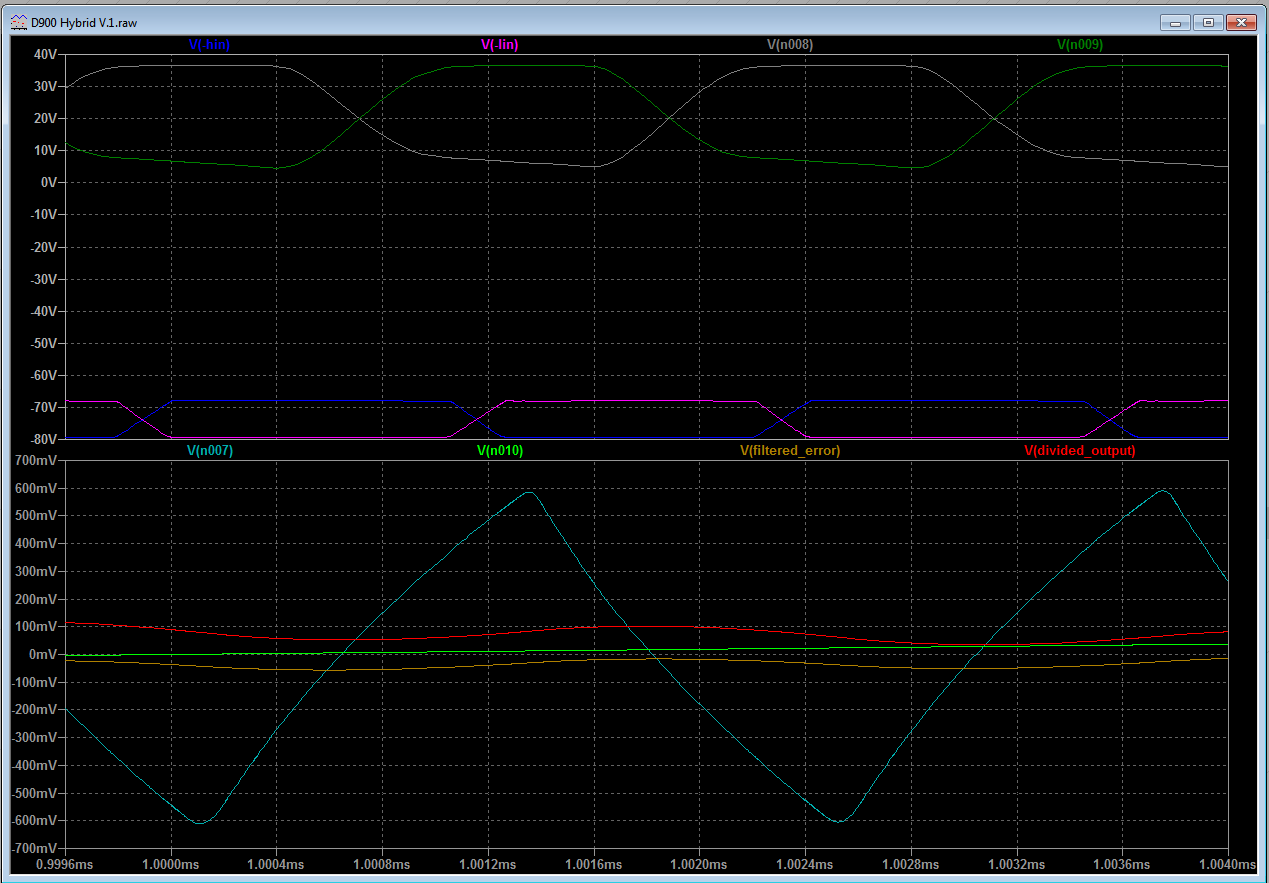

And Pafi, you said the schematic has other issues. then please tell.
Dear Kartino,
As you wish. (I'm glad you don't refuse to face the problems.)
The first problem to mention is distortion. At 1 kHz, 60V peak output there is about 3 % THD.
This is partly due to the fact that you don't use integrator, but essentially caused by the very high and nonlinear delay.
1st stage is acceptable, but the second is terribly slow, and the delay time is nonlinearly dependent on the signal.
In a ClassD amp the delay determining operation freq should depend on signal in linear way, or low order polinomial way at least.
Other problems are the high offset drift, the low input impedance, the input-source dependent operation freq...
And as a bonus a chance for exploding, not just because there is no protection in it at all, but also R24 creates a possibility for control error: while C1 is less charged than C3, both Hin and Lin gets high level control signal, that can open both output FETs.
There are some other minor mistakes not worth to mention, because they are not harmful...
If I have time I will correct the mayor errors in the schematic.

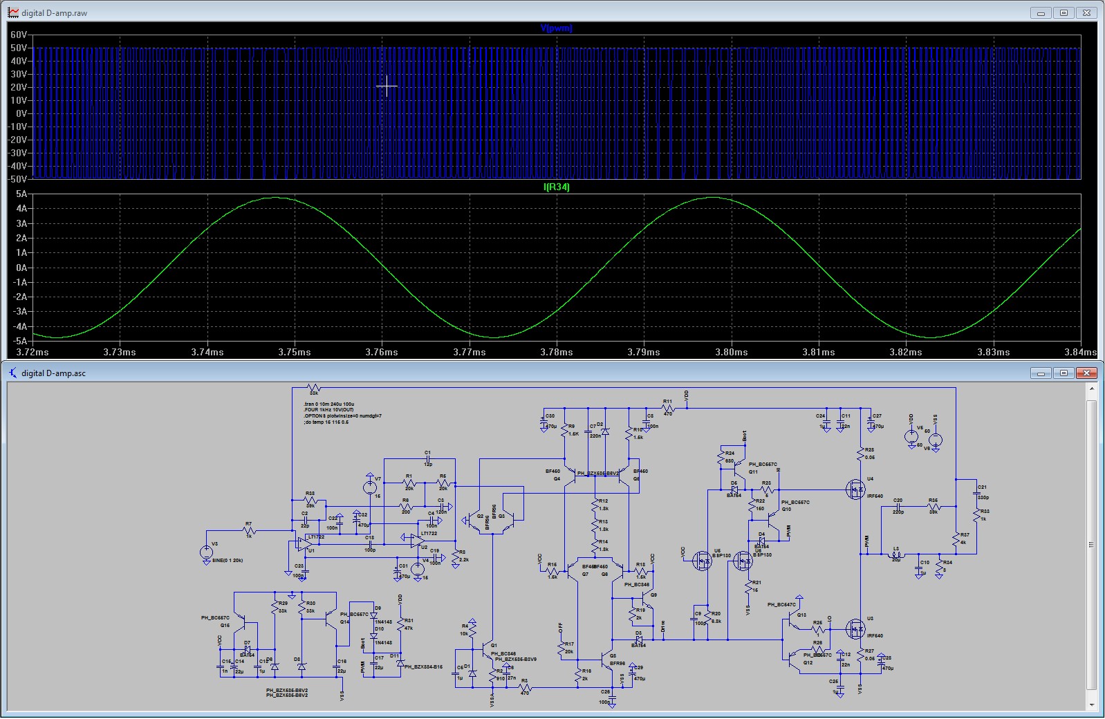

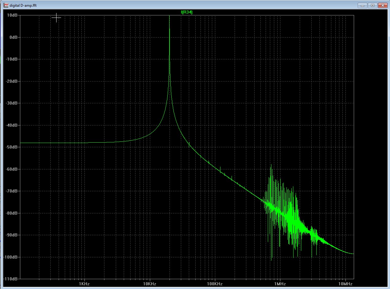

I have just did some sims about UCD switching amp, but for now I go further on circlotron liniair allfet, lazy days are over.
Class D is shure nice play tools, but wauw so much attemps to get the best amp, still there is room for patents.
pictures are a discrete power comparator and normal output stage switching on 700 Khz or around.
The class D in picture schematic is with a multi pole HD shaper.

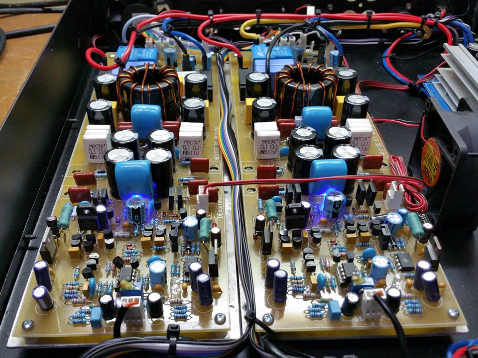

And this is my discrete UcD.
Of course it is with protection.
Please post all details,pcb and schematic for this amlifier.

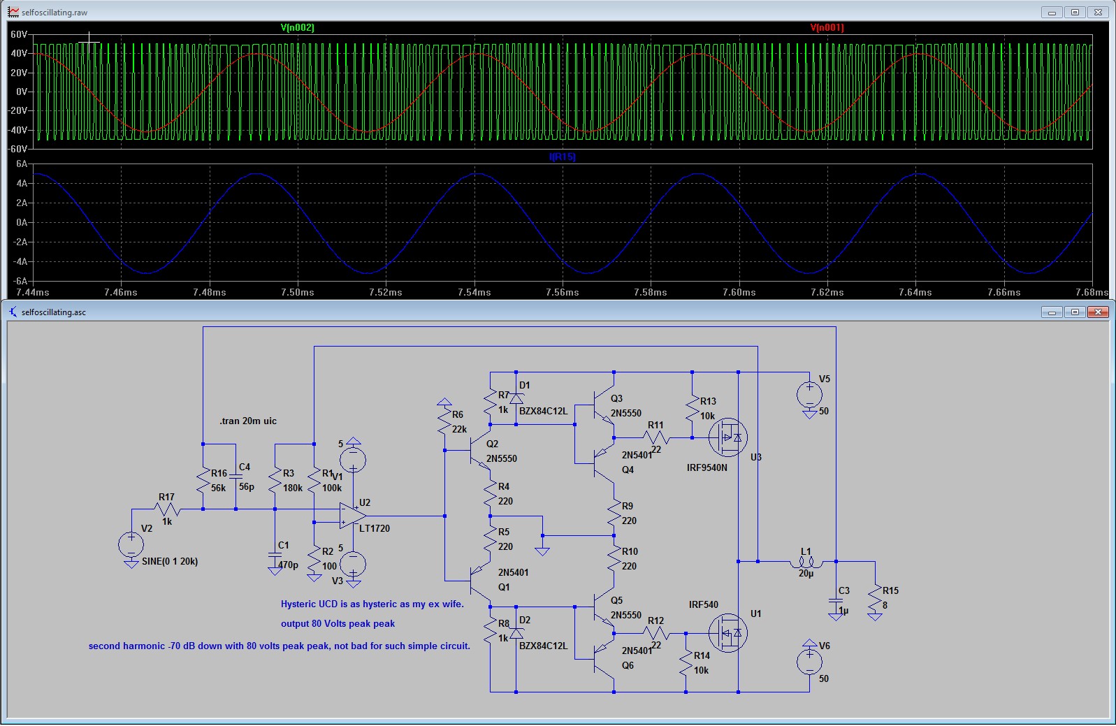

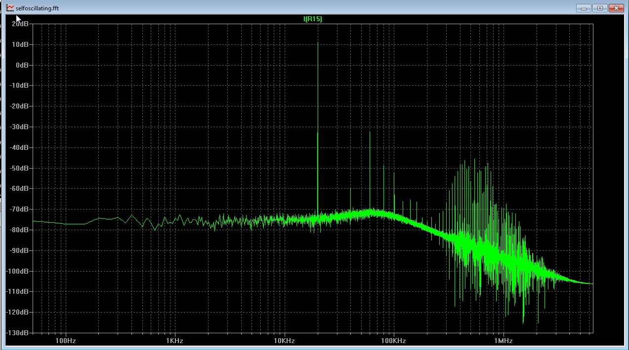

Nice, but I don't understand some things. Why do you call the 1st one digital? If timing was discrete only then it was digital. Why switching freq changes asymmetrically, and why do you accept it? What "HD" stands for? And please adjust window size of FFT to whole periods to avoid spectral leakage!
About the second sim:
Hysteretic ucd is an oximoron. UcD is free of hysteresis (check in patent!). And doesn't use pre-filter feedback at all. And why to mention 2nd harmonic in a basically symmetric circuit when there is a 30 dB bigger 3rd harmonic?
Generally: to design a practically useful schematic there are further requirements above switching freq and distortion:
- Low idle loss and low distortion at small signal (these are contradictional requirements!)
- Low loss at nominal power.
- Low output offset voltage with unmatched components
- Acceptable temperature dependency of the above mentioned parameters (may be checked with temp parameter stepping)
- Low sensitivity to parasitic effects
- Good overdrive behaviour
- Safe turn on and off behaviour
- Stable and safe operation without load
- Fast overcurrent protection
- Overvoltage protection
- Stable and safe operation without input source
