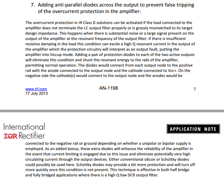

have you ever tried to remove the resistive 4ohm load when the amp is operational at high spl??
If you're experiencing problems when speaker is disconnected at high volume. Try to put antiparallel diodes (>= 4 amps rated, ultrafast) after the output filter. The amp module also needs very good overcurrent protection circuit. So that when speaker is removed while playing loud, the amp will survive.
Or you can put a dummy 150 ohms (30W) load that is permanently connected to the output.
Use dummy load with lowest resistance that will make the amp stable, but high enough such that when amp is driven at full volume without speakers attached, the dummy load will dissipate low heat as possible.

mr stewin. without load when i increase volume ocp is activate ! it is high current problem when lc filter resonnate? anti parallel diode is it a sollution? i see them a standart rectifier diode at output with iraudamp 7 schematic

Nonsense
If you make a normal , stable feedback in your amp - nothing of that kind may happen .

These compromized solutions help somewhat at the price of higher loss, lower transmittion bandwidth, but the correct solution is much better.
You can set high resonant freq, but it will increase loss and output ripple. You can set input bandwidth limit, but it is a loss in quality, and still doesn't solve the problem, only eases. A good UcD amp can have significantly higher bandwidh than its output filter, and no resonance can be observed with any practical load.
In case of UcD a zobel network is also beneficial, but not the way as in a pre-filter fed back amp. In case of UcD switching freq is affected somewhat by load impedance, especially at very high modulation index, and this dependance is lower with zobel. But no resonance at the filter freq.

This problem? What do you mean? Resonance of output filter without load? This is independent from the oscillation method. This depends on feedback topology (pre- or post-filter).
And why is this unacceptable? Because it activates protection as you saw. And this can happen not only at completely disconnected speaker, but also with a woofer with low pass filter (very high impedance at high freq). Also because zobel can burn out by a sustained resonance.
