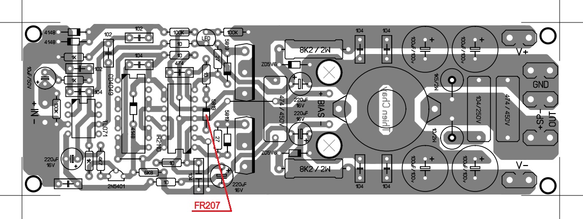

Hi all pls help . The irs900d i made , i tested with +/-45vlts everything was o.k except ir2110 heating which was solved by a small heatsink . When i added the voltage to +/-75vlts the amp works for a few minitues then distorts badly all channels behave the same. the components are exactly the ones posted in irs900d . When i reduced the voltage to +/- 39vlts all channels are working o.k .
The amp has 3channels , my inductor is etd42 20turns . Outputs are irfp250n with 100ohms gate resistor . the aux voltage i used irf640 for each channel to produce the +12vlts the main capacitor is 100vlts x 1000uf x 4pieces.

irs900d is using 2inverter buffer (cd4049) pls change the schemantic pcb layout to 3 inverter buffer stage.

i dnt have schematic i was try irs900 but its failed in high voltage, the i try irs1500 its work perfect with +- 75 voltage. small difference between irs900 and irs1500.

Hi Stewin,When i added the voltage to +/-75vlts the amp works for a few minitues then distorts badly all channels behave the same. the components are exactly the ones posted in irs900d .
may be your filter, its saturated due to high voltage. T157-2 for high voltage application.
T106-2 for max.65V supply.

The resistor for oscillation in irs900 is the one 1k between the two 1nf near the amps input.the gate resistors has to be 100ohms if you are using irfp250n . The inductor try 80uh .the irs900 is not friendly to high voltage . Have fun.

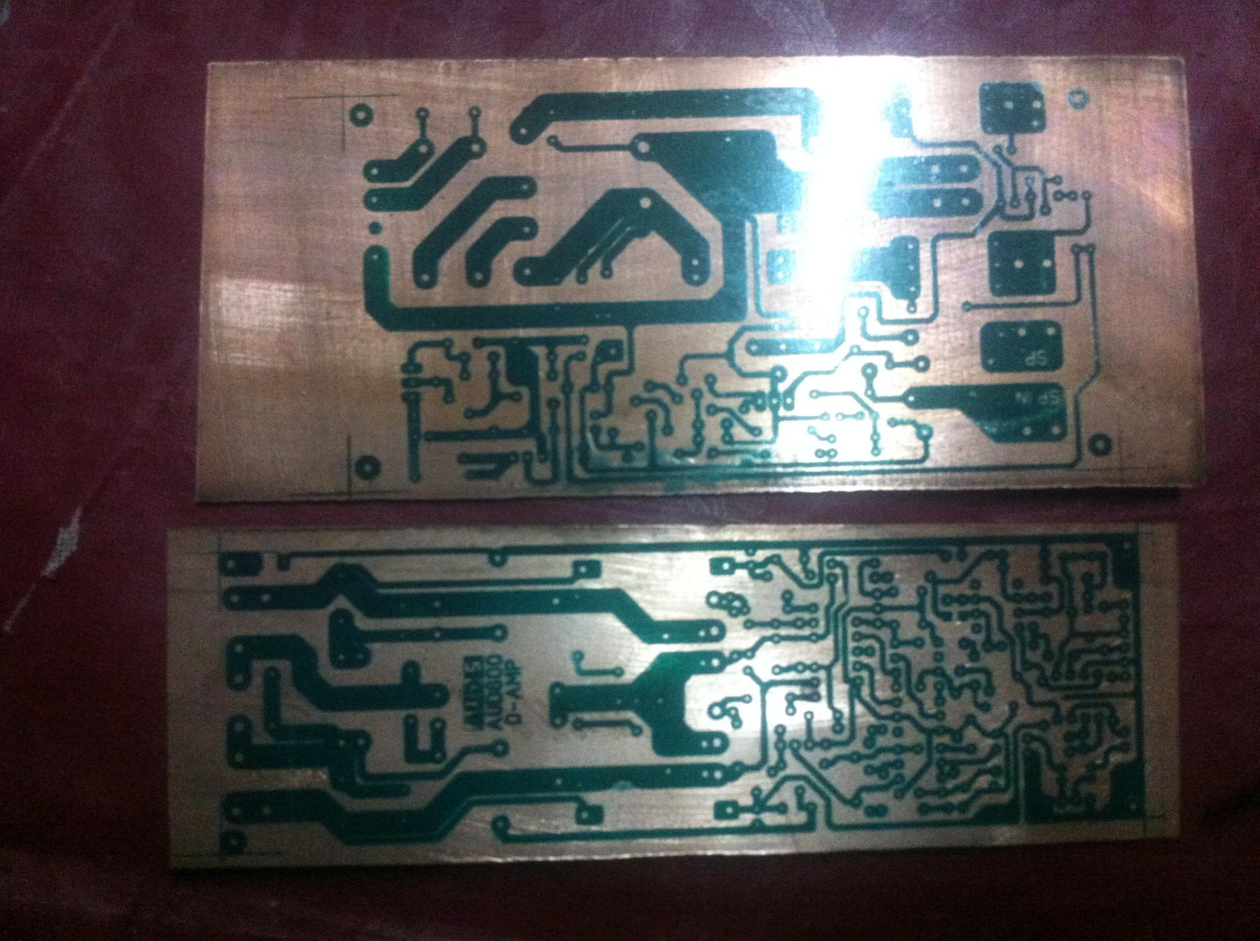

creat ver 1.0
it was work so good
i have T106-2 and 0.8 mm wire
how much turn for IRS series dear friend ?
have nice time🙂
Ho to all
IRS series PCB not good
sir manoj and apex PCB is so beter
