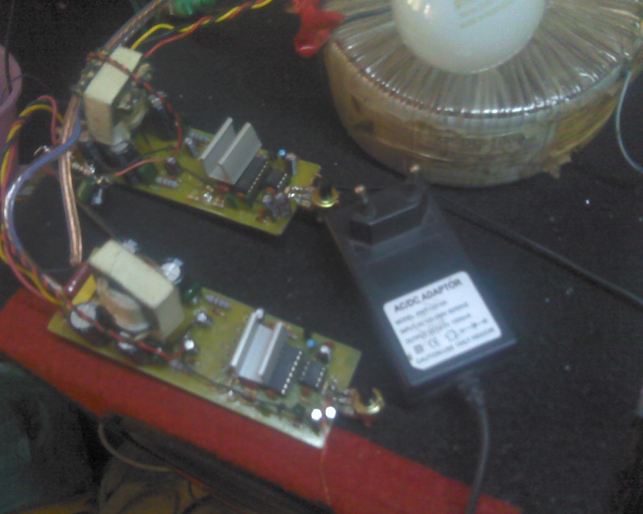

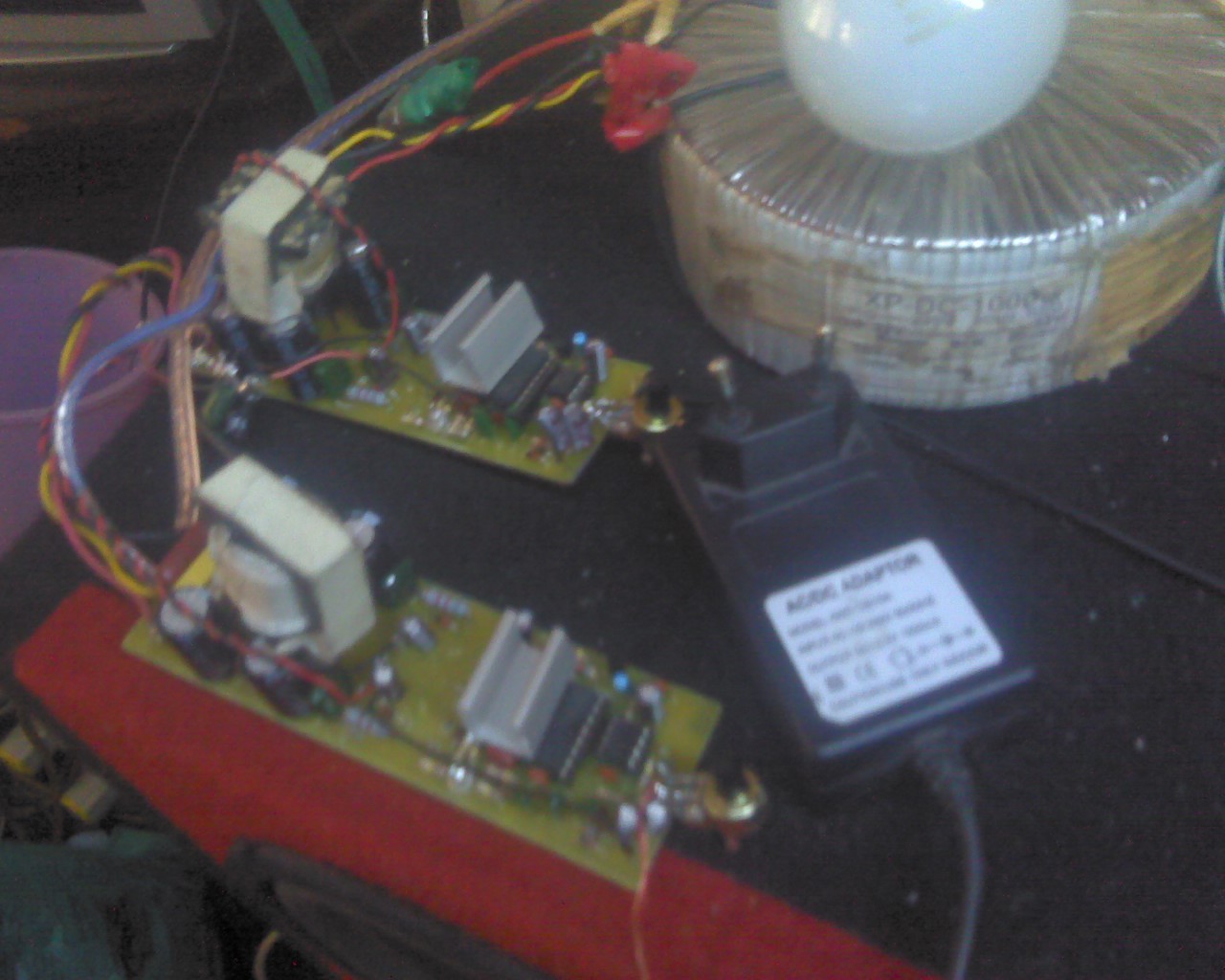

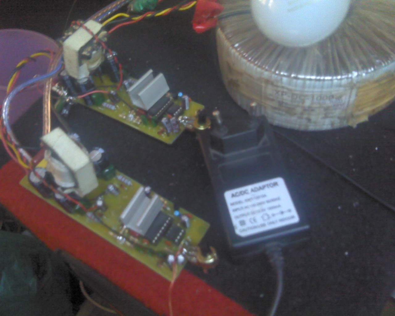

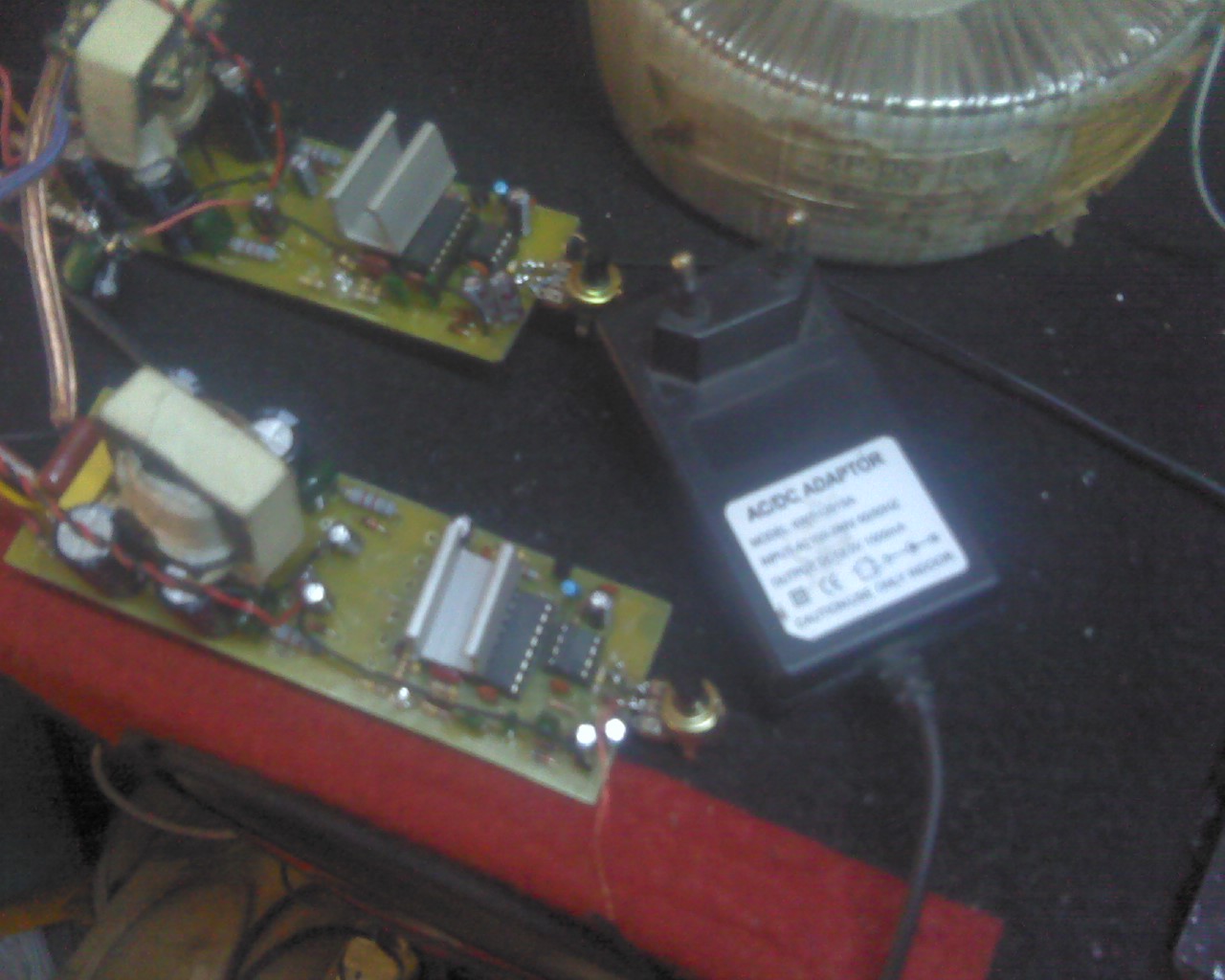

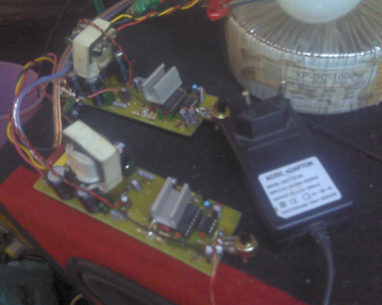

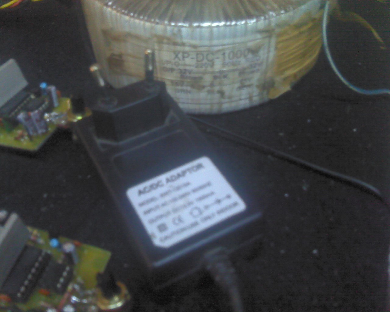

in my irs900d the ir2110 ic heats up , until i have placed a heatsink on top of the ic with superglue.
i have two channels and i am using one adapter of 12vlts to serve both channels .
but i have no noise issues and the amp is clear . the main voltage is +/-45vlts gate resistors are 100ohms output fets are irfp250n they are cool even though i have not mounted them on a heat sink. when i push the amp real hard at that voltage the outputs only warm up a little.
i will juice it up to +/- 80vlts

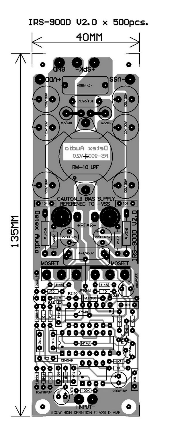

ucd 25 watts to 1200 watts using 2 mosfets pg 218 ab722e449ca921e4.jpg263.3 KB · Views: 905
Hi Hadi,
mistake:
do not use Lm7812 for TTL ics (74HC04) it is LM7806 or LM7805 otherwise it will damage. re check IC damaged or not.
how much turns for T106-2?? picture shows @ 80 Turns is it? you can reduced to 59 turns.
connected power supply not mentioned(no picture)
Regards
MANOJ

Hi sir manoj
yes 80 turn
i have resistors 820 ohm and 680 ohm with 1% telorance for changhe the FREQ
i use LM7806 like your shematic in board
i whant use LM7812 for bias section not in the board
amp is alive and TTL IC is work good
how can i change the curent option on your board?
yes 80 turn

stewin what is your inductor value?
20turns in the ee core from pc power supply with 3mm gap in the center
