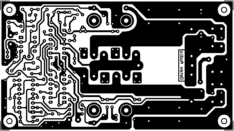

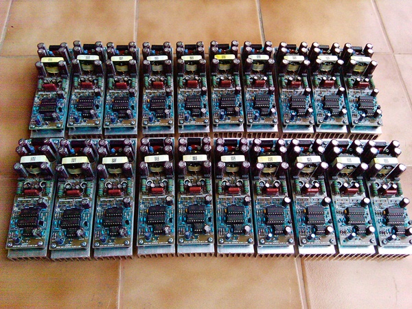

Thienchay, nice spacing you got there, it looks like you are using different parts is it a modified version? any plans on sharing the bottom artwork for toner transfer?😛

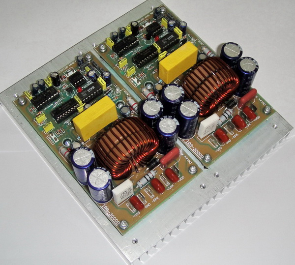

Hi all!,
I wonder if anyone of you had a clearer resolution of the pdf file for DIY share, using Detex IRS900, I have the Detex artwork but I don't think it is going to be successful on laser toner transfer, the image is so poor 🙁

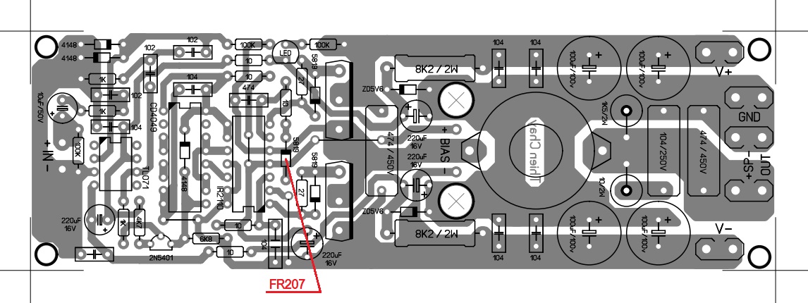

Hi 🙂
This is my PCB file .

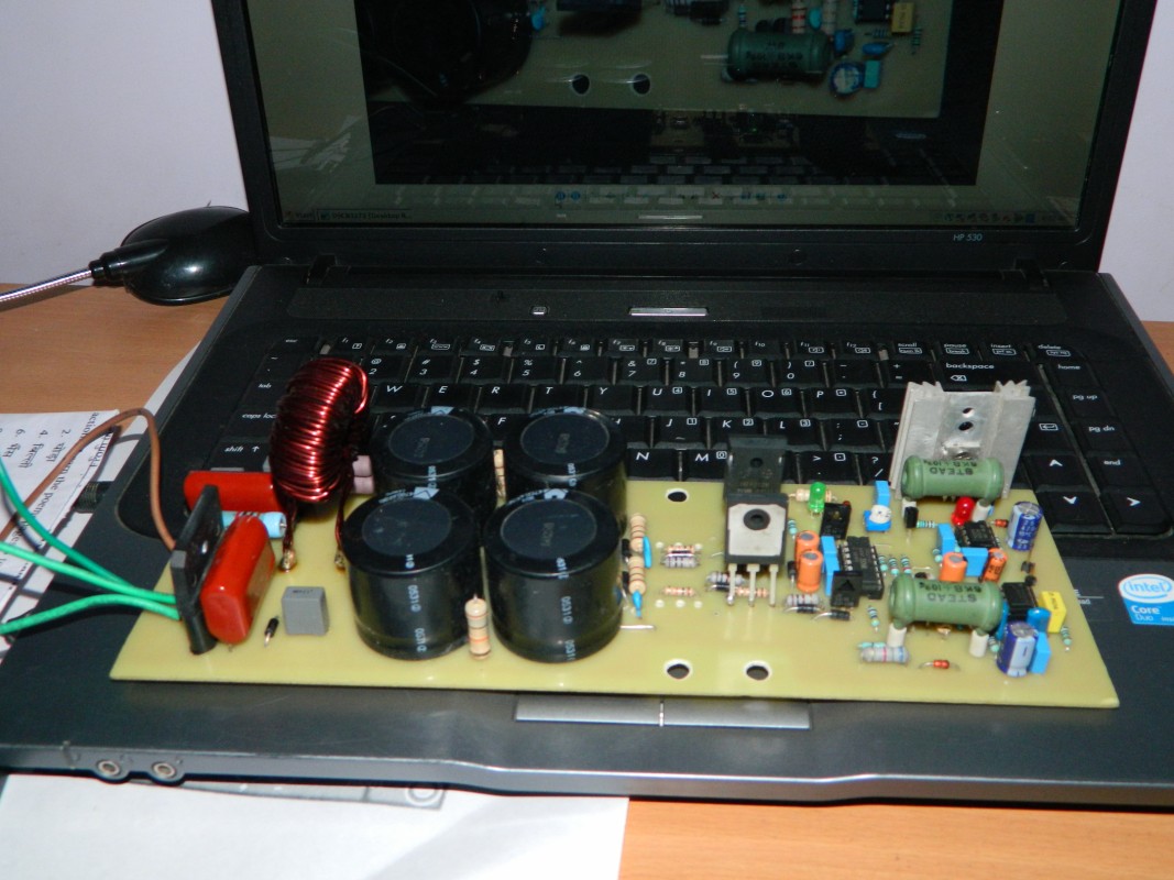

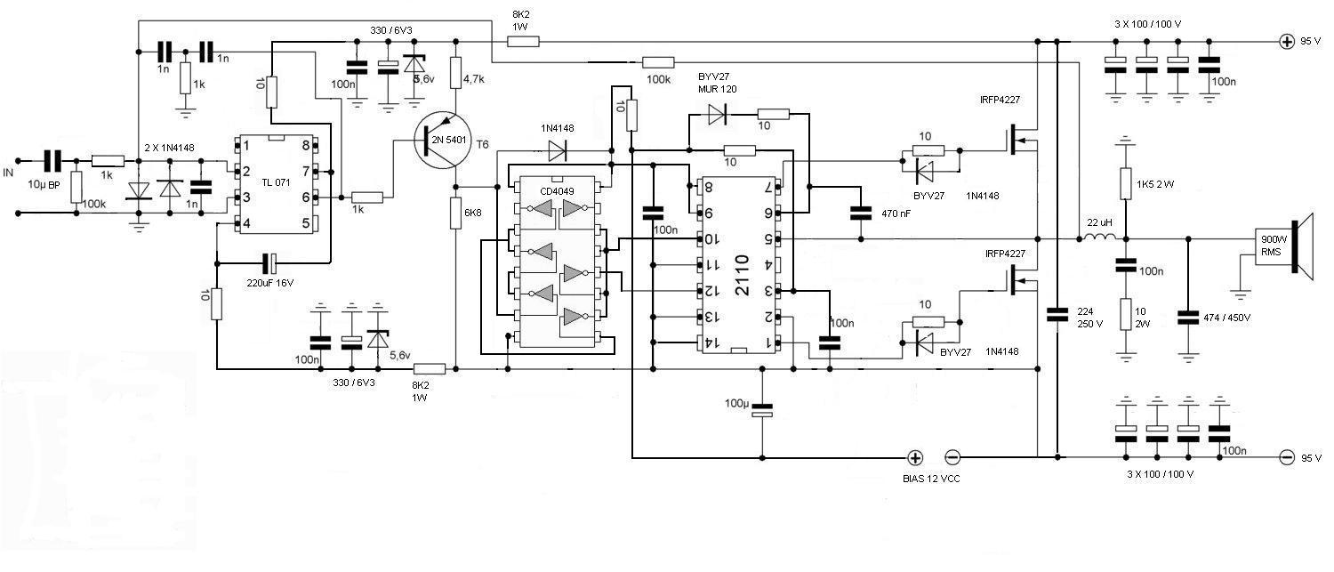

Hey everyone, watch this topic recently and after a week I built myself a Class D amplifier
Amplifier is functional but the problem is that heat the transistors of the differential and constant current generator.Heat to 55-60 degrees.
I used 4x2N5401.
Mention that the amplifier was tested at a voltage 2x45Vcc
Finally amplifier will work on 2x63Vcc
This amp I will use an active subwoofer 300W/4R.
I apologize for linguistic mistakes, do not know English.

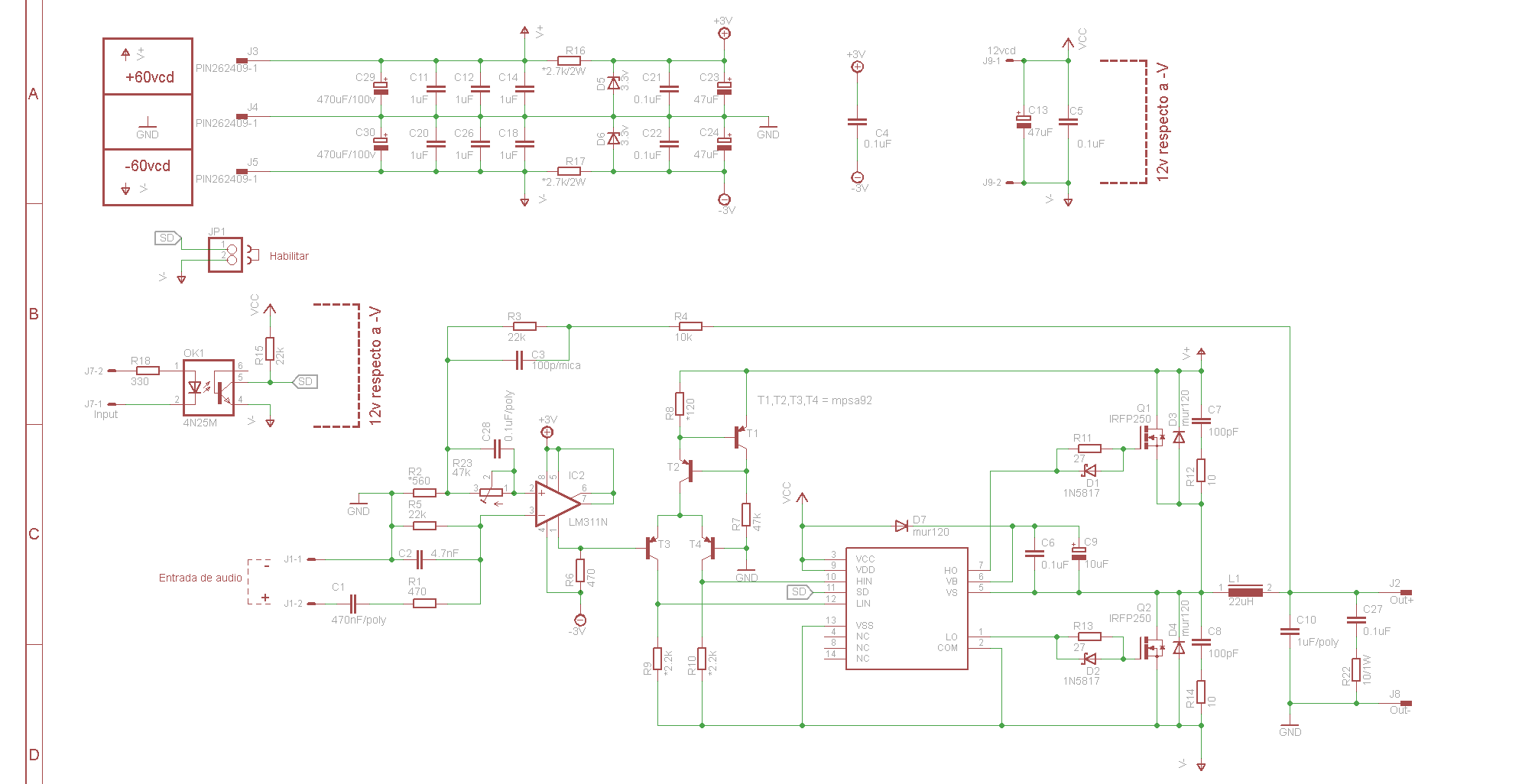

Schematic is here.

thanks thienchay. what about the schematic?
Hi

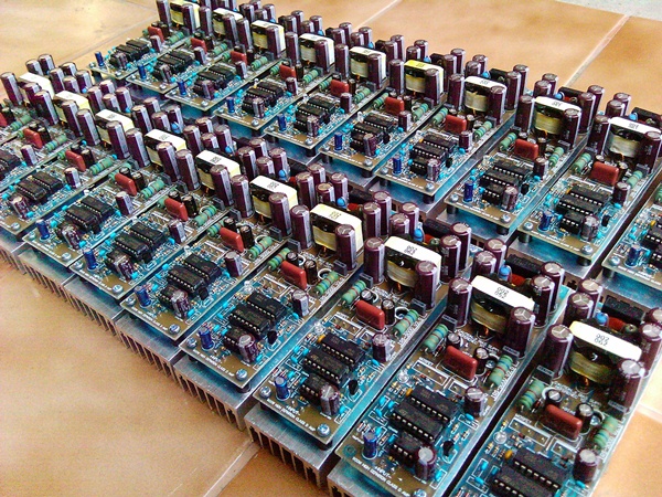

I not yet had time to do it ,but i think can be confident in this schematic and layout .
I draw the PCB Layout when looking at pictures of them (Detex Audio) , i see they produce a lot , so i think can confident .

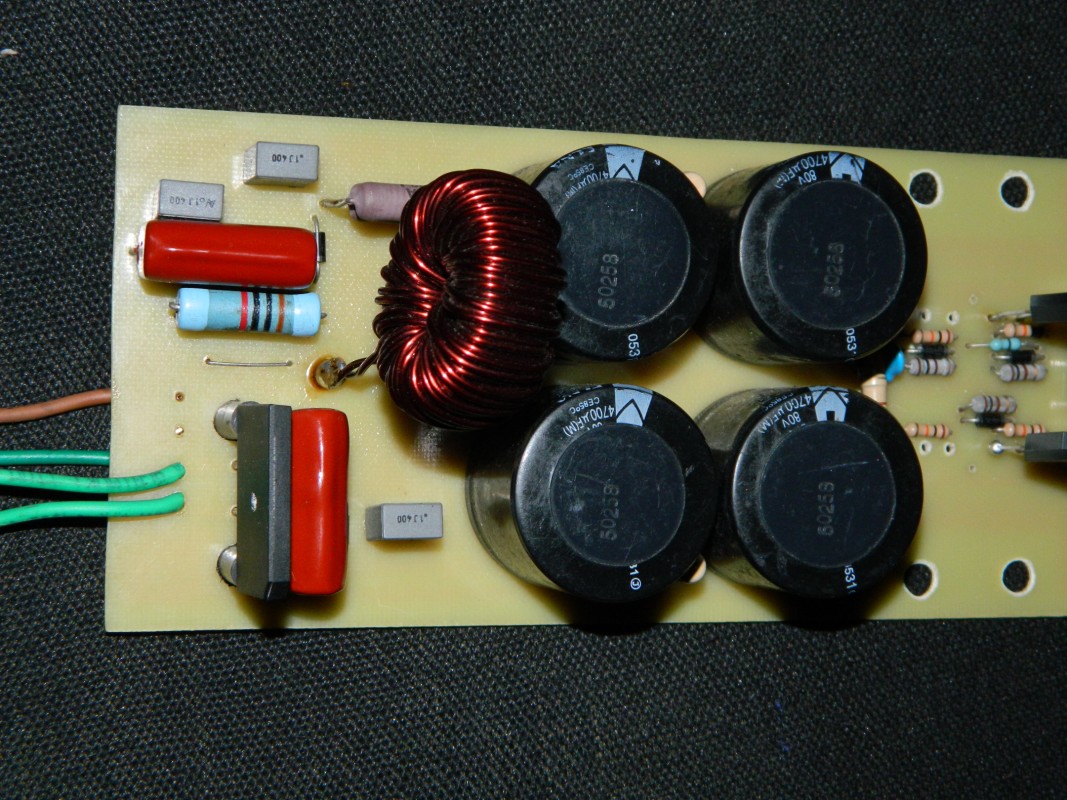

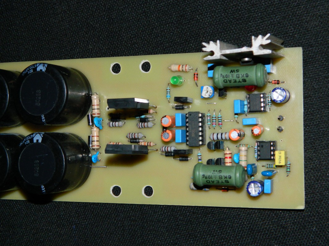

This is some pictures of Detex Audio .

andrew,
this is the one i used for ejtagle circuit, almost 180uH, 50turns #18 wire 27mm OD for the core, but it was factory wound core. a friend charge me a couple of bucks for the windings, he had a small company dealing with transformer.
thanks to mr. tagle for his circuit, i learn a lot of basics from this...
thienchay! you are very helpful...😉 One more thing I see you are using 1N5819 (schottky barrier rectifiers) and 27ohms gate resistors (original was 10ohm). What type of MosFET are you using and at what rail voltage?...
Cheers!😎
I'm used IRFP460 , schottky Diode is better , and R gate i using 22 ohm 🙂
Sorry All , diode boostrap is FR207 or Diode has Vrrm >= Vcc .

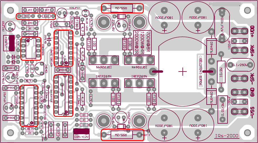

And this is my last check .
