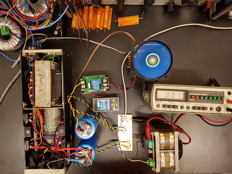

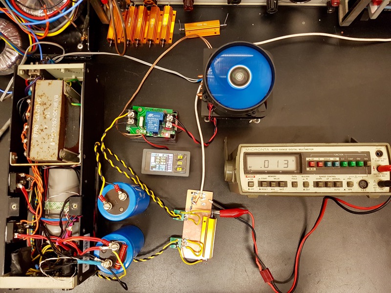

Hi Eric
Here is a shark repellent for you.
Download holes template from spec sheet of all chokes from your wish list.
1. Trace and drill those holes to your PS chassis.
2. Buy 3 x 1 Ohm 100W gold resistor (1$ each eBay)
3. Replace L with R = 0.3 or 0.5 or 1...
4. Input shorted to ground via small non polar cap 1-2 uF..., bias IDQ within safety margin (FBSOA spec sheet of your 3 legged device) and listen for any 120 Hz hum.
5. No hum, you are done.
Cheers

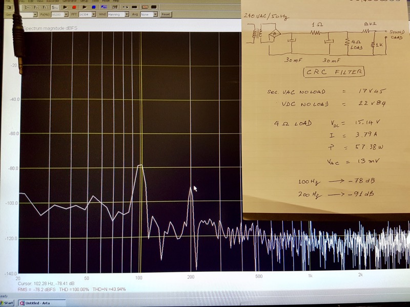

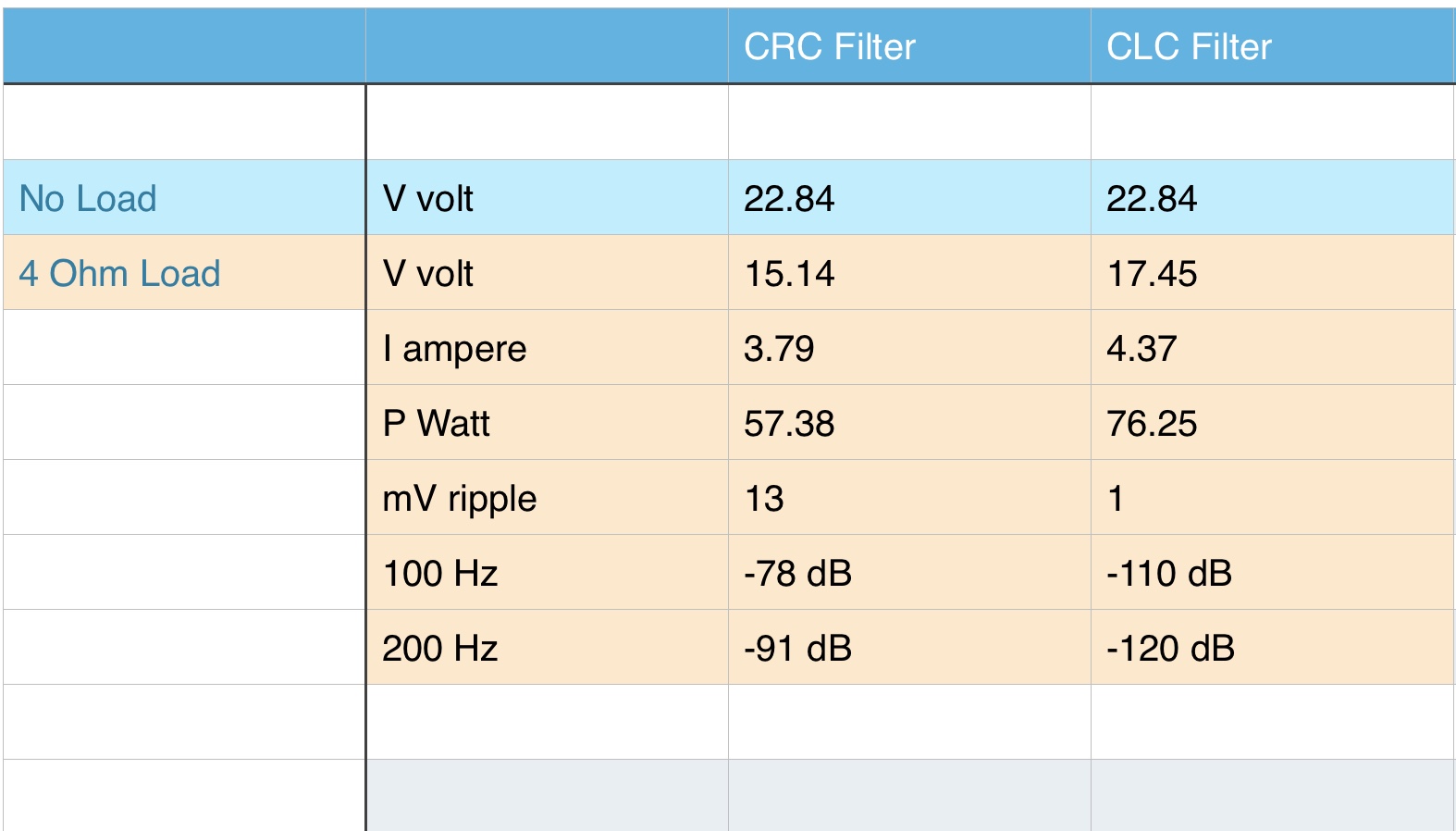

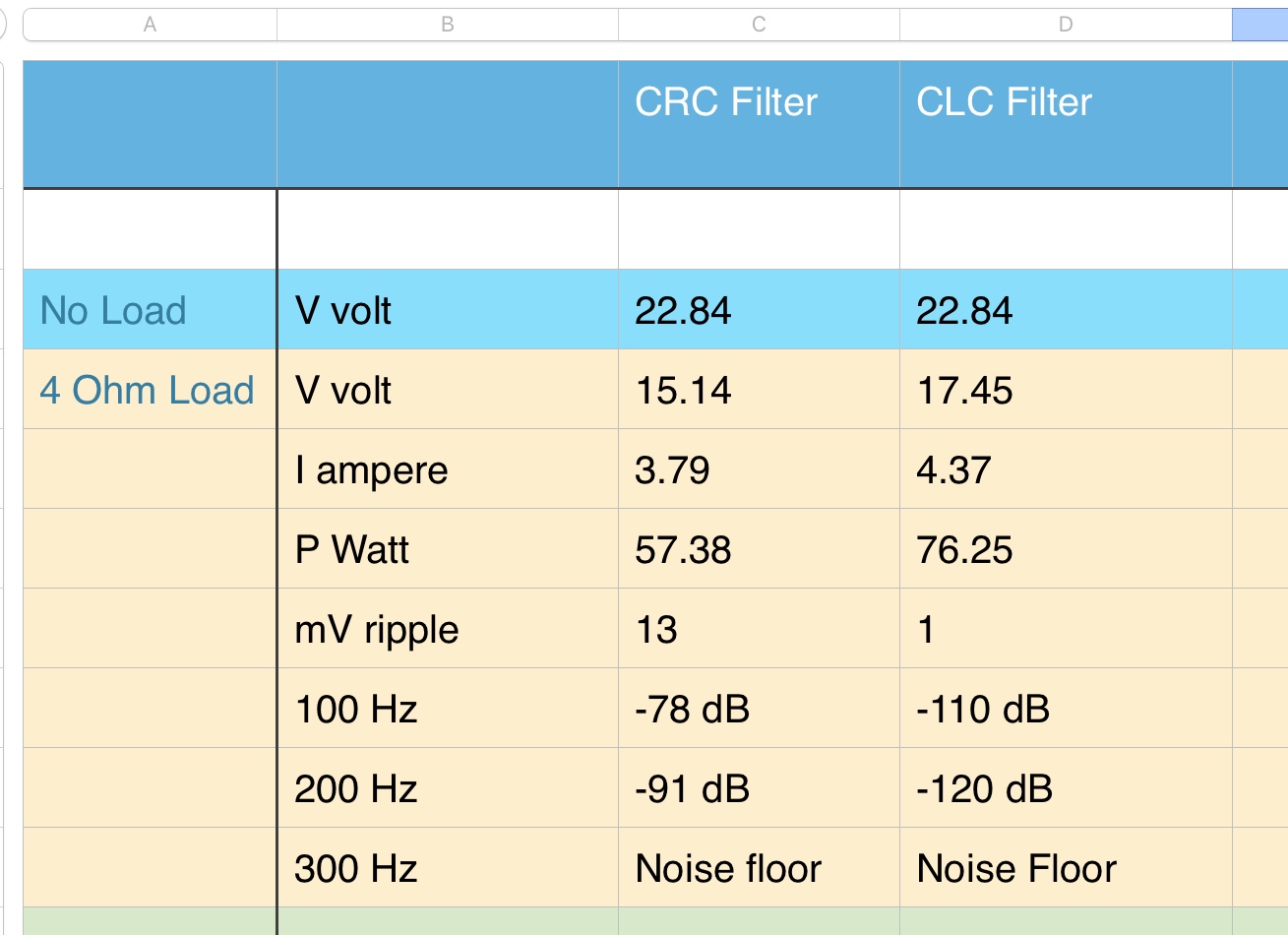

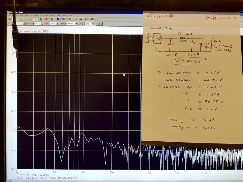

Usually we see lots of odd mains harmonics. Often the odds are worse than the evens. Sometimes the evens are missing completely.
Your results omit the odds.
Why?
Oops, my apology, omitted in above tests due to my old age sighting.
Here is the updated spread sheet with 300Hz spur included.
Thanks for your comment.
Cheers

I was not asking for confirmation of a zero result.
I asked "WHY" are the odd harmonics omitted.
Have a look at post81.
Hi Andrew,
Perhaps I misunderstood or not thoroughly comprehended your question.
To reply to your WHY, I think the odds are:
1. Omitted due to my visual acuity.
2. Omitted due to my crappy 10yo+ PC, unable to keep up with decent sampling rate, anything below -100 dBv is irrelevant to me.
3. Omitted by the filter, low pass cut-off by design.
4. All test done in my chook shed is qualitative and comparative, I never bother nor able to measure of how much is -70dBv, for power supply evaluation, according to my condition, 100Hz spur below -70dB is acceptable.
That’s all I can think off, for more answers you should post it in the Power Supply section.
Here we are discussing about which L for CLC topo, all results that I posted had purposely to convince Eric to spend only 3 bucks for CRC, good enough to supply any FW amps, money saving is much better spent on Tokin SITs, for an absolute high fidelity which is stood out of the mosfet Lundahl’s crowd.
