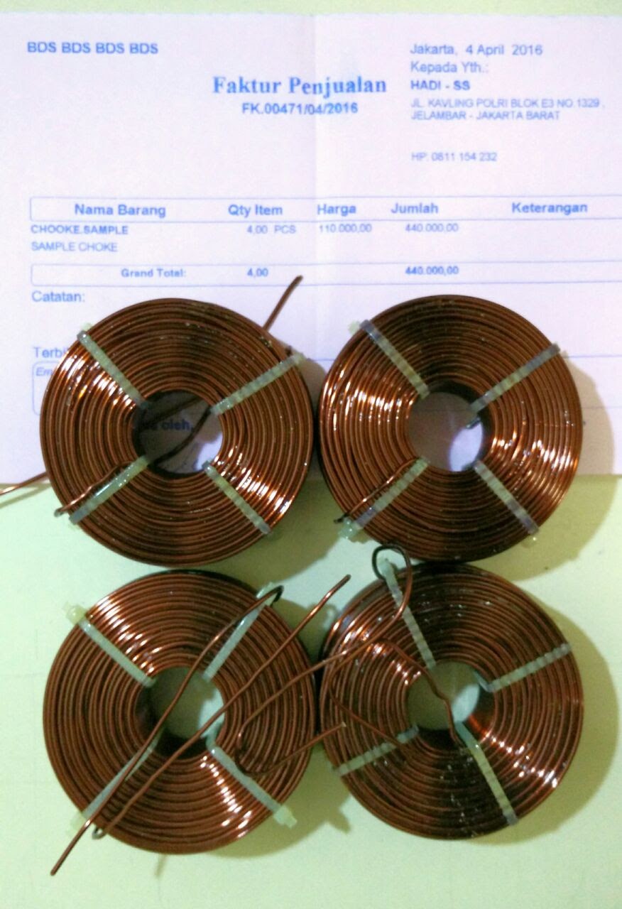

get your local winder and you'll save a lot of money. i paid around $35 for 4 air core 3mH 18awg (or 16awg, forgot it) 0.5Rdc

Our member in Indonesia got some air coils. Which can be easy to source. But I think in his country you could walk into a local store and when they are not busy they will just do it. In the western world they will not be interested to much if you just walk in to a company with such s simple request.

...Our member in Indonesia got some air coils. Which can be easy to source. But I think in his country you could walk into a local store and when they are not busy they will just do it. In the western world they will not be interested to much if you just walk in to a company with such s simple request. ...
Problem in Indonesia is lack of local availability of decent quality cores and magnet wires. Small transformer makers are hampered in making audio grade parts by the lack of demand and high initial investment of decent material. We highly appreciate any info you can share on sources of good core and wire material that will supply in small quantity.
