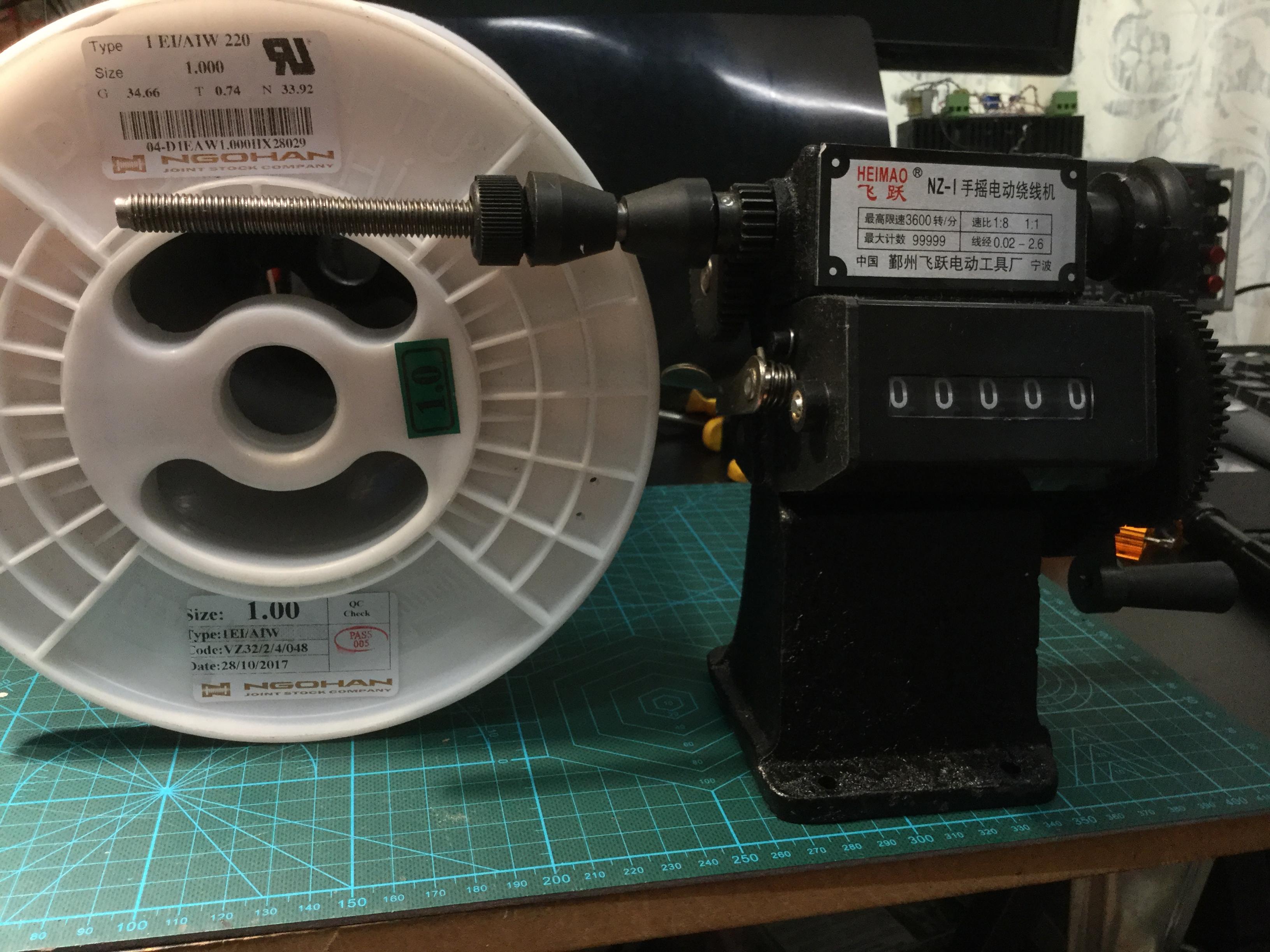

Having had only one day in VN, not enough time to visit the outsiders of that famous hospital to admire Mr Tho chef d’œuvres class A amp, I was as pillion passenger for 2 hours on “ Uber Ride” to the Saigon “chợ điện tử” (electronics market), guided by the rider, for a roll of 1mm copper (so excited by the price that make me forgotten of how much I spent) and a Chinese made hand winder (16 Au$).

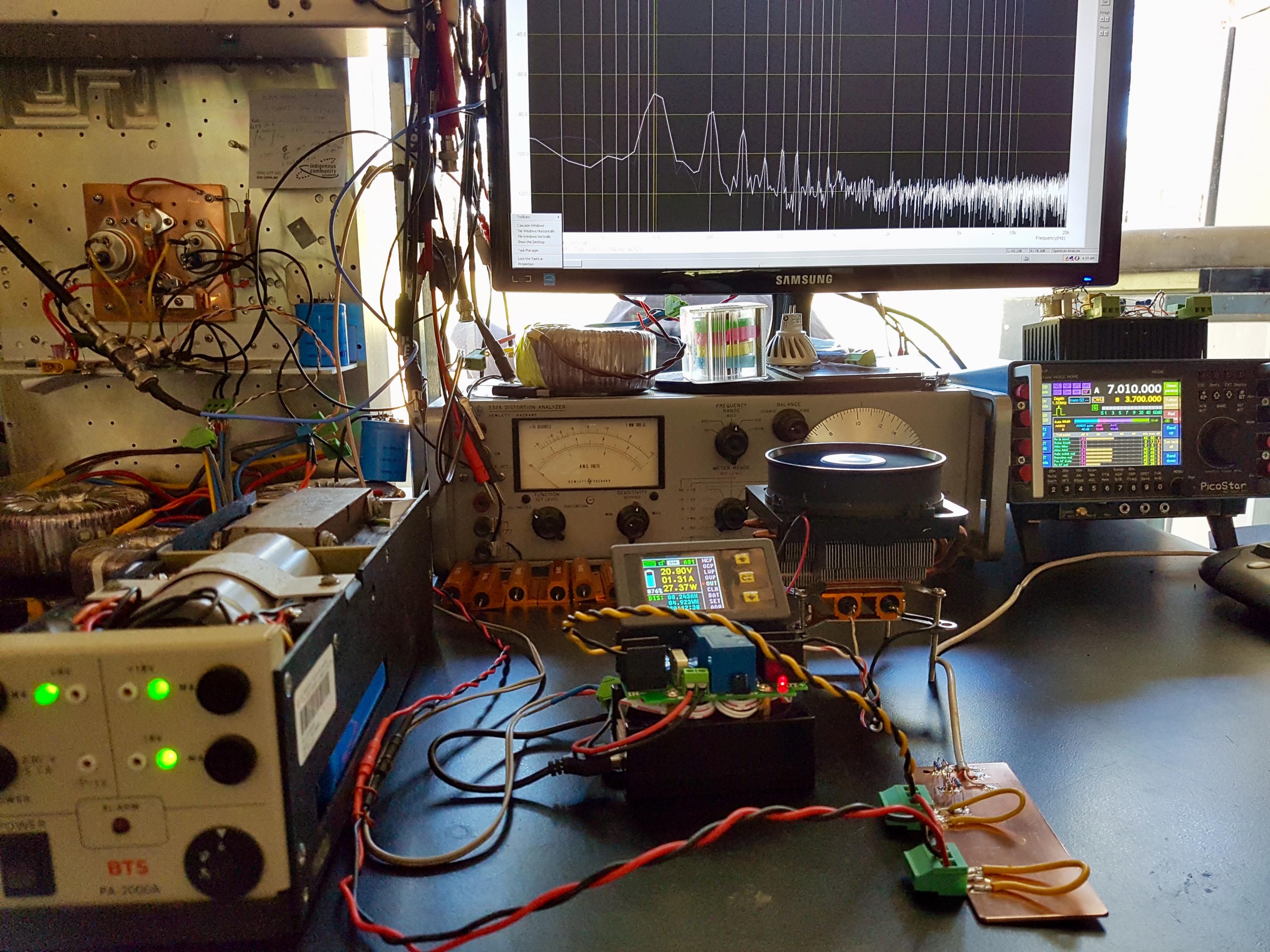

By the way, is there any simple procedure for a qualitatively recording the performance of PS filtering (LC, CLC, CRC...etc).

Well, I have to show you how I evaluate my PS, otherwise this thread is going down to a rabbit hole as commented by one reader.
My setup for PS filter evaluation
Soundcard and SA software.
Dummy load, chosen as close as possible to R load.
Current, voltage and power monitoring
Voltage divider and Zener diodes for soundcard protection.
HF radio receiver for EMI detection (SMPS)
Cheers from Pascal
