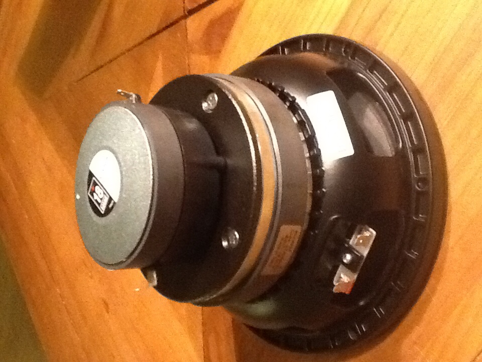

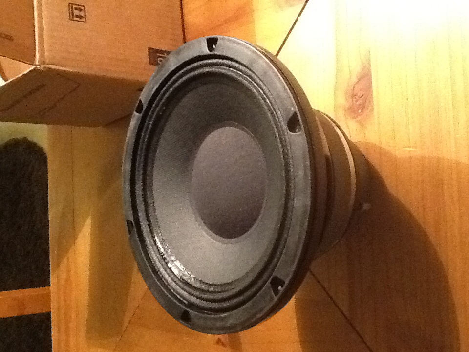

I got the transducers (after quite a long waiting) and I can continue my project. The 18Sound coaxials look nice and I suppose (hope) the sound quality is OK. Does anyone have experience on these?
That's a really wierd looking driver... does the tweeter fire through the rear of the woofer???
Certainly an interesting solution, can't say I'm a big fan of the concept but it could be counter-intuitive (i.e. work a lot better than expected!)

Cute looking driver!Some trouble with iPad when posting attachments...

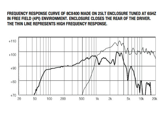

With the additional mid band gain your waveguide will provide (around 4 dB from 200-1000 Hz) the crossover will be "interesting".
Much easier to cross with DSP, as the upper midrange of the woofer has some pronounced frequency response peaks, and flattening out the mid range passively would require a lot of attenuation.

DSP would make it easier though, or going hybrid with passive crossovers but using DSP to fix the global response.
Thanks for the comments! Yes, the driver is cute and the quality looks very good. I still have ambition to try passive Xover but if it is difficult then DSP or passive with DSP. I'll do the first trials during the weekend.

Erkki has done the relatively easy part (building the box) getting the crossover right passively is not at all easy with the response curves of the drivers used.

Yes, and there still is the matter of optimizing the box tuning (volume, ports) before I even dare to touch the xover issue 😱 Perhaps I just do it with DSP.
DSP would be a much easier proposition, even if you have several kilos of a wide variety of crossover parts at your disposal, and several weeks of time to experiment with them 🙂.Yes, and there still is the matter of optimizing the box tuning (volume, ports) before I even dare to touch the xover issue 😱 Perhaps I just do it with DSP.
Not sure what you mean; that's a pretty typical, time-honored arrangement. Look at an Altec 604, or the Tannoy dual concentrics, for example. The 604 has a separate horn, but the Tannoys use the woofer cone as the high frequency horn.
Rather common actually. The small tweeter horn, or fart tube as I like to call them is behind the dustcap. If it is really short the cone does most of the horn function, as Francis mentioned.
If you have access to DSP but still want passive xovers then one thing that should work ( when I get my xover-parts I can confirm if it does ) is to first use light global DSP to fix response and apply the crossover slopes you want to get the response you want.
Then measure the woofer and compression driver separately with and without the crossover slope. Measure impedance, then hook up some simulation software and play around with components until you get the raw driver response into the crossed driver response. Then you shouldn't have to worry about acoustical offset and such in the simulation software.
