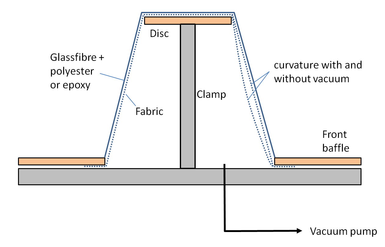

I reckon that a really easy way of making horns and flares would be to stretch a cloth across that box like yours, and setting overall positions/shape geometry with a temporary central disc/shape, and then doping that cloth to create a rigid form, ready for back filling with polyester resin/glass fibre.
Custom straight flares really easily.
Dan.
Exactly like that. I am still thinking of doing elliptical waveguide using nylon cloth in the way you describe above.
I'm also thinking that applying a finely controllable vacuum (or pressure) whilst doing the initial doping process would be the icing on the cake....curved flares instead of straight flares.
A thin sprayed film of clear laquer would likely provide flexible and sufficient air sealing during shape forming and be the initial doping, and then apply a stronger resin to achieve mechanically stronger doping.
I have done perspex blowing in the past....the above idea is not too far removed, but would be far easier....and semi final tweakable.
With perspex blowing you get exactly one go to get it right, and perfectly reproducible is not easy/possible.

I'm also thinking that applying a finely controllable vacuum...
Dan.
Hmm.. not impossible. You need precisely controlled vacuum but that can be achieved quite easily. Rapidly curing polyester (about 15 min work time) would also make the process easier.

Below is an arrangement that should work (without making a mould as I have done). We do not know yet if one could control the curvature with vacuum but it shouldn't be impossible.
Nylon or PE fabric would be suitable materials because they are elastic. Epoxy and polyester do not stick to these materials and the fabric can be torn off easily from the surface after the resin has set. However, the fabric passes air through and thus it would be possible to get high quality surface with this method.

Curvature is done two ways. 1. Shape of the curve and 2. Depth of draw. Material thickness is important so not to over thin as it stretches ever thinner. Each material has its limits as to how far it will withstand before a hole forms. Acetate film is used alot due to convenience, cost and known fairly manageable characteristics. Smaller parts can be done in an average oven.Below is an arrangement that should work (without making a mould as I have done). We do not know yet if one could control the curvature with vacuum but it shouldn't be impossible.

To make a horn like flare the material can be anchored from the center and then clamped to the former opening. Vacuum applied draws the sides in. Example Think of a vacuum box and it's opening. The material is attatched to the inside edge of the cutout. Now in the center is a wooden dowel that protrudes up and out of the box in the center. this pokes the material up like a tent. Apply vacuum. In this case the transitional roundover would be on the inside edge of the top plate. Can be done with both cloth and plastics. Plastics are easier. Cloth also requires it to be precut to shape.
To do with acetate plastic covers the opening eg top plate. Put a small marker spot in the center. Placed in an oven and removed once heated to proper temp/time. Remove and place marker dot on dowel. Dowel itself is rounded over on the end. Press down with even steady force as the plastic stretches. Once down clamp base to seal. Vacuum on til proper draw is formed, then off til cool, release vacuum and remove. There is very little time to do all this and is not something you will master even the first few times out.
Pole can be done externally and plastic pushed into a deeper vacuum box. With plastic attached from the outside edge, roundover transistion outside inward
