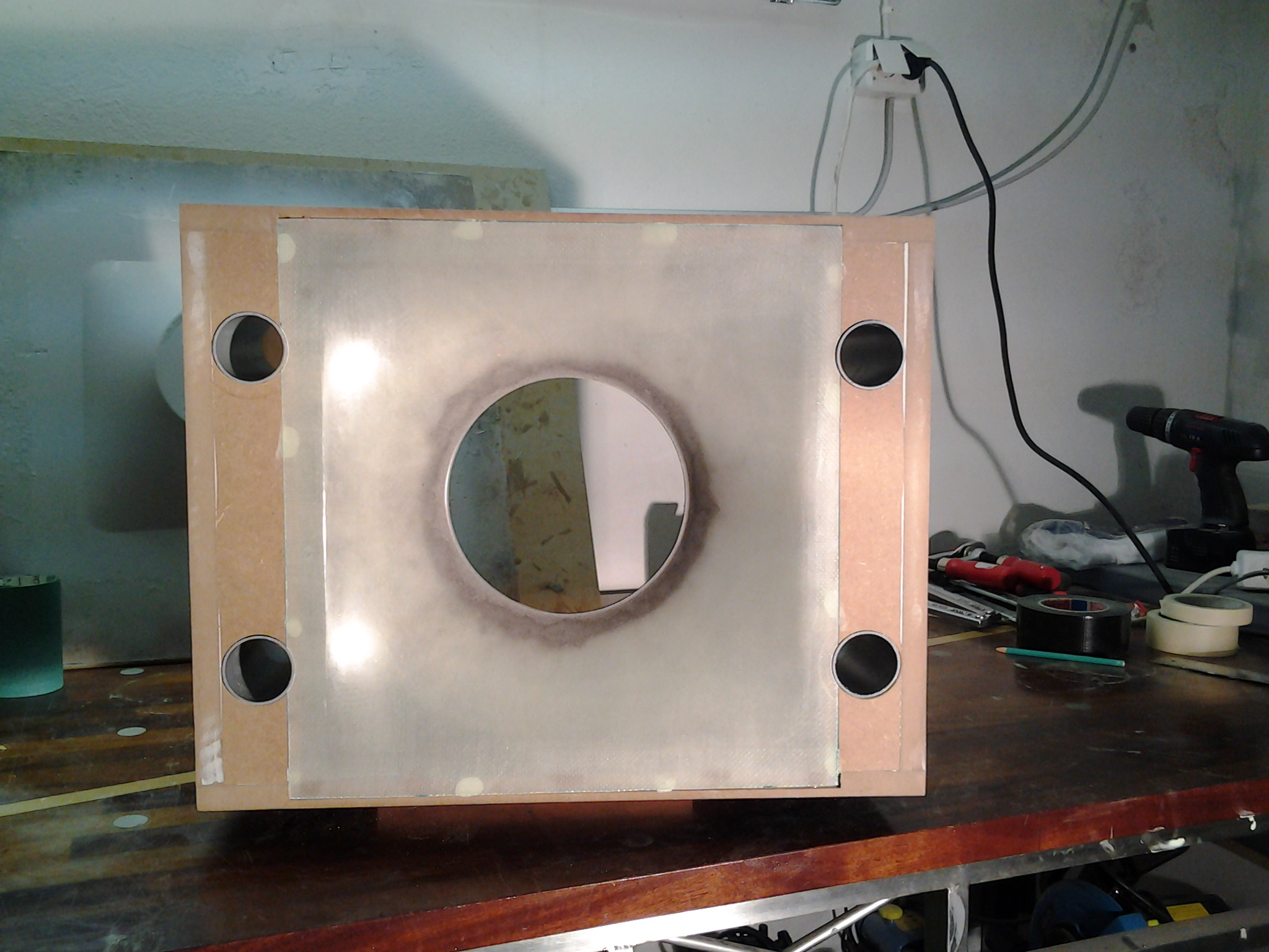

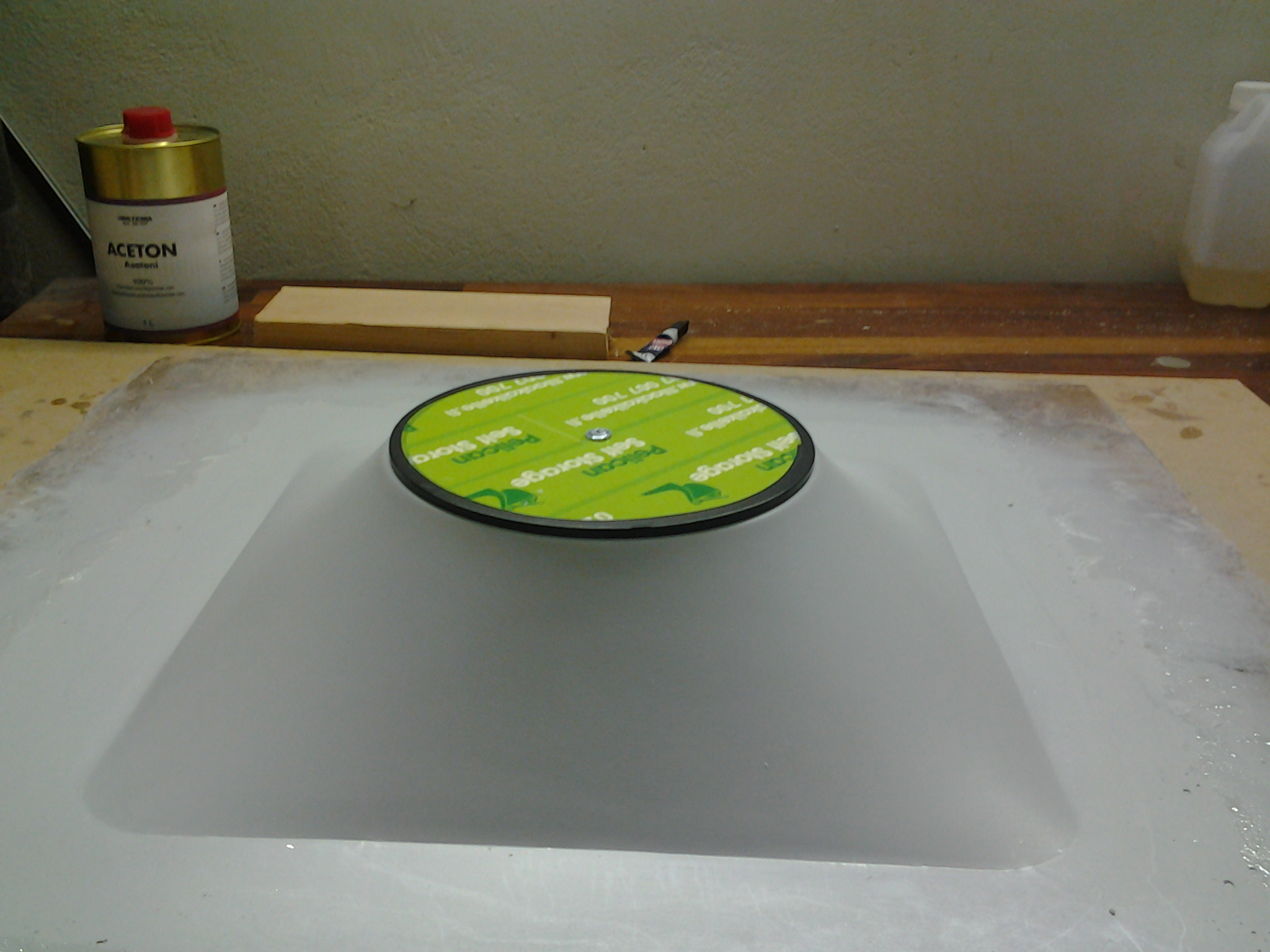

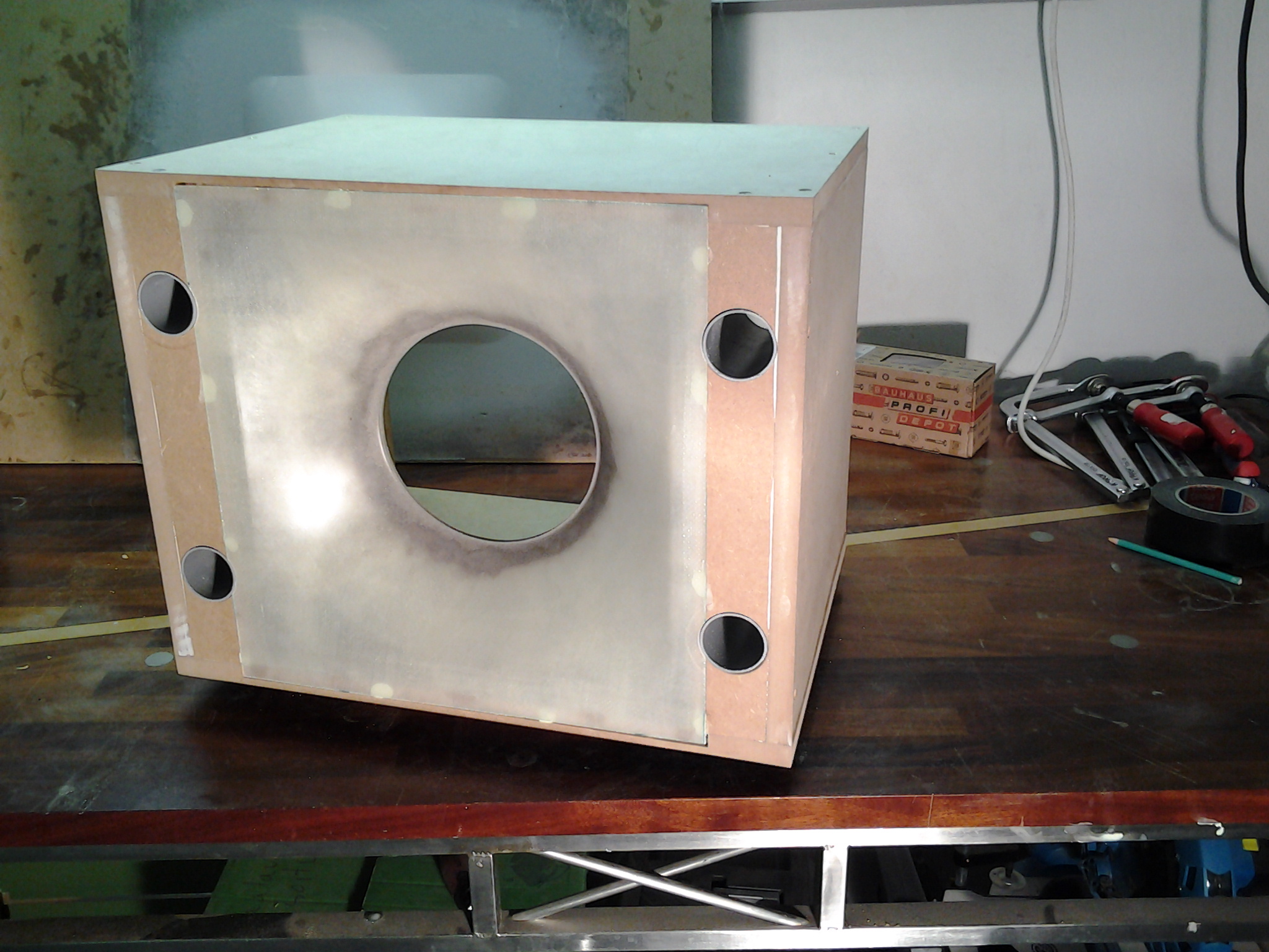

About the polyester fabric method you mentioned; it was suggested here that elliptical mouth shape could be superior to rectangular, so I might make an elliptical waveguide using the fabric method.
Here are some new pictures... It was a bit difficult to cut the opening for the driver precisely to the center. I made the openings to the last two waveguides during molding:
A disc is attached precisely to the center. Epoxy-microballoon mixture and cloth is laminated around the disc...
...and now there is an opening exactly in the center. Driver support must be attached later.

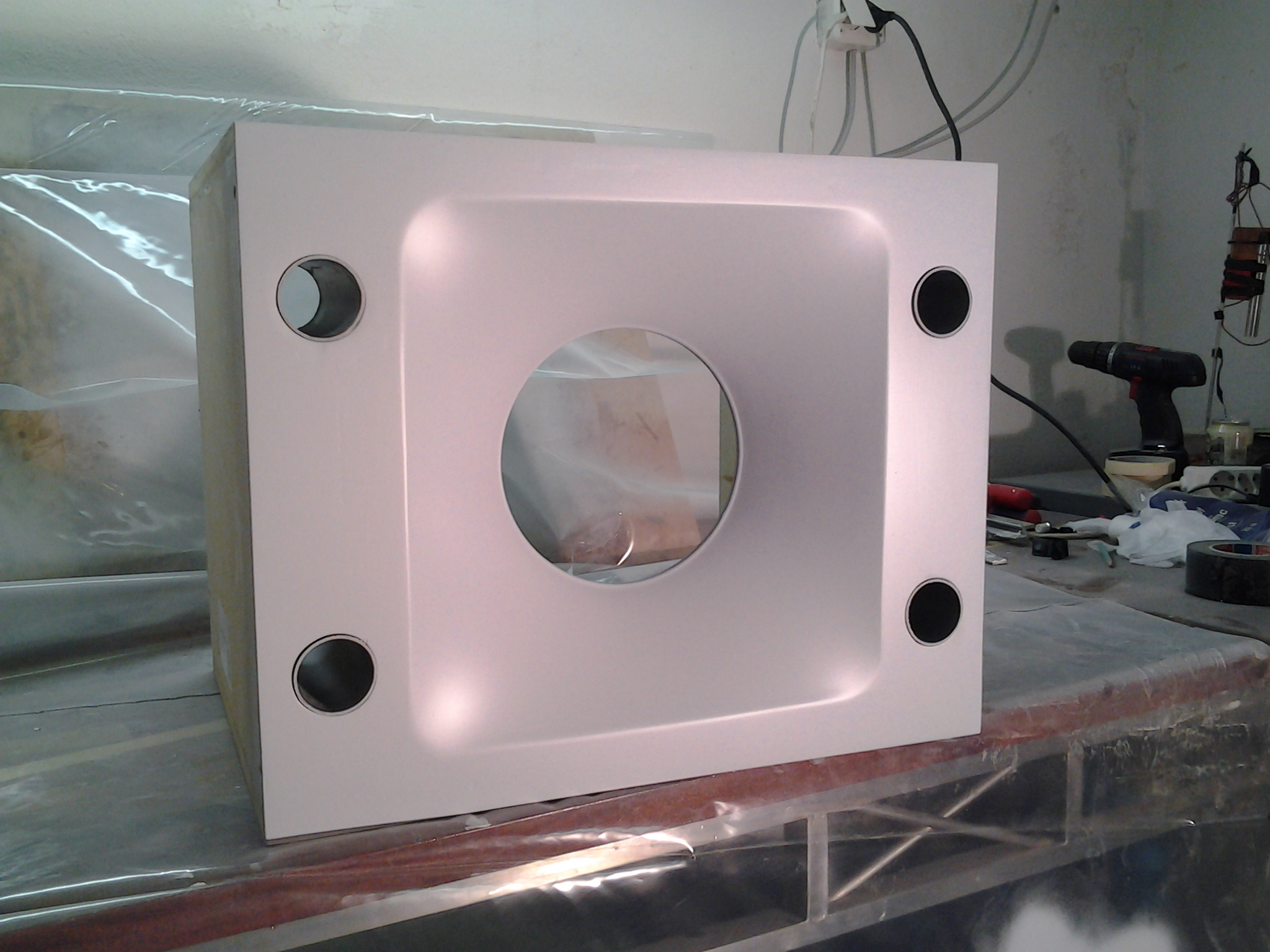

Thanks! I'll start building the enclosures tomorrow. I am considering if I should build a prototype or two before the final version. Perhaps I should test different volumes and port size and try to match the tuning with the gain caused by waveguide.
I can paint the prototypes purple but that colour has very bad effect on WAF... 🙄
Get her very dark sunglasses? 😀
🙄 I let her decide color... She is permissive and lets me do almost whatever I want. She actually likes this hobby, I made her a pair of small fullrange speakers from concrete an she likes they fit very well into our living room.
LOL, Your product looks good, really good.Painting while waiting the drivers... Looks like an old television with exploded tube 😀

I reckon that a really easy way of making horns and flares would be to stretch a cloth across that box like yours, and setting overall positions/shape geometry with a temporary central disc/shape, and then doping that cloth to create a rigid form, ready for back filling with polyester resin/glass fibre.
Custom straight flares really easily.
