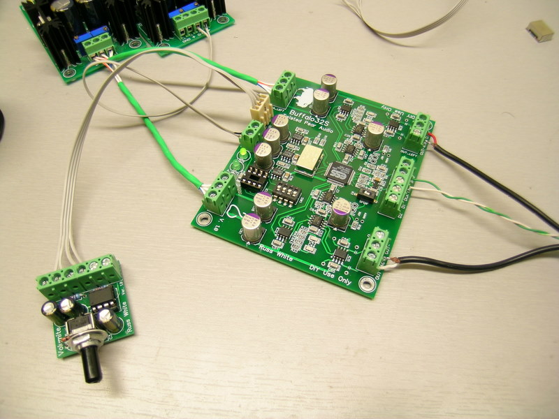

Is it (on a easy way) possible to bypass the integrated I/V and use another I/V on the first coming version of the Buffalo32S?
I now use a Zapfilter I/V and i would like to compare wich buffer i prefer.
Or is it then better to wait for 'tweak version'

since the Buffalo 32s now includes an integrated i/v, do I still need something like the counterpoint or not? I am a bit confused......

No, you don't need the Counterpoint for that.
so, you just need the buffalo 32s and connect it straight to the output rca's/xlr's (with or without an output cap)?

Yes, the Buffalo32S can simply be wired to the output jacks. There is virtually no DC offset so no cap required.
Cheers!
Russ

I can't really say if you will get a thump (SE) or not, as it will depend on what you have after the I/V stage.
What I can say is that balanced out it is pretty well behaved with only a small transient on turn off.
What I observed was that when I had the I/V stage directly connected to a power amp connected single ended, I got a pretty large transient. That is why I am being cautious with people and recommending they only use it for balanced output. But this is DIY. Other folks may find it works fine single ended for them. I am hoping as more people use the circuit I can get some feedback on how to make it better. Sound wise, it is awesome.
Cheers!
Russ
