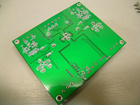

Also, you can't see it from the picture, but there are a lot of parts on the bottom of the board. The original Buffalo had a single cap. This makes building the boards a lot more tricky, so we will likely send them out to be assembled. An estimate of this cost is included in the posted pricing, but again, will likely change a bit.

Can't wait till you guys start shipping/accepting orders. I check the site and this board every single day. Can you post a picture of the underside of the Buffalo 32 board to show us the complexity you mentioned previously?

How are you dealing with soldering components on the back? I do it too, but find that stenciling the bottom after having soldered the top is a pain. It's largely feasible, in fact I never missed any, but it really requires to calm down. Plus the Sabre32 isn't that easy to precisely place, surface tension will put it approximately in place, mine drifted a little bit (something like 0.1mm though) and it scared me a bit. But it's fine, anyway. It requires some skills.
Happy yours already outputs sounds, I haven't sent sound in mine yet, just soldered and verified it.
