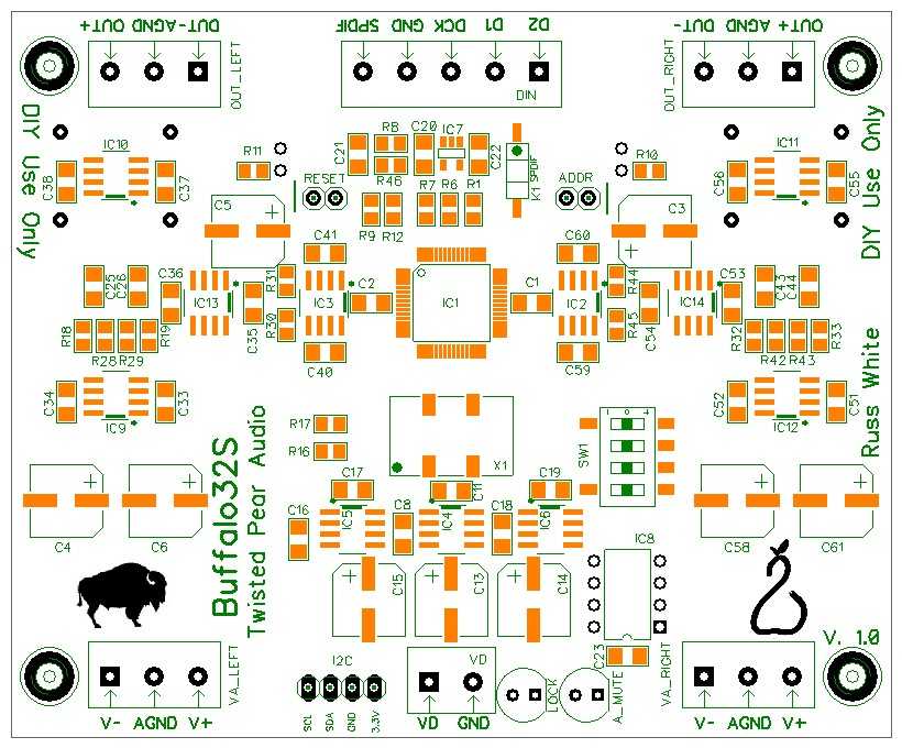

Re: sneak peak of BUF32S
Very nice!. But don't see local regulators or voltage references for VD. I guess I'll have to wait for the schematics...
Russ White said:Here it is, this is just the top side.
Re: Re: sneak peak of BUF32S
To my noob eyes it looks like the power supplies might be buffered by ICs 4, 5 and 6. Regulators are probably under the board near those.
glt said:Very nice!. But don't see local regulators or voltage references for VD. I guess I'll have to wait for the schematics...
Re: Re: Re: sneak peak of BUF32S
I was thinking it would be hard to do reflow soldering on both sides... (my common sense tells me that the components in the bottom will just fall off in the reflow over 🙂 )
Yes, there are components on both sides. 🙂
On the bottom side there are only passives.
Cheers!
Russ

Hi Russ,
Nice looking board!. From the feedback I have been getting on the Sabre32, all your customers are going to blown away with the 32S. I hope to hear this design soon.
Dustin
Dustin
Can't make out from the top layer, but how does the ESS chip get its VA supply now? Is it tapped off the VA supply from the IVY II supply, separately for each channel or something else?
And, there are a LOT more opamps, but no SE output. Eagerly awaiting more details.
