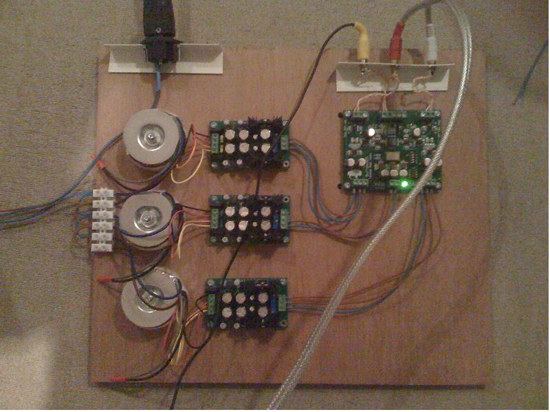

Oh yeh! My buffalo32s arrived last friday after being stuck at someone's desk for about two weeks (who was probably wondering "what the f%^& is this and how much duties should be charged"). Yesterday evening my brother and I build the PSU's and dac. After about 4 hours of work it worked the first time we powered in on.
First impression is along the lines of earlier impressions mentioned above. More detail, less "sharp" treble and very neutral. Very pleasing. It was 01.00 when we finished it so we only got a change to listen very briefly and at a low volume. But it definitely sounds better then the CS4398 based DAC in my Marantz CD6002. That was pretty clear after about 15 minutes of listening.
It's not in a case yet but that will come in the following weeks.
Thanks Russ and Brain! Great product. Very easy to build and very good results.

BrianDonegan said:Cool. Be sure to add the solder jumpers at L1 and L2 on the bottom of the Buf32 board.
We did that and also cut the traces near the outputs. For this quick-and-dirty setup we left out the "thumpbuster" relays. The "thump" you get without them is minimal by the way. I am already wondering how this DAC will sound after a week of burning-in.
Scanspeakman

I don't think it comes with a fuse. What fuse should I use?
2. Am I supposed to do something with the potentiometers on the power supplies?

1) 1A fuse should be fine.
2) Yes, you adjust the voltages to those recommended in the manual with them.
Please be careful. You may want some help.

1A is fine but 500mA works as well. I expect even 250mA to be fine. The DAC does not draw that much.
Nielsio: if you need advice how to adjust the power supplies send me an email lekkerlichaam<apestaart>hotmail<punt>com

Yesterday evening I listened to the Buffalo32s more closely. I found two "disadvantages".
1) CD's with crappy recordings already sounded like crap on my Marantz CD6002 but now they sound even worse....
2) The bass seems to be extended to even lower frequencies; now my couch is sometimes vibrating
More serious: this DAC is brutally detailled. It has been a while since the haires at the back of my neck raised with some live recordings. I can only confirm what other people said before; very good imaging and depth. With great recordings my audio system now really sings! And it is still improving.
