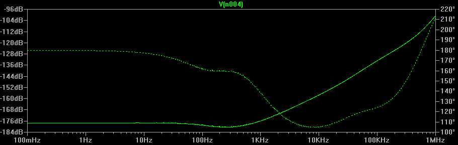

So, for those of you who are wondering. I have not forgot about the "Placid" shunt regulator I started working on about a year ago. I have just been perfecting it.
Here is a simulated FFT of line regulation with input 15V and a 1V sine wave on the input voltage. The output is 3.3V with a supply current of 200ma and a load of 100ma.
I will know very soon if the real thing works. 🙂
As you can see. The PSRR is excellent if the sim is even somehwat close to right.
So for those of you wanting something other than LM317/337. This should be the ticket. 🙂

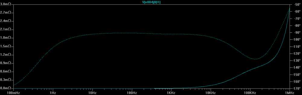

Jean-Charles said:
Good news Russ. I was just wondering.
What will the output imprdance look like?
I was hoping you would see this. 🙂
Here is the output impedance.
Same voltages and current/load as before.
It does equally well at higher voltages btw. Up to 20V or so should be fine.
The solid line is the impednace. The dashed line is phase.
So it practically nothing. The trace/wire impedance will dominate.
