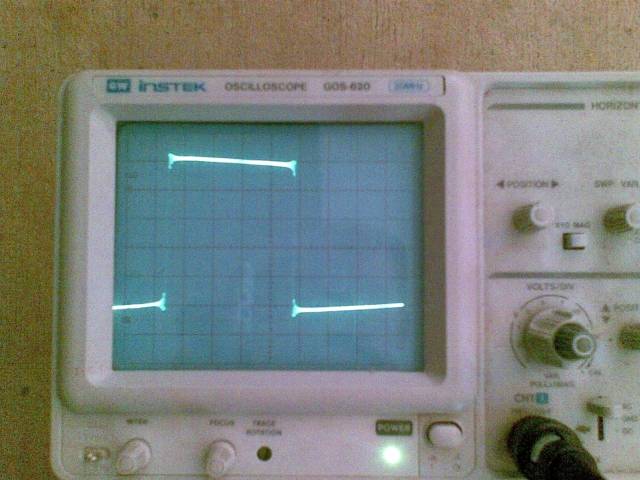

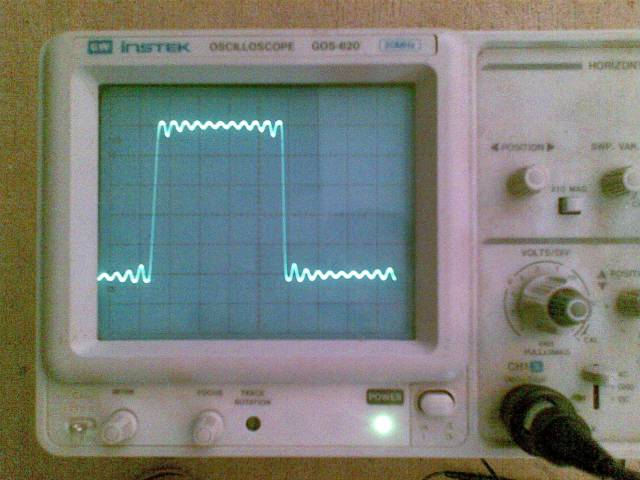

Trying to find out what’s wrong I’ve checked with test CD and scope. Amplitude characteristic is flat like table, 5Vpp from 10Hz up to 21.5kHz. Amazing.
As for impulse response, below square 100Hz and 1kHz (pictures taken with mobile phone🙂.
Any comments?

Ringing
Hello Andy:
Thanks for posting the scope pictures. You have far more ringing on that 1kHz square wave than I would expect to see. There was a previous post on either this thread or one of the original Buffalo threads that showed a much cleaner square wave. Search for "Gibbs" because I think the Gibbs phenomenon was discussed.
How are you conducting the test? What is the amplitude of the input signal waveform? What is the scale of the picture? Where are you placing the probe? What load are you driving? More details will be helpful.
What do your supply voltages look like on the scope? You will have to switch to AC coupling to use measure at high sensitivity.
I will try to put the scope on my Buffalo32S later today or tomorrow for comparison.

Re: Ringing
The signal amplitude, both sine and squre, is 5Vpp, as the result of "0 dB" level recorded at my test CD. The probe is placed at BUF SE output. The load is passive pre AudioSynthesis, ca 15k input/output impedance, further feeding AN monoblocks.
I'm going to take a closer look at psu voltages as you suggest.

Re: Re: Ringing
Heres what I get 1k 0db, SE output
Buffalo32s

Leo,
thanks for checking, looks almost identical, frequency ca 20k; your oscillations amplitude seems to be even bigger comparing to main signal.
