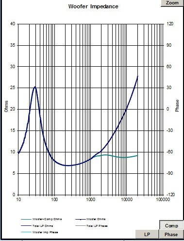

Could an LCR, externally at the speaker connections be used to improve the speaker impedance?

Here's what a CR can do to a woofer impedance. This is with 4uf cap, and 12 ohm resistor. Proper calculations to alter the speaker impedance would likely come up with different values, but the effect could be similar.

It was a rhetorical question. 🙂 I was hoping to draw someone into the conversation who was familiar with doing the added compensation. Can you speculate on a CR, or LCR? I think 4uf and 12 ohms may be close, but it's important to be careful. Maybe a zma could be traced, and a filter verified.Of course. Linked thread is almost 10 years old, surely one of the most exciting ones, beside many others.
