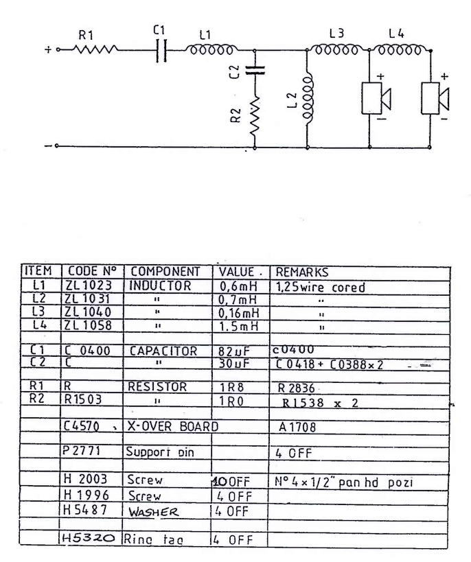

If the sensitivity of the mids is actually above 93 dB
If the specs account for peaks or trying for best published
numbers. Which is likely.
It would be minimal to no padding needed for the tweeters
Luckily the documentation is good from the pdf posted in post #91
The mids are already padded very slightly. So the factory crossover
is already padded and has component locations to fine tune any padding
needed.
Look as if one mid is crossed lower , which is good for vertical.
It could be somewhat not as painful to fix the high Q on the high pass.
and change the lowpass to blend with, new tweeter added.
Least it is not a complete shot in the dark, no reverse engineering is needed
the documentation is good.

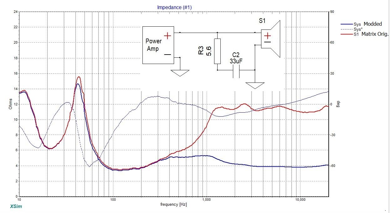

This modification should reduce the tweeter level some 2dB assuming amplifier output impedance in the range of 2 ohms,
even more the greater the OI.
