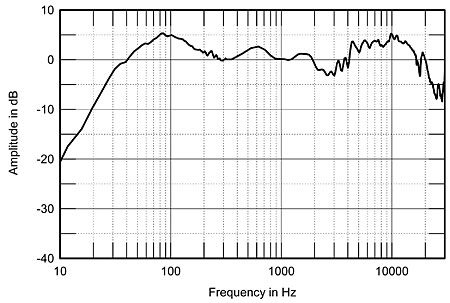

I just seen that ! This tweeter should be really padded down, it is obvios why the poster is hearing sibilance or fatigue :
I'd pad down all the >4K hz to the 0 dB line. And perhaps the 600/700 hz can cause fatigue too, though it is only 2.5 K hz peak. (or the 300 hz deep due to the front wall/speaker placement).
I'd first try after measurement according the result if similar : the serie R attenuation with perhaps the according shunt value or a serie notch centred to 10 K hz and large enough to reduce the >5K hz on the zero line.
I am not at STereophile of course but this is odd they noted it excelent, I have seen better loudspeakers on measurement that was not liked by them like the Boston Lynnfield 500L which indeed in its forst iteration needed a sligth better treble attenuation.
Guys who build speakers change these things (x-overs ), all the time. It's not unusual to have an unintentional peak, or dip somewhere in the response. There is no exact perfect speaker response. What sounds balanced to me may not be to your liking. I had a friend tell me one of my recent speakers sounded harsh. I don't think so. Years ago, I had another speaker. A different friend was ecstatic about how it played violins. I changed the x-over, like I always do, and thought it was the same or better. He said I ruined it. He actually got mad at me. I'm not into violin music at all.

But, I think the above frequency response (posted by Seterophoile magazine)
explains what I have been hearing.
I think it is somewhat necessary to tame down high frequency (say 7kHz and up)
and slightly boost up 1~3kHz. I am not sure but I feel that those 1~3kHz range
is related to the reason why I feel the violin sounds are somewhat unnatural.
Earlier yesterday, I said that I am unsure whether I can increase 2~3kzhz and
decrease higher frequency (say 7kHz and up). If I can do that, I might be able
to solve the problem.
In any case, I will keep experimenting, this time with crossover or tweeters too.

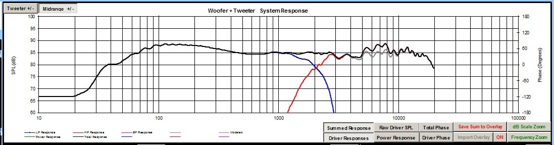

I would add a notch like one added on this sim to produce the flatter gray line response. That's where I would start. This only takes a small coil, cap, and resistor, and the filter can be fine tuned. It's not all, or nothing.So you meant new 3R3 value + the cap across will not raise the 10K Hz plus but just decrease what is below 10 K Hz ?

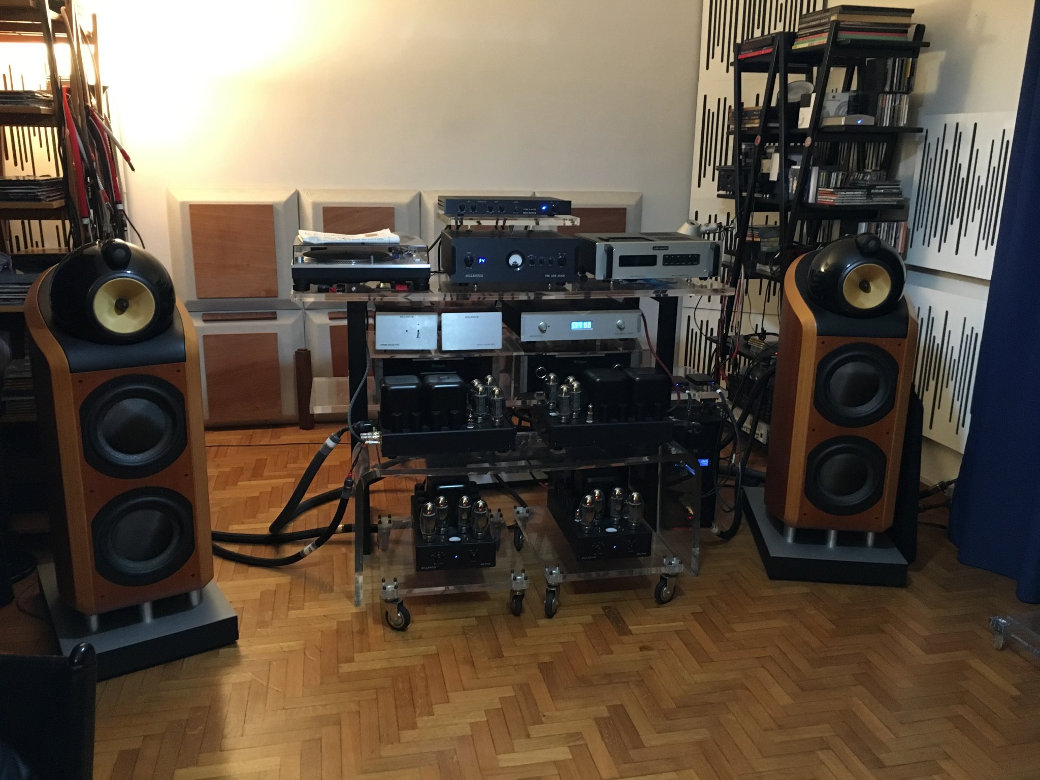

I have two friend with 800D, two versions.First of all, the amps are dual mono parallel single ended triode.
Plus other with 802D
With amps done by me.
It is not a simply speaker but with great performances
One photo of an old configuration ( my friend pass away few years ago)
nr. 4 mono amp 4 x KT150 + tube crossover.
The reservoir of power , in my opinion, is mandatory for this speaker

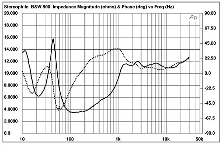

This "feature" has kept many boutique audiophile stores in business as the sound of this speaker ( and others with impedance curves like it ) is manipulated by connecting amplifiers with different output impedance values and thin vs. thick speaker cables. The effect being much like turning the loudness control up when using high output impedance amplifier, as the bass at 45 Hz and treble above 1 kHz will be accentuated. Speakers with a flat impedance vs. frequency do not exhibit this behavior.
Fig.1 B&W Matrix 800, electrical impedance (solid) and phase (dashed). (2 ohms/vertical div.)
One detail that you mentioned is very interesting: The use of single-ended valve amplifiers !
I guess this speaker was not developed with this kind of amp in mind. You could easily have some serious response deviation with this kind of high-output impedance amps. Are you able to measure the frequency response at the output of your amps (with the speakers connected of course) ? If there is an irregularity in the amplitude response then there is time for an impedance correction.
This impedance correction would be connected in parallel with the speakers.
Regards
Charles
Dear Charles,
Yes, I am using parallel single-ended triode amp.
Unfortunately, I don't have a device to measure the
frequency response of the amplifier alone.
I can't actually yet understand what you explained to me.
The output transformer is Tango X-10s, which has rated output
impedance of 10kOhms. Since I am using two 211s per channel,
the effective output impedance is 5kOhms. So I connect the
speakers at 8Ohm terminal of the output transformer. This is
all I did for impedance matching. I am not sure but I guess you
are explaining that I have to do something beyond this for
correct impedance matching.
I will try to study further about your comments.
That's doable. If you were to increase the tweeter cap values about 15%, and change the padding resistor to a larger one, that would probably do it. You would need to measure, but that's probably about what it would take to do it.Dear diyiggy,
The speakers are connected to 4Ohm outputs at the amps.
As I explained above, the output transformer is Tango X-10s,
which is rated as 10kOhms transformer.
I found people generally employ the load line of 10 ~ 16kOhms
for 211 tubes. Since the amp uses two 211 tubes, the output
transformer must be rated to be 5-6kOhms. The designer of
the amplifier took 5kohm load line.
Tango X-10s has output terminals at 4, 8, 16Ohms. Since equivalent
load is 5kohms, the equivalent speaker terminal outputs are
2, 4, 8Ohms. I connected the speakers at 4Ohm terminals.
