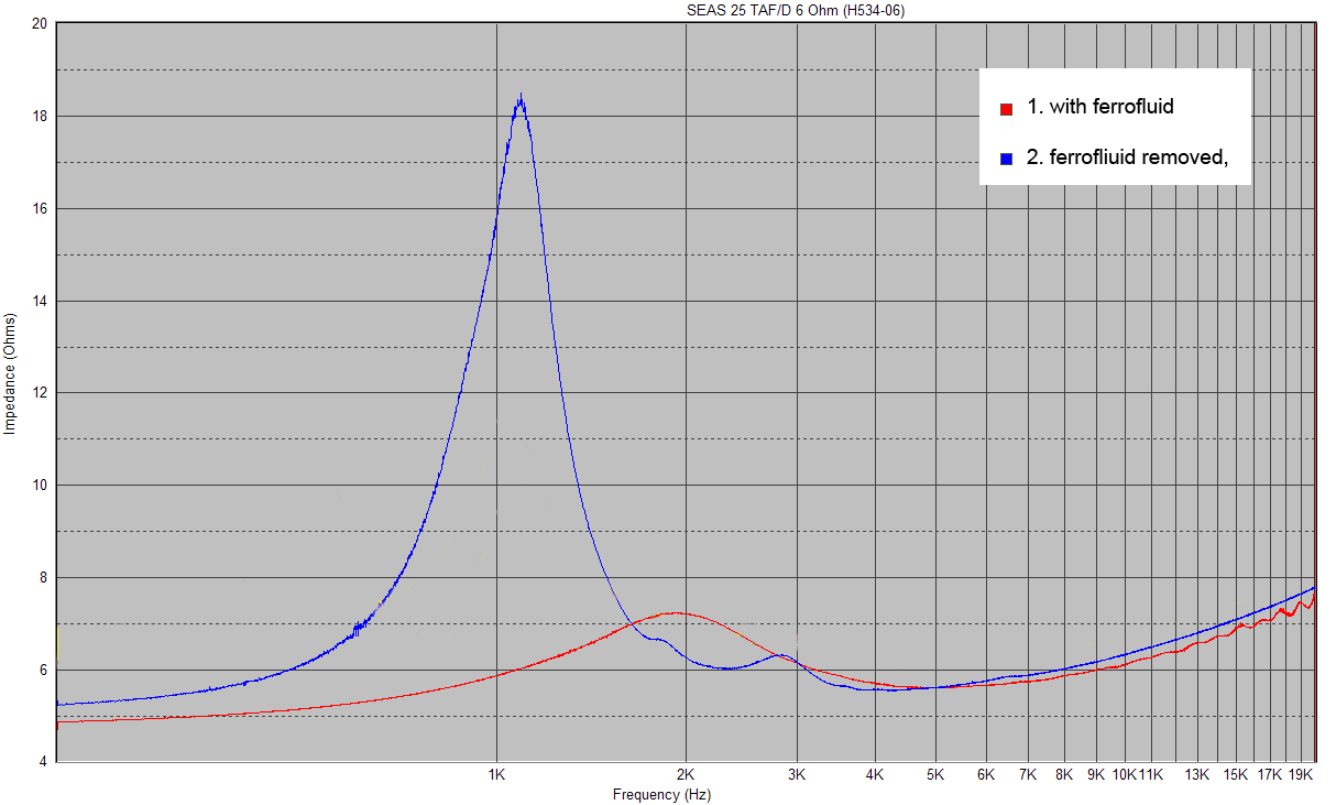

I don't know what it is about the DT94 that allows for such a mild impedance peak, but I wish more tweeters were like it. I don't think it's the ferrofluid doing most of the damping because Qes is 0.66 and Qts is 0.54.
mild impedance peak is definitely because of ferrofluid. have a look at my attached measurements of a tweeter before and after removal of ferrofluid.
I guess it can vary depending on the suspension. I've never seen such an extreme example as yours. My mental point of reference previously is the wavecor tweeters which come in ferrofluid/non ferrofluid versions , their peaks are reduced 20% or so with the ferrofluid

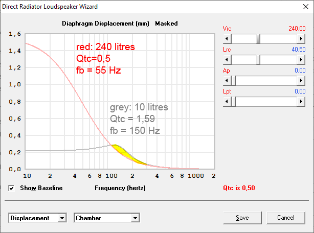

Stv, it'd be interesting to see how harmonic distortion is affected by q. The easiest experiment would be a woofer being put into progressively smaller enclosures. Higher q's must increase 2nd harmonic distortion at least. Maybe this is why a lot of tweeters have increased harmonic distortion around resonance: the increased amplitude comes from somewhere - counter force being applied to the diaphragm?
i'm not aware of Q as such affecting distortion.
distortion is mainly caused by motor and suspension non-linearity, which you will probably experience when driving the tweeter at or below resonance frequency.
but, as I said: harmonics can sound good, so it may be perfectly ok for you.
regarding your proposed experiment: a smaller enclosure will even reduce distortion by reducing the voice coil excursion (distorsion measured as absolute amount, relative may be different for some frequencies, as a small enclosure will reduce low frequency output). spring force of compressed or expanded air is quite linear compared to a voice coil leaving the magnet field or a surrond being driven to the limit.
yes, the ferrofluid in the tweeter i measured was old and slightly dried-out, so this example is definitely extreme ...
The reduction of excursion with smaller boxes is only partially true - for frequencies below resonance, say an octave or so, it's true: a smaller box will reduce excursion. But not frequencies at or slightly above resonance.
With bass it's usually the lower frequencies at about 50hz which cause problems for 5-6 inch drivers with say a 70hz resonance. The woofer in a smaller enclosure with a higher q when given a higher frequency at around or slightly above resonance, would have a higher excursion at lower power - ~100hz in this example. It would also have lower excursion at 50hz.
Think about it this way, the increased amplitude at or above resonance from an increased q can only come from increased excursion in a sealed design (no port interaction amplifying anything). 100hz doesn't usually give problems for any woofer as there's usually less energy there and even if it was the same, excursion for it is just 1/4 of what's required for 50hz. But we are talking about a 0.8" tweeter
Since we're talking crossing tweeters low, mid band energy isn't like bass and the analogy isn't applied quite as easily, but think about it though.
Anyway, I'm not thinking harmonic distortion from increased excursion around resonance, just from the driver being undamped.
You say the acoustic suspension is quite linear, so maybe it's be third harmonic distortion that's higher with a higher q (2nd harmonic one way (in), 3rd the other way (out)).
Horribly organized but I'm on my phone. I think it's clear what I'm getting at
you are right. it's not very much, though. see my simulation for a woofer in a 10 liter and a 240 liter closed box with Qtc 1,59 and 0,5 respectively. the yellow area is where the smaller box leads to higher excursion.

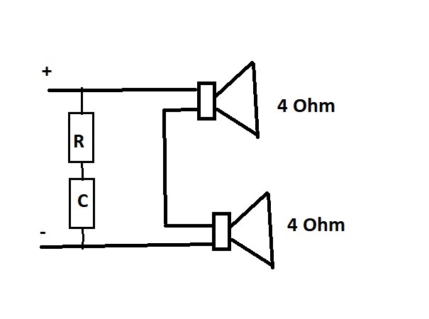

I have got one question now.
If I had two midranges (4 Ohms) connected in series, how I would count this Zobel network?
Is it OK like this?
Re total = Re1+ Re2
Le total = Le1+Le2
C = Do I have to cut the value of the capacitor in half?
Thank you.
J.
