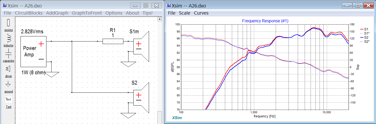

I tested with pink noise at a level just below peaks for 30 minutes, temperature of the dome didn't even rise 1 degree Celsius. Also, no audible distortion. Xmax is .25mm, 0.5 p-p. Tweeter will be fine. And should sound fine being critically damped. I stated this wasn't an issue in the original post.
Edit: if you look at the frequency response of the tweeter (or just consider q is 0.5 and fs is 1900hz) excessive excursion is prevented by itself, leaving heat the only issue. With the cap on the tweeter filtering from 1300hz, the tweeter gets 1/4 power at 650hz, 1/16 power at 325hz, 1/64 the power at 162.5hz, and 1/256 the power at 80hz. Since the woofer is just 40wRMS, you can see that heat won't be an issue for the tweeter
To clarify Stanislav, I'm not concerned the effect the resistor has on the q of the filter (capacitor), I'm concerned the effect it has on the q of the driver. At 1300hz, the driver is already down 5 or 6db, so if the slope from there is slightly off, the effect is minimal and quickly becomes completely inconsequential. The capacitor is actually detrimentally affecting the phase of the last half of the octave of the driver's natural roll off I'm using as the crossover point. No big deal to me if it's slope changes a bit. I'm aware there will be a bit less energy between ~850 and 1300hz, probably somewhere around a decibel between 1050 and 1300hz - I'm not worried. Much worse would be a problem in the first 6db
The Q of the tweet will change because of the series cap. You'll have a huge peak at Fs and instead of reduction of output the excursion will go through the roof. You'll have to either apply an LRC across the driver to tame that peak, or increase the XO frequency. I would employ a Series XO and still at least double the cut-off point.

There is virtually no impedance change at resonance. Also, the cap is well below resonance. As mentioned in OP
I chose this tweeter specifically to use its natural rolloff as the crossover point. I didn't expect to need to attenuate it, as its sensitivity matches the woofer (chosen for this as well). My question was about series resistance changing the tweeter's Q. Anyway, moving the crossover point up to 4khz disables perfect horizontal dispersion to 70 degrees through the critical 2-3khz range (yes this is a requirement because of position). Especially not happening with the woofers low resistance air core inductors and film caps for 1700hz already being installed.

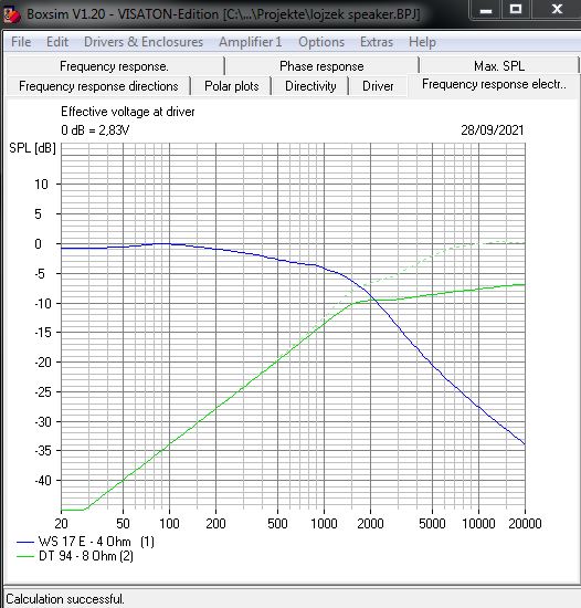

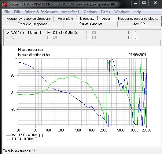

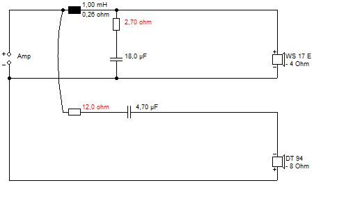

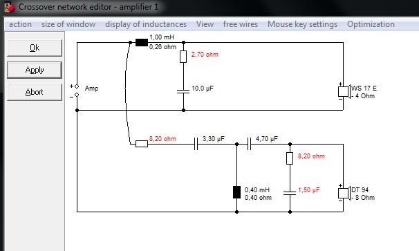

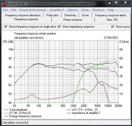

I have taken the trouble of simming something resembling your speaker for you, in visaton boxsim, applying "the standard model" of loudspeakering. 😀
I don't know what your speaker sounds like with the unspecified first order capacitor tweeter crossover and unspecified bass filter, so it's all a shot in the dark. I certainly don't think much of your idea without considerably well-behaved drivers, which yours probably aren't! My efforts with single capacitor and 6" were plain hopeless. Nothing worked right. 😱
All turns out quite conventional. I show the effect of the 8.2R/1.5uF Zobel in taming the DT94. How it sounds only time will tell. Some of the values marked in red might be adjust to taste. I did it 16L closed box. 23cm wide baffle. Hope it helps.
Thanks for the effort. It sounds good with a top end that's a little bright. The filter on the woofer is 2nd order 1700hz to match the tweeter's natural roll off, 2nd order 1700hz q 0.54 (previously mentioned). The capacitor is not for crossover, it's half an octave below the natural rolloff (crossover point) for the purpose of blocking LF energy only (preventing the heating of the tweeter's voice coil). The tweeter's impedance only rises ~10% at resonance.
The woofer is very well behaved, flat 1.5 octaves past xover and perfectly wide dispersion to 80 degrees up to 1700hz (required for speaker position in room). I might add a circuit to flatten impedance to improve phase as well, but that's not my question.
My question is, if I add an ohm or two between the tweeter and amplifier, what would it's q change to? There's more relevant information in the original post and through the thread, I've said what I posted here many times over already. Please read, I'd appreciate your help

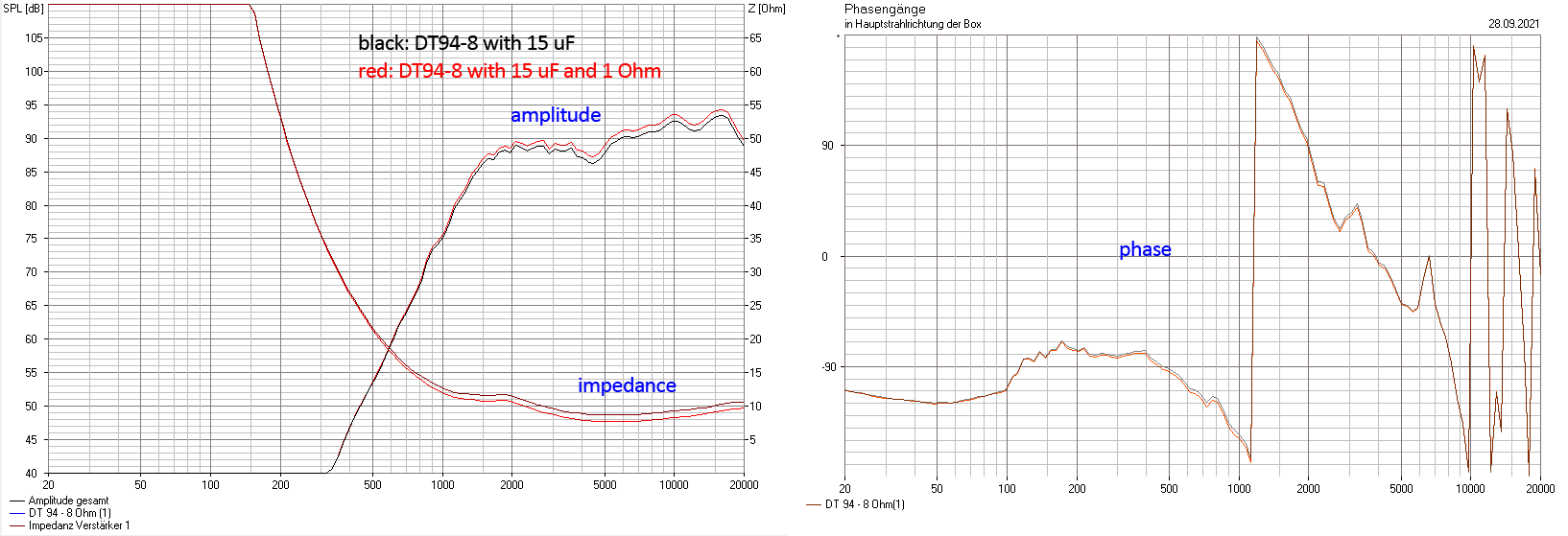

when measuring tweeters i noticed that they have significantly higher harmonic distortion around and below the resonance frequency. dome tweeters only have a single simple suspension (no spider, only surround) and thus tend to wobble at lower frequencies. harmonic distortion can actually sound good, so maybe you are ok with that.
i suppose your cap has about 15 uF, this will limit the max power to the tweeter to about 20 watts at 1,5 kHz (limit by max excursion).
attached you find the (simulated) change if you insert a 1 ohm series resistor to the 15 uF cap somewhere in the tweeter connection.
the simulation was done in visaton's boxsim-software, assuming an arbitrary baffle, so exact freqency response will be different in your case.
- phase change is barely visible.
- impedance gets higher by ~ 1 ohm in passband area.
- amplitude is lowered by ~ 1,5 dB.
DT94 has a low Qts mainly because of ferrofluid dampening. this results in a low impedance peak at resonance frequency. as you can see the 1 ohm resistor does not change the peak at all, besides the general increase in impedance by 1 ohm - so no significant change in Q.

Thank you system7 and stv. It seems the resistor should be fine 🙂
system7, I can't offset the tweeter at all because the speaker is in wall - I replaced drivers in a pre existing enclosure). But I don't need to move it, the sound is good in the listening position, as well as most other places in the room. Because the listening position is about 50 degrees off centre, I'm thinking of leaving the brighter top end (no zobel) because at the listening position the top octave sounds fine, maybe even a little soft.
stv, glad to see the resistor doesn't affect the frequency response, very good news! It looks like the chart is labelled backwards though
