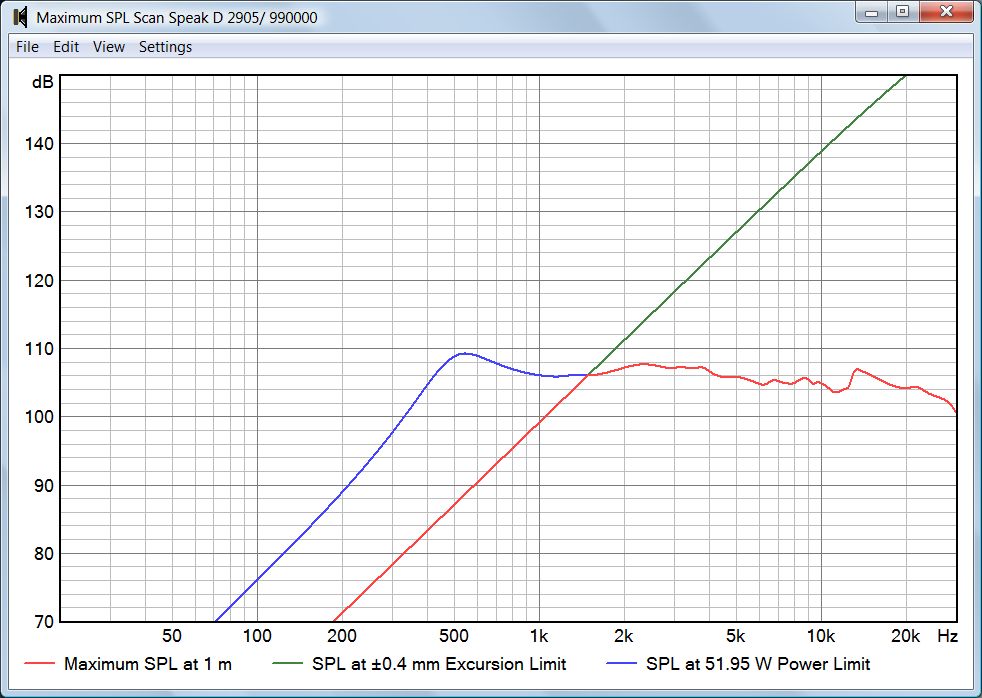

Tweeter excursion
Think of it this way- the energy coming into the coil gives it an acceleration, more voltage ramps it up, but at higher frequencies the direction of travel reverses sooner than at lower frequencies, hence less travel. With a thousand times more time, that pipe organ bass note moves the diaphragm a whole lot more in each direction than your 20k shimmer of a brush on a cymbal.
I used ernperkins link.
It's not that it is not fast enough, the principle would not change with an infinitely light diaphragm. It's spending less time moving forward, thus going less far. I'm afraid I should not have used accelerate instead of maybe impel or propel. Sorry.
simple physics approximation would use BL force product and moving mass to get accel/Ampere, pick a Amp limit from coil R and power spec
then x_ peak should be BL*A_pk / (vc_mass * w^2), w = radian frequency
wasted all the time before dinner looking for a units package in Python, numbers later
~ 0.0002" for the ScanSpeak Revelator 1" numbers? (+/- a spherical cow)
of course a soft dome doesn't move as a single mass @20 kHz, but we could pretend, or look for Accuton numbers

df = convert_to(3.5 * meter * tesla / (0.45 * gram) / (2 * pi * 20e3/second)**2, [meter, ampere])
df.evalf(2)
4.9e-7*meter/ampere
so the next question is how many continuous A @20 kHz if the 225 W spec was believable
convert_to(df * (2 * 225 * watt/4.7/ohm)**0.5, meter).evalf(2)
4.8e-6*meter**1.0
convert_to(df * (2 * 225 * watt/4.7/ohm)**0.5, inch).evalf(2)
0.00019*inch**1.0
Mmm, I don't quite get that, doesn't that imply the same thing, ie, it's not fast enough to realise the full peak to peak signal?
If the frequency response is flat the excursion will be the same at all frequencies. The baffle dimension is of little relevance at 20kHz
The higher the frequency, the less excursion for the same spl is needed. You will burn the coil long before you make it swing maximally.
I thought that for the same SPL the extension was inversely proportional to the frequency.
i.e. double the frequency results in half the excursion.
If that is true and the treble unit has 0.5mm Xmax for use at 2kHz, then @ 20kHz it would be using only 0.05mm of excursion for the same SPL.
This would fit with CalW's 0.05mm inspired guess.
