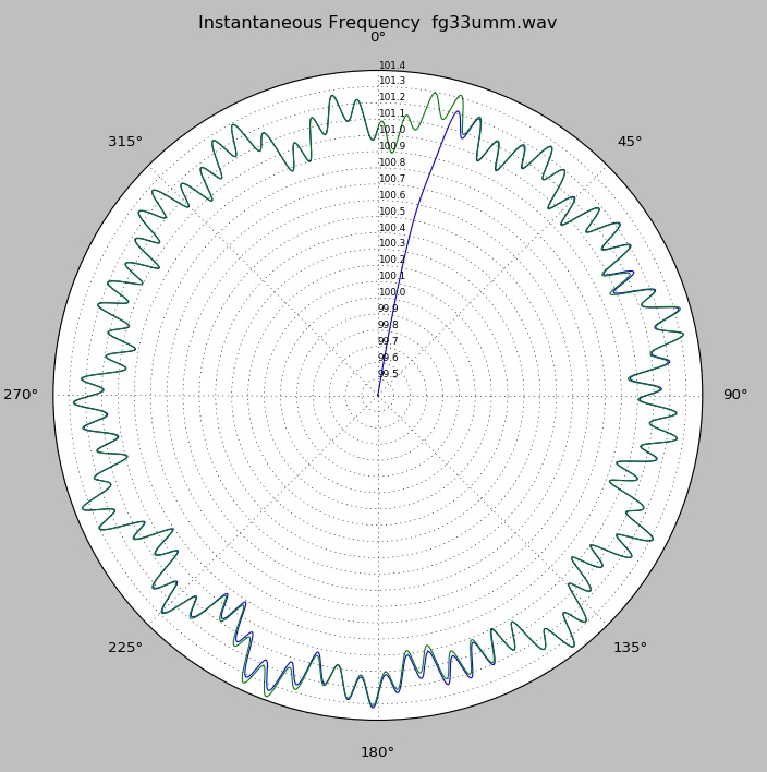

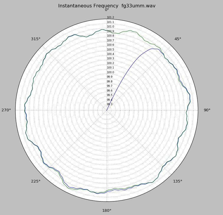

If I wanted to run the ~100Hz FG signal without manipulating it, is that possible? If I change the filter to 10Hz the plot looks too good to be true:

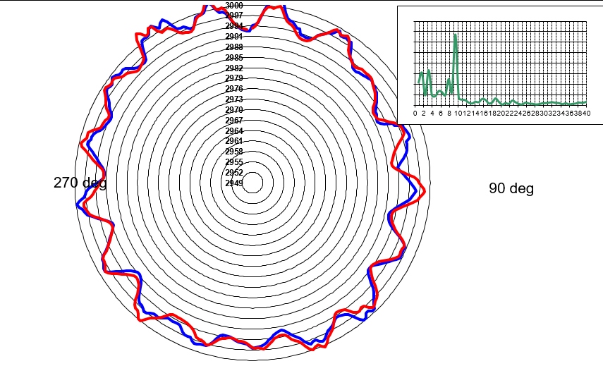

I increased the rez of the plot to .1Hz (I did fake the the maximum frequency since the code would have to be modified to not use only integer frequencies as the max). This is 10Hz and 20Hz filtering. The second seems like some 40Hz mains FM on the 100Hz?

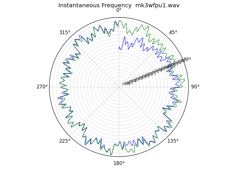

Last night I recorded the FG on one channel, and a WF track from a test record on the other. I think we can consider this line of experimentation fundamentally flawed; tapping in to the FG line is causing significant issues. This is the WF track from the same test record I've used for all the samples:

Interesting similarity to the second plot above, the percentages of carrier line up. The tiny font at least made the tick marks readable. I never could find that command except in an example code, no documentation at all. I found a polar plot example where they were moved and looked for the likely line of code.
Thanks - indeed a bug for carrier frequencies below 200Hz.........(!!) Doesn't affect previous polar plots, this was the first at such a low carrier f......... who'd have thought it ?Something is amiss here
Murphy's law: if it can go wrong it will..........
Here's a polar plot re-run of JP's 100Hz FG signal carrier raw data with that fixed, and looks conceptually plausible to me. Same essential shape and spectrum.......... so what does it mean, I'm pretty sure it's real ?

Thx - here's my edition of the polar plot for that file, starting at 10s.
Performance has, indeed, gone to the dogs through the act of measuring the FG signal, it seems.
Two spectral peaks in the WF file also seem to show up in the FG signal file, but by no means in the same ratio.............perhaps including the triangular like shape that isn't rotation synchronous...........
I agree, the FG monitoring method isn't good.

I'm almost certain the 40Hz wiggles are real in my plot, the sidebands showup in a standard FFT though they are too noisy to discern AM from FM. IMO they are from 100Hz/60Hz beat though I am somewhat at a loss as to the details of these data sets.
To understand it, I think one needs to know detail of the drive design intention. Which I don't, but I'm sure someone here might..........?
Here we're on a bit of a detour, examining the FG signal of a particular TT drive, which proves to be tricky to interpret - no surprise I suppose.
One feature is the triangular pattern in the FG polar plot that's not synchronous with rotation; another is a ~9Hz pattern which is synchronous.
If we were looking a polar plot of pitch variation, we might tag those markers and relate them to the mechanism. That's how diagnostics and fixes can work using polar plots, IME.
However, this case at hand is a healthy TT by standards. At least until the FG probe was introduced So really we're exploring how the TT drive works, and what (if any) residual artefacts of the drive might remain - which is ethereal stuff methinks.

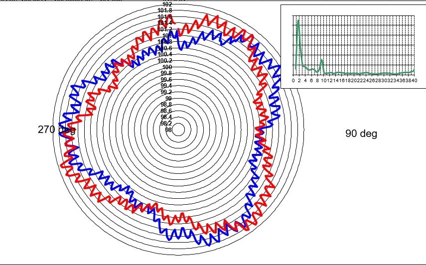

Hi Scott, would be great to see a plot of the FM spectrum, don't you think ?I increased the rez of the plot to .1Hz (I did fake the the maximum frequency since the code would have to be modified to not use only integer frequencies as the max). This is 10Hz and 20Hz filtering. The second seems like some 40Hz mains FM on the 100Hz?
All one has to do is a fourier transform of the display data as a time series, and calibrate the x axis according to the time spacing.......... the y axis would FT bin magnitudes, corresponding to display content spectrum.
I think this is pretty much essential to interpretation and diagnostics, one can't get far without needing to indentify the contributing factors in all but the most obvious cases.

Yes this is not hard especially since I can preserve the sample frequencies exactly through the arbitrary N FFT. I could plot it next to the polar plot as another figure on the same canvas.
