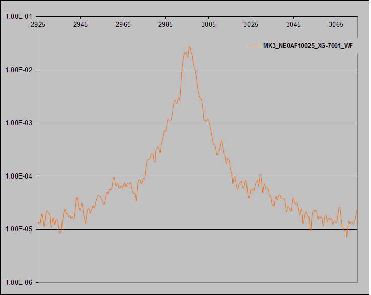

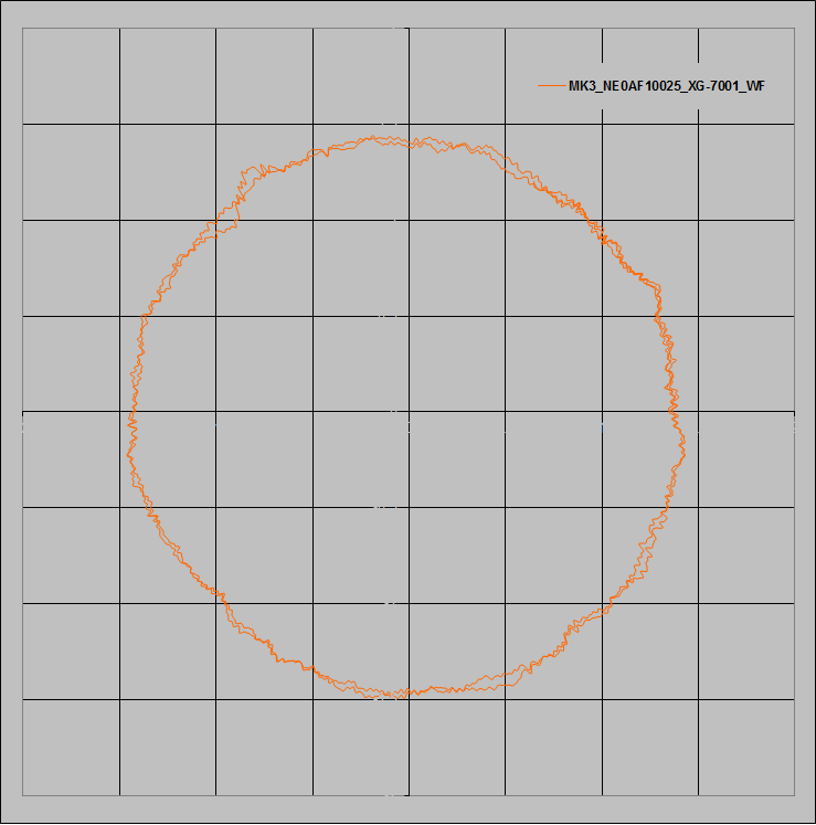

Hope no one minds but I processed the above sound file using the software I was given by the guy who used it on the Pink Fish Media Thread – see http://http://www.pinkfishmedia.net/forum/showthread.php?t=70027.

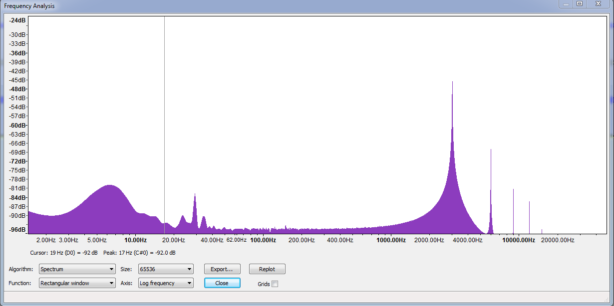

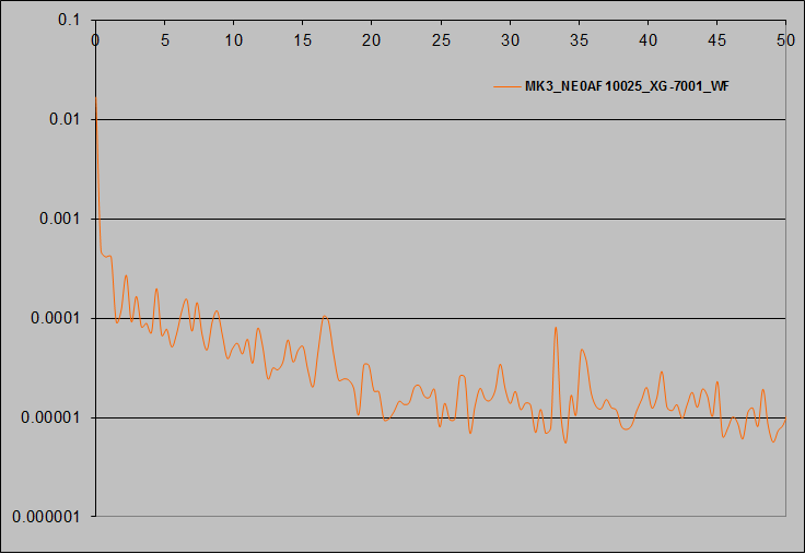

The polar plot does not give absolute values but as the software exaggerates any errors, such are readily apparent. The two FFT plots are, with respect to frequency, absolute values. The FFT Demodulated one was of particular use in sorting my Lenco out. I have also added an Audacity FFT plot of the sound file.
From my experience the results are very good and it would be hard to better. Only things to note are that the TT is running slightly slow (nominally 2996Hz (-.13%)), there is a slight peak at 16.5 Hz (which is apparent on LD’s FFT plot as well) and the Test LP is very slightly off centre (not a TT failing!!). It would be good to see a PlatterSpeed app result for this TT.

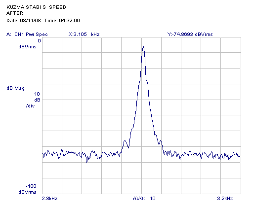

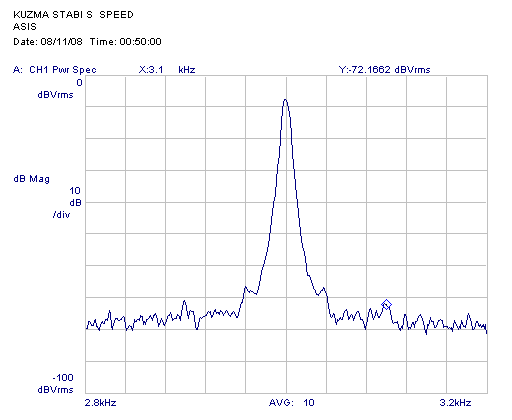

Late again, but that spectrum plot looks very close to the actually measured spectrum on my Kuzma. The plot with the mains sidebands is ex-factory, for the cleaner plot we tuned the AC motor phase shift capacitor. Worth.
Jan
